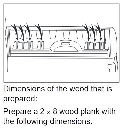

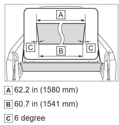

    2x8... cheap AF. Page 432 in the owners manual
