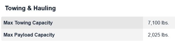

    Trucks payload is about 2k. The campers are vary in weight, with the bel air being the lightest at >500 lbs.
    I was thinking FWC could be a good choice, but their ‘wet weight’ is basically 2000lbs.

    I need to double check my actual truck, but the internet said my 05’ RCLB V8 was under 2k payload.

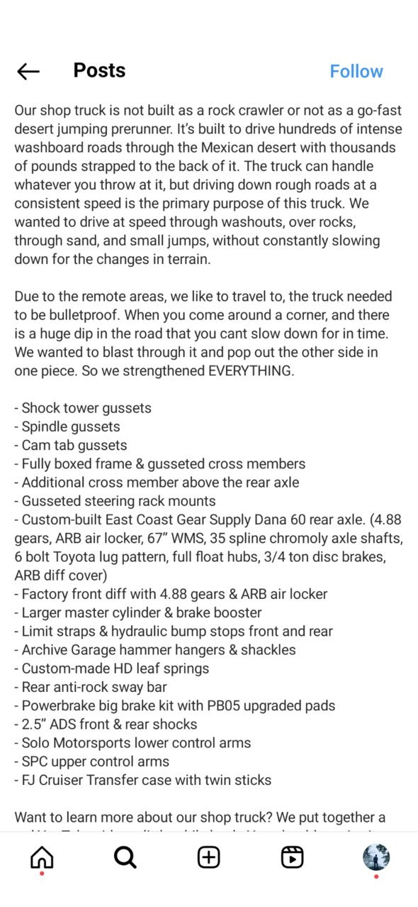

    Here is what Basil's Garage did to their severely overweight 1st Gen Tundra. You can find more on the Instagram page or YouTube.
    Nick244[OP] and Terndrerrr like this.

    I love those 'Stralian style flatbeds. Looking forward to building something similar.
    The suspension gussets (shock tower, spindle, cam tab, crossmembers) and boxing the frame and are low hanging fruit if you can weld . I'm considering some of that stuff.
    I found a quarter sized defect in my frame last week on the passenger side in the partially boxed area behind the front wheel. The gaping hole pointed at the rear tire is a pretty poor design choice unless their goal was to collect mud and water o_O I'll be doing a little repair work in that area at the very least.

    I'm a big fan of Basil's Garage. I've been meaning to reach out to them with questions on suggestions, but I'm assuming I'll just be wasting their time due to the costs they'll ask for labor. It's a really cool garage that does amazing builds, but I've never seen a beater car they've worked on.

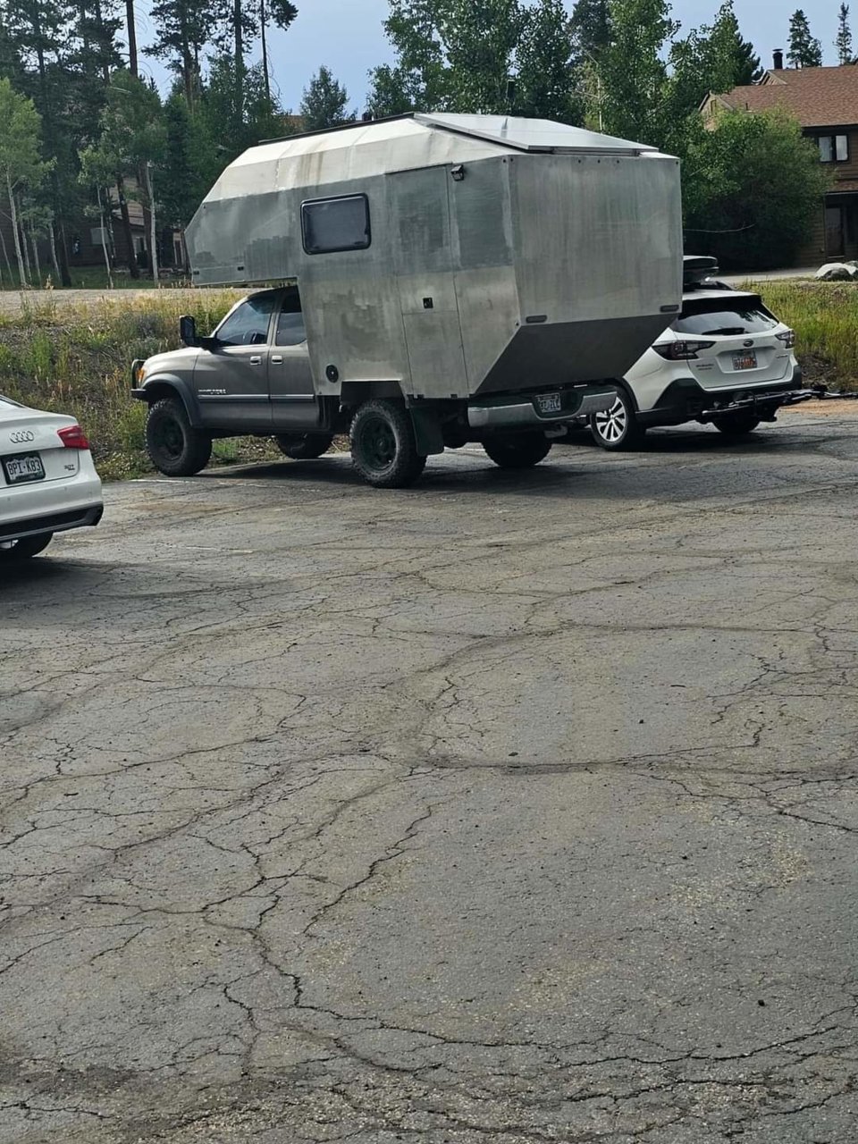

    Here some inspiration for you Nick.

    Damn, isn't that a tad topheavy?!

    If you rollover, it just rolls alllll the way over back into its wheels.

    This would look great with a working inboard propeller sticking out the back. o_O
