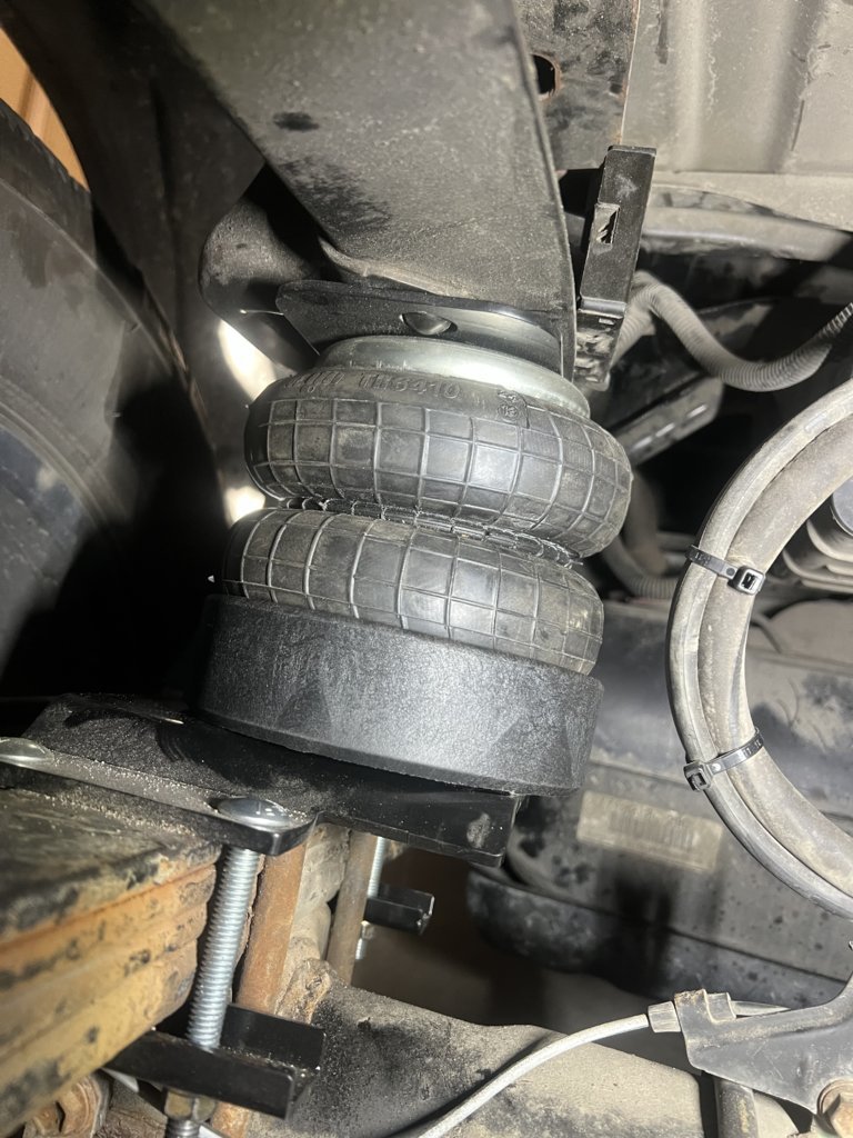

  16. Nov 15, 2024 at 3:11 PM

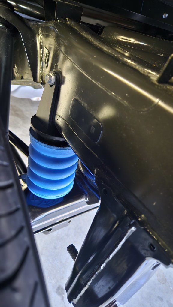

    20241008_152610.jpg 20241008_152647.jpg I have a WDH, and installed Sumo springs just for a little extra help when needed.

    Torque air bags with cradles. Very reasonably priced

    2016 Tundra OR
