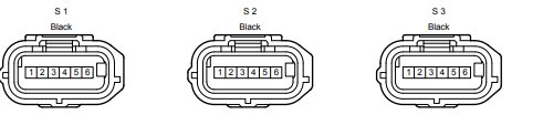

  7. Apr 27, 2024 at 11:07 AM
    1lowlife
    1lowlife New Member
    May 4, 2016
    #3296
    11,251
    DADA
    THE GREAT STATE OF TEXAS
    2014 MGM DC SR5

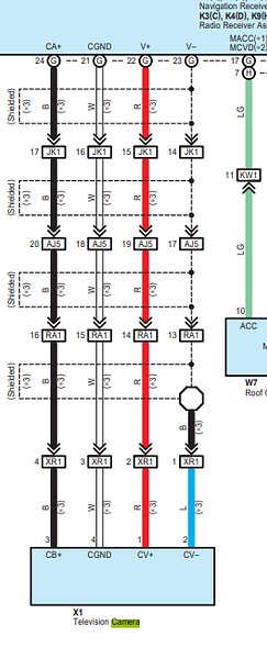

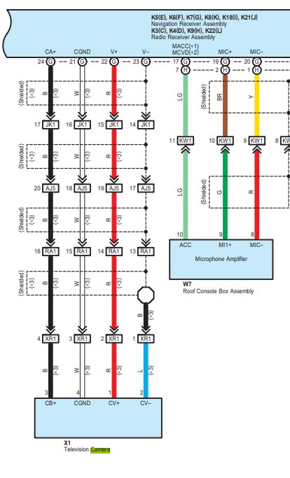

    This is the circuit for the camera from the tailgate to the HU.
    You could pull the inside panel off your tailgate and see if the X1 connector is in there.
    As well if it was, you'd see the wiring at the bottom of the tailgate going under the bed.
    That white one might be it..
    But I can't see the wire colors in your pic.
    X1 would connect to the camera in the tailgate.
    XR1 would be where it connects under the bed close to the tailgate.
    Deaner and Wynnded like this.
