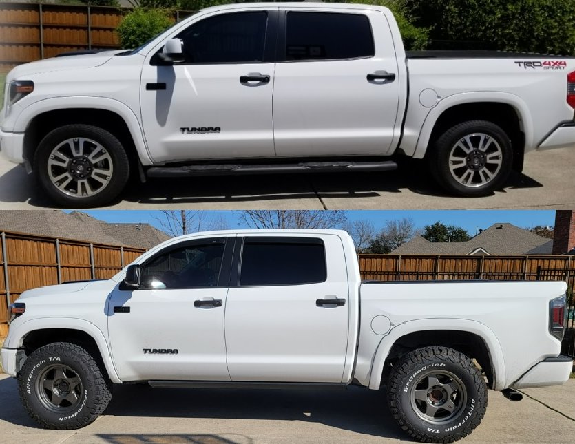

    Same here. I have the Falcon Sport Tow/Haul Shocks set at level, stock UCAs and SCS F5 wheels with 35/12.5s. Removed mud flaps, added bumper shims and pushed fender liners forward.

  10. Mar 17, 2023 at 10:50 AM
    eRockAZ
    eRockAZ Toyota Tundra Enthusiast
    Feb 10, 2019
    #25892
    44
    Mesa Arizona
    2018 White CM Sport
    Looks good!
    I've got this yearning to bump up to 37s... that'll require some more modding... which'll require more effort and $$... not yet sure if it's worth it :D
