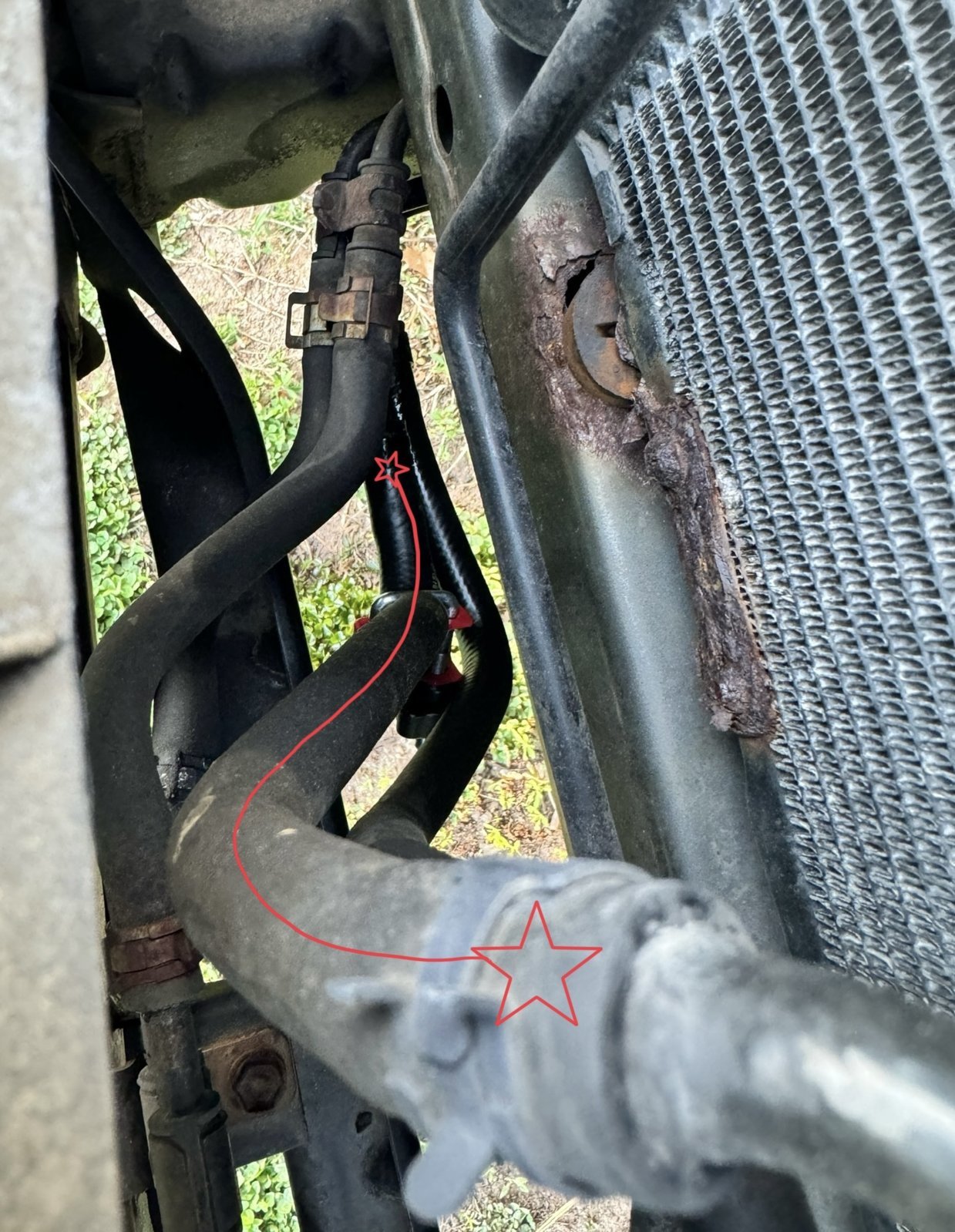

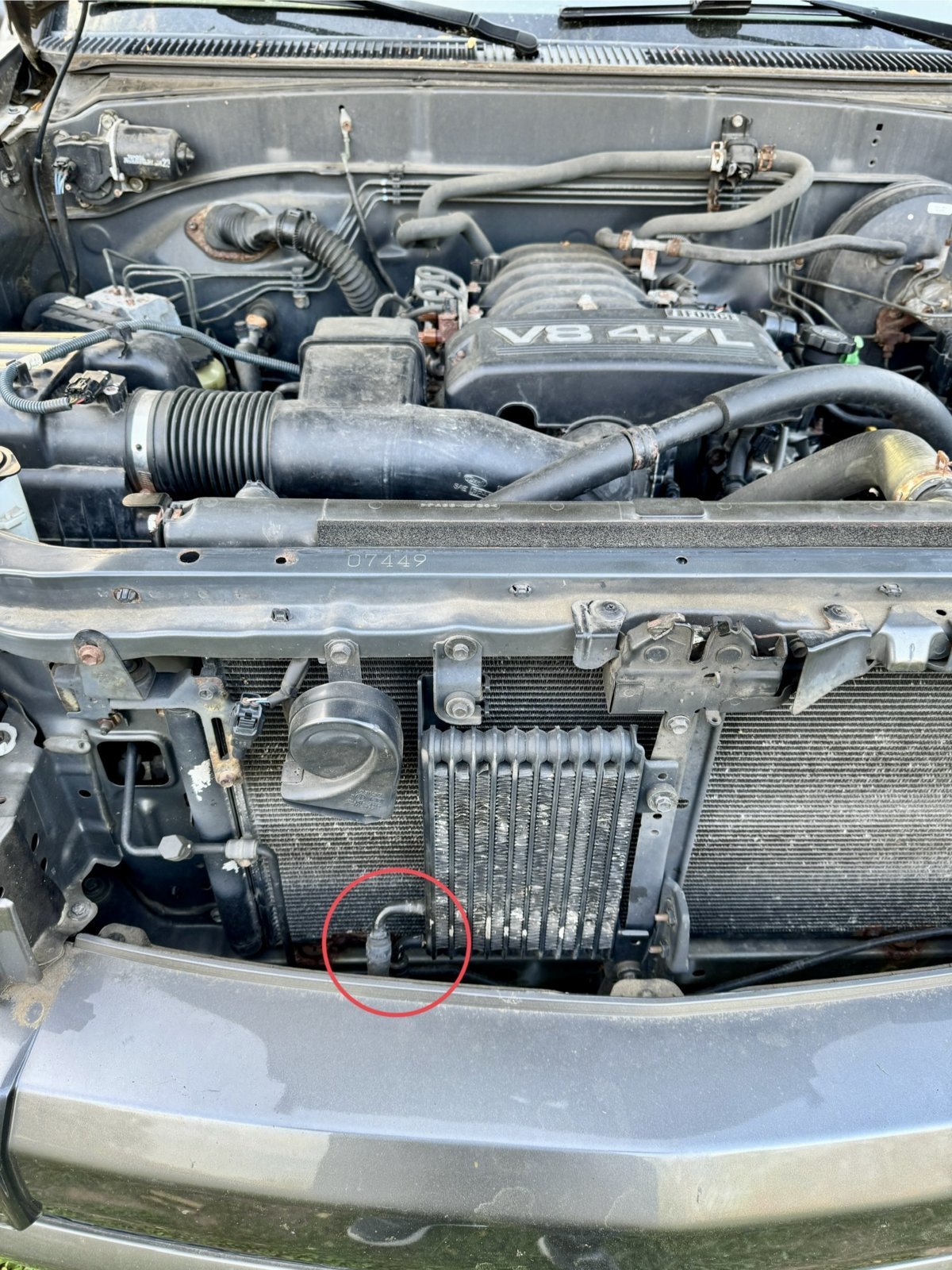

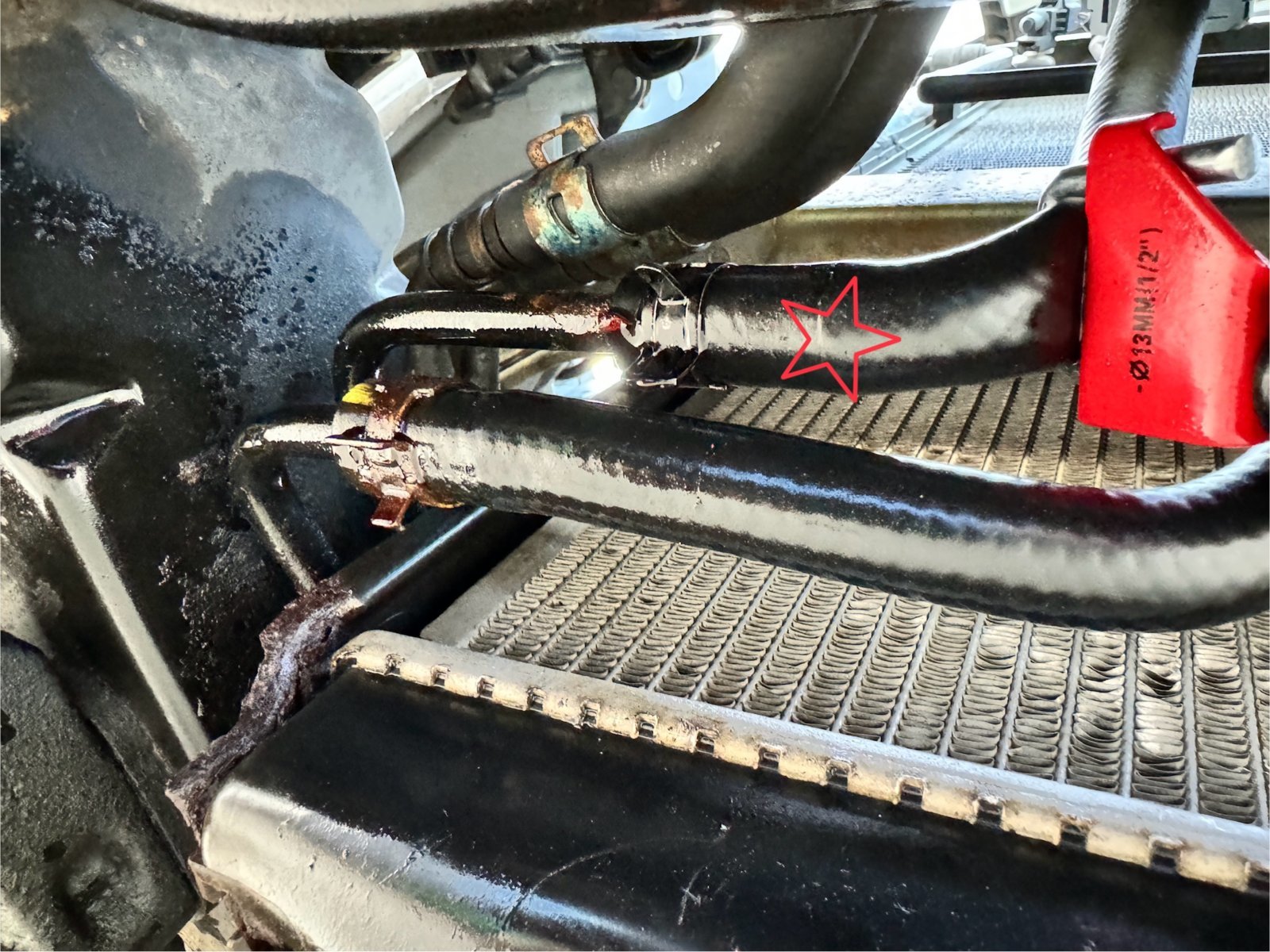

    I have sprung a hose leak. It's red transmission-like fluid if that helps. My first thought was an HVAC hose, but I couldn't find a good or convincing diagram to help diagnose and buy a replacement. What hose is this?
    Thanks!!
    Jon

    Auxiliary transmission cooler hose.

    Transmission cooler. Some new 3/8 hose will fix you up. Fuel line works well

    What is, transmission oil cooler hose, for $1000 Alex

    I'd leave it. That chassis crossmember looks like it could use some self lubrication and rust inhibitor.:notsure:
    But seriously, looks like a new section of hose AND clamps will get it fixed.

    Agreed. There are a few spots that could use some love. I inherited this truck from my son, so I'm just learning the nuances of Gen1 Tundras thanks to this forum!
