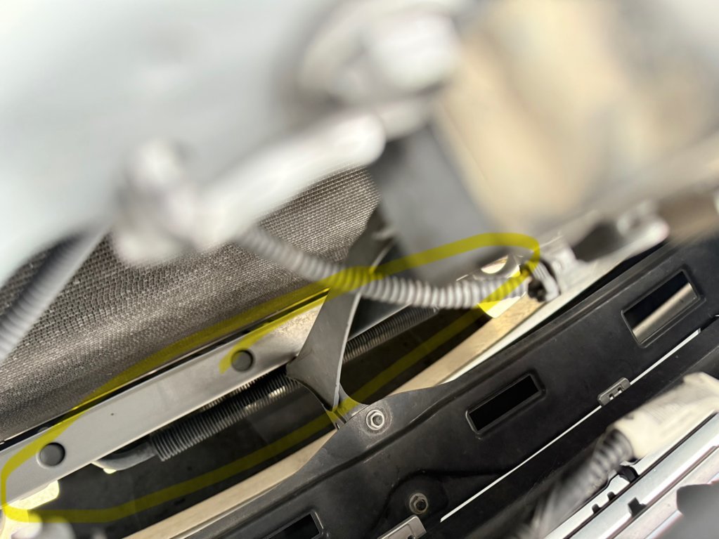

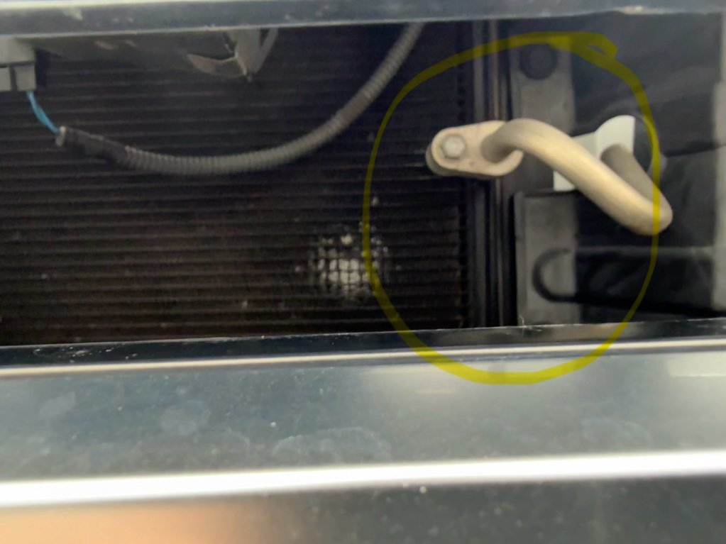

    Hello all,
    Late to the game, I recognize this has been spoken about a lot. Trying to get factual information.
    I have a 2019 Tundra crewmax, with tow package, limited, 5.7 L v8.
    I see two layers to the front intercooler and lines, is this a form of a intercooler transmission cooler?
    What am I looking at here?
    I plan to tow a lot, thank you for your time!

    1. Engine radiator
    2. A/c condenser
    3. Your truck is not turbocharged, you do not have an intercooler.

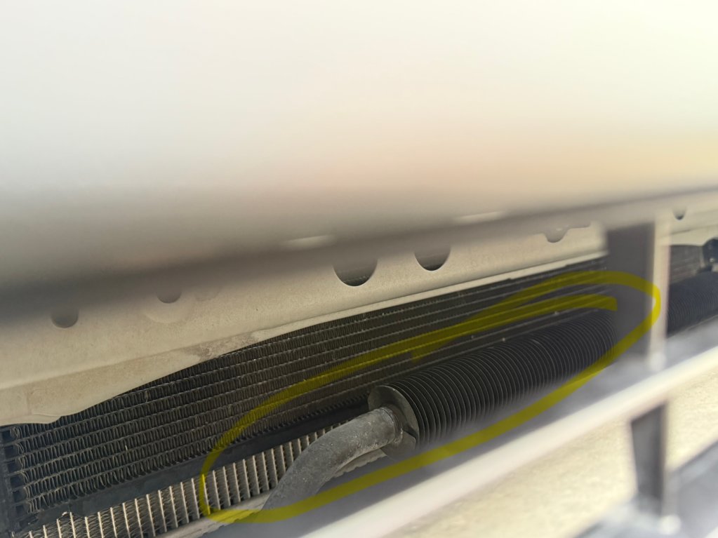

    So if I’m tracing the lines correctly, the transmission lines seem to line up with the engine radiator, meaning they are integrated now?

    Last two pics are the power steering fluid cooler.

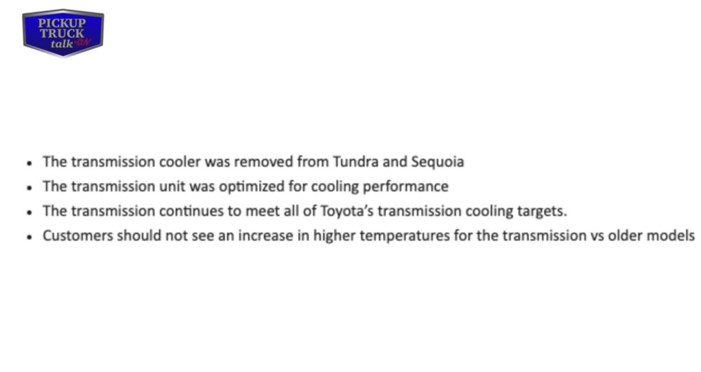

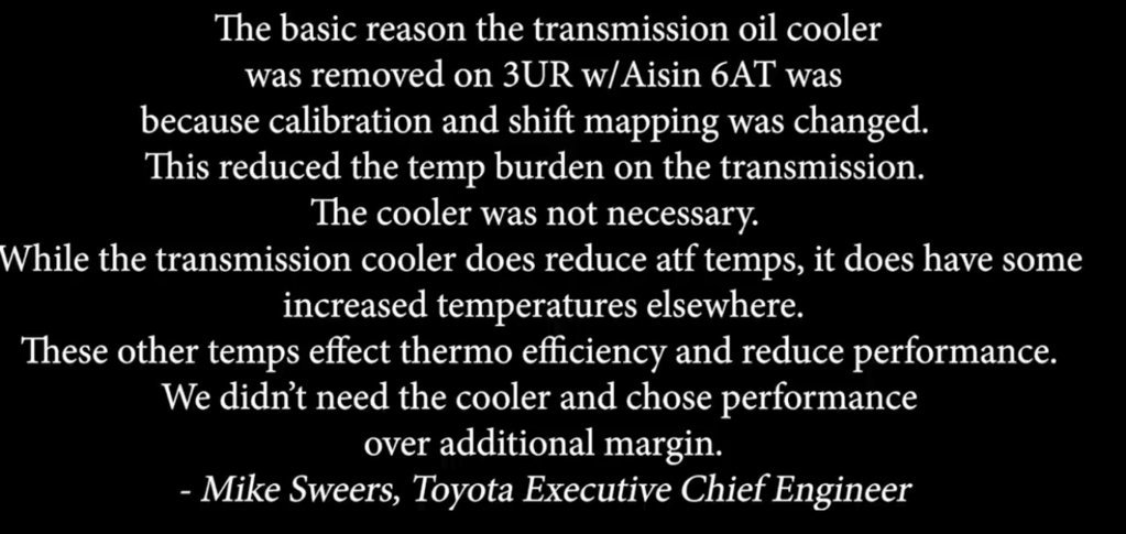

    After some research, seems like they tied it into the radiator and is a fluid to fluid cooler and warmer. I guess in 2019 they changed the shift points for the transmission to help it operate cooler.
    per Toyota mechanic spoke with, if less then a 280 degrees, they are happy. Which is insane in my opinion.
    the fluid they use now can handle up to that temp and the metals they used for transmission I guess changed some. All super weird. By changing the shift points it helped reduce heat in other areas of truck although I can’t find anything on it.

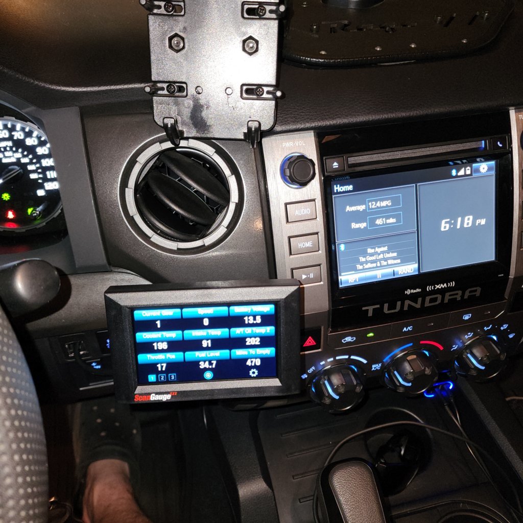

    I may track mine and see what the values are.
    Anyone know if a OBD scan II can do this?
  8. Mar 11, 2025 at 3:42 PM
    Tunrod
    Tunrod New Member
    Jun 11, 2024
    #118267
    534
    Rod
    2021 SR5 CM 4x4
    yes
  9. Mar 11, 2025 at 3:46 PM

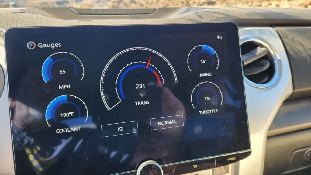

    What is the name of that little gauge?

    What typical temps do you see in a daily average?
  12. Mar 11, 2025 at 4:04 PM
    Tunrod
    Tunrod New Member
    Jun 11, 2024
    #118267
    534
    Rod
    2021 SR5 CM 4x4

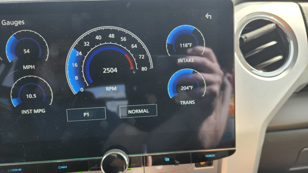

    Normally matched 193ish both TF1 and 2 straight and level while towing with a locked up torque convertor. I still see 230 TF2 at the top of our 8 mile uphill run from our campsite where TC won't lock up but pan temp is about 30-35 degrees cooler

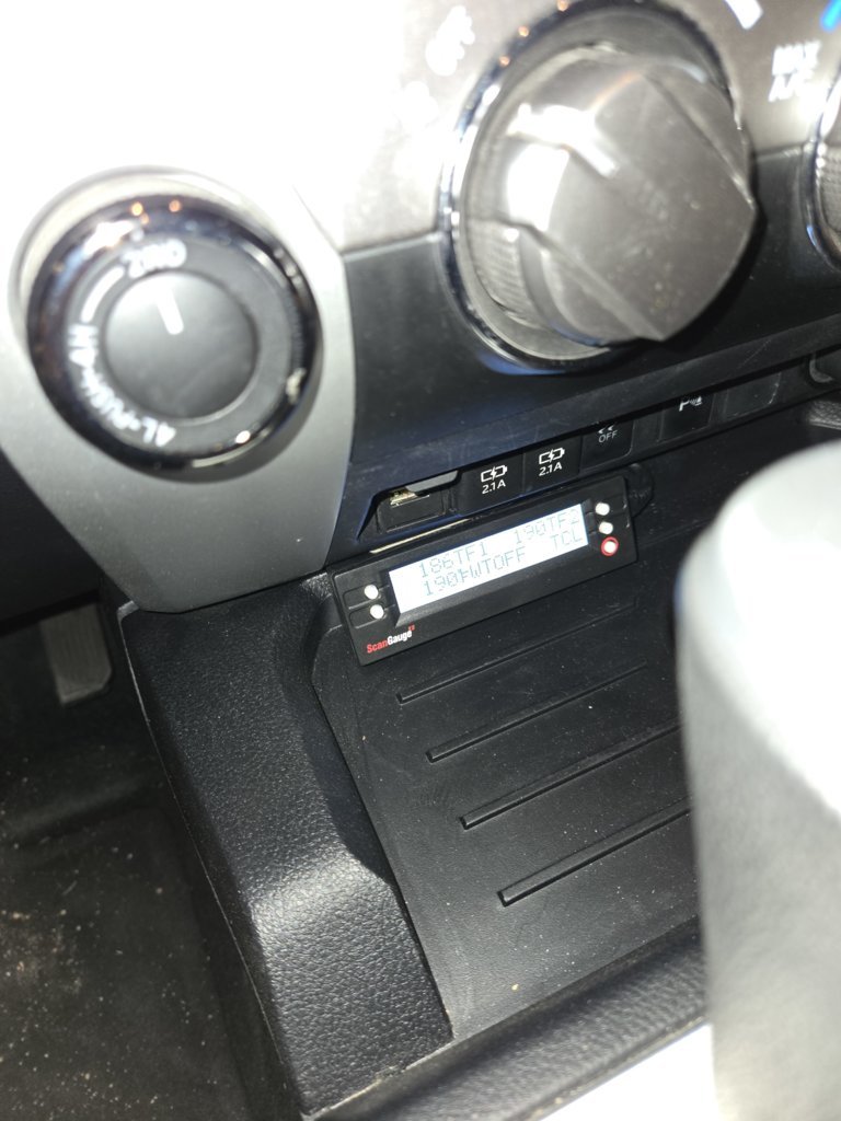

    Does this read pan temp or active in the line temp?
  14. Mar 11, 2025 at 4:19 PM
    Tunrod
    Tunrod New Member
    Jun 11, 2024
    #118267
    534
    Rod
    2021 SR5 CM 4x4
    Not sure ... I assume pan temp and torque convertor discharge temp. When TC locks up TF2 cools to pan temp rapidly.

    This is in line with what I'm seeing on my '19 with 5,500 lb. trailer behind me.
    On the flats through the desert she settles in @ 205-210º towing @ 62-65 MPH.
    Climbing grades it'll be in the 220-230º range, and I think the highest spike I've seen was 238º and that was pushing it hard up a particularly nasty grade coming up out of the desert on I-8 east at the Imperial County/San Diego County line.
    Two lanes, steep and curvy, and if you get stuck behind someone struggling in the right lane you're done. You're never gonna' get in the left lane again.
    The spikes cool off right away once cresting the climb.
    For now I can live with monitoring temps and doing drain and fills on severe duty intervals every 30K

    Here's a video (it's dry AF), but 12 minutes of watching this will give you an incredible amount of knowledg of how our transmissions work and why the OD gears in our trucks generate SO much heat. This will also explain why S4 ideal for towing, and also a bit about the quality and durability of these transmissions.
    https://youtu.be/YM40HOYtLNc
    From there you must decide if you trust that the high temps we are seeing in our 19-21s, from lack of having an external cooler, will not cause the fluid to degrade to the point where you'll experience pre-mature failure of your transmission. Personally, I don't believe that with those types of temps our transmission fluids are going to be able to retain their protective properties throughout their intended service life, and if the fluid isn't doing it's job then it will be my transmission that suffers...

    Good post. My belief on whether one should be installed or not largely depends on driver behavior. I also monitored mine for a month or so and was surprised to see that I was in the mid 230's just driving unloaded in rush hour traffic. I tow enough and drive offroad a lot in 4WD that it just made more sense to me install a cooler and not be as worried about cooking the fluid.
    There have been a couple of failed transmissions 2019+, whether that is related to temps is unclear, but at least one reported high temps. Overall though, it seems most driver behavior has been OK with the lack of a cooler, at least for now. Time will tell if longevity is decreased on the models without them.

    Most readers will display "1" and "2" which is pan temp and at the converter temp respectively...
