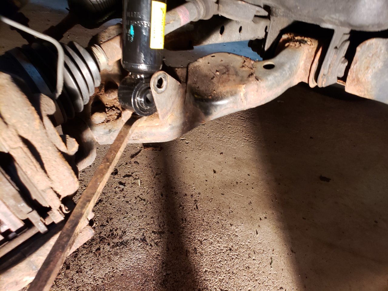

    2006 Tundra
    2" leveling kit with 285/70/17s
    UBJ is disconnected with abs and brake line.
    Do I need to take the outer axle nut off to get this to drop more?20191110_113402.jpg
  2. Nov 10, 2019 at 9:46 AM
    Hbjeff
    Hbjeff New Member
    Jan 20, 2019
    #24845
    5,119
    Huntington Beach
    2010 DC 5.7 2wd
    Is the sway bar disconnected?
  3. Nov 10, 2019 at 9:48 AM
    1stgenJim
    1stgenJim [OP] New Member
    Sep 26, 2019
    #36654
    26
    2006 Tundra
    Yes
  4. Nov 10, 2019 at 9:51 AM
    Hbjeff
    Hbjeff New Member
    Jan 20, 2019
    #24845
    5,119
    Huntington Beach
    2010 DC 5.7 2wd
    If I remember correctly on my gen 1 i used a long pry bar to pull down on the control arm gently. I did have uniball upper arms tho so maybe that allowed the extra travel. But i see you have it disconnected now
  5. Nov 10, 2019 at 9:53 AM
    Hbjeff
    Hbjeff New Member
    Jan 20, 2019
    #24845
    5,119
    Huntington Beach
    2010 DC 5.7 2wd
    Do you have spring compressors? You could make the spring 1 inch shorter and it will slide in
  6. Nov 10, 2019 at 9:57 AM
    1stgenJim
    Sep 26, 2019
    #36654
    26
    2006 Tundra
    I rented one but it wont fit between the coils

  9. Nov 10, 2019 at 10:07 AM
    TX-TRD1stGEN
    TX-TRD1stGEN Privileged
    Sep 12, 2017
    #9618
    867
    Seth
    South East Texas
    2000 Tundra 4x4
    Put some weight on that lower control arm. Looks almost level. Should drop
  10. Nov 10, 2019 at 1:57 PM
    seth419
    seth419 New Member
    Nov 7, 2018
    #21461
    283
    Santa Barbara, CA
    2005 Tundra DC 4x4
    Mark where the alignment is and loosen the cam bolts, the LCA will drop. Put it back to where your marks were and go get it aligned.

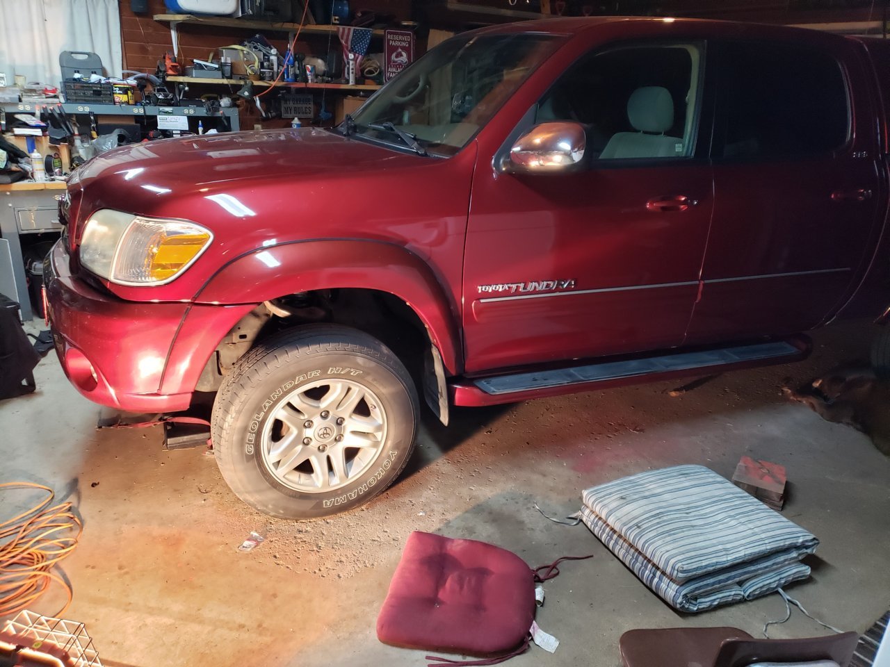

  11. Nov 10, 2019 at 2:11 PM
    1stgenJim
    Sep 26, 2019
    #36654
    26
    2006 Tundra
    Went from 34" at the top of the wheel well to 37.5"
    Not sure if I'm going to put the blocks in the back yet. Its sitting close to level now.

  13. Nov 10, 2019 at 2:24 PM
    Hbjeff
    Hbjeff New Member
    Jan 20, 2019
    #24845
    5,119
    Huntington Beach
    2010 DC 5.7 2wd
    It should also drop a little after driving a block. You dont want 3 inches of lift like that...
