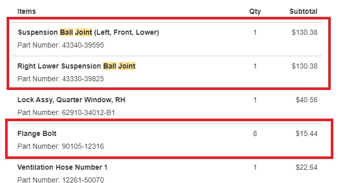

    There is NO budget safe LBJ, take that bullshit somewhere else. OEM only. And they're not that expensive that you can't do it right and be good for another 150k miles. I was out the door for $275 for both OEM LBJ and 8 new bolts from an online dealership, and yours may very well be cheaper with the earlier year model. Took me an hour to install on both sides with basic tools plus a pitman arm puller.
    But in all seriousness, why ask if you're going to refuse the advice with weak, BS excuses about budget? what the fuck good does saving money do if your truck looks like this tomorrow, and will cost you a grand or two, losing the the truck totally, or losing the truck and being mired in medical bills, or losing the truck and your life? Don't be these fools: , , link, link, link, link, link, link, link
    Take the necessary steps to check what's wrong. And avoid non-OEM parts. Here's why you don't want to use aftermarket, not only is it not designed to address Toyota's design flaw with the suspension, OEM uses all metal, typically no platics. Don't let a mechanic convince you otherwise. And change your own LBJ, it is really not hard to do.

    Ourisman Toyota of Richmond (Google them) sell OEM parts at pretty much the lowest prices you'll find. Look above for the part numbers that @shifty` was kind enough to provide. Then pull up the parts on Ourisman's website. Don't buy there, just go to your local Toyota dealer and ask them to price match Ourisman's prices.
    This will be the cheapest way to get OEM lower ball joints. Don't mess around with aftermarket (as everyone else already said), and don't mess around with "2nd hand OEM" either. Don't reuse old lower ball joint bolts either.
