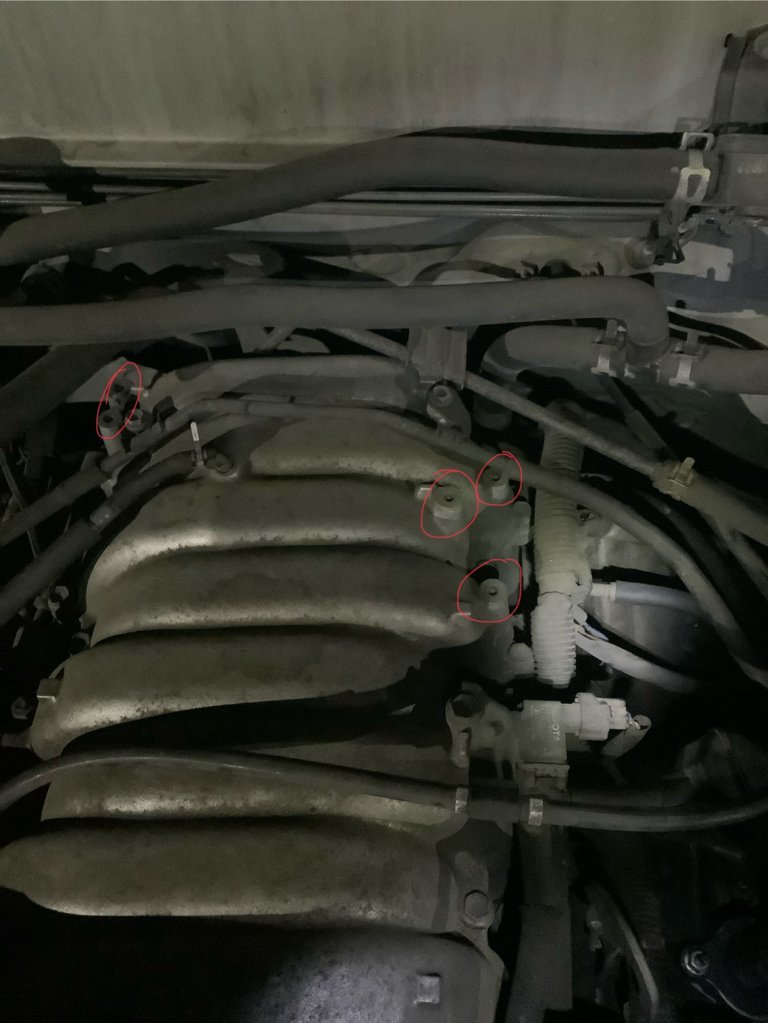

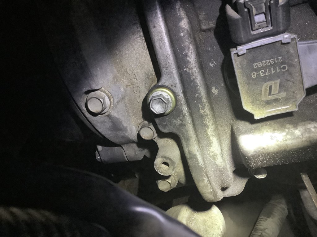

    Ok im like 99% sure that there’s not supposed to be any bolts that go into these holes but I still have to ask, if not, why are they threaded?
    If for some reason I am wrong about nothing belonging their, (so help me God) you’d be very surprised just how long this engine has gone without them lol

    That's probably engine dressing bolts for the LS/GS/SC430

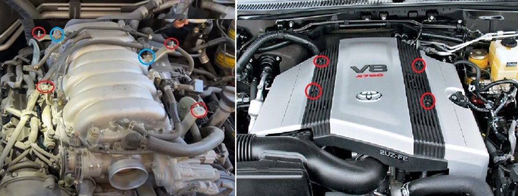

    Yup....the below is a 2000 Lexus 2UZ engine cover bracket location(red) and the bolt holes for cover brackets(blue). The other places you marked are Lexus hose clamp holder bolt holes of hoses you don't have.

    Lexus engine cover mod. Never seen that on a first gen. Yet
