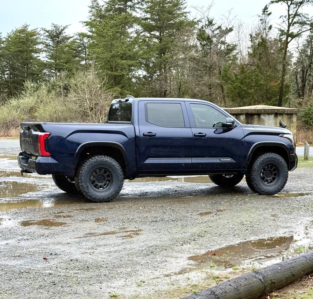

    I have a 2024 Platinum non-Hybrid/non-TRD and installed the Westcott 3/1 with the silver CV axles and running 37" tires. I did not install the top shims...no specific reason. Some people use the shims and some don't. I really like the way it drives and truly believe they should have come that way from the factory.

    Thanx for the Reply man. your truck looks great. I am just trying to avoid having to put them on then have to take them off and endup paying twice for alignment and install.
