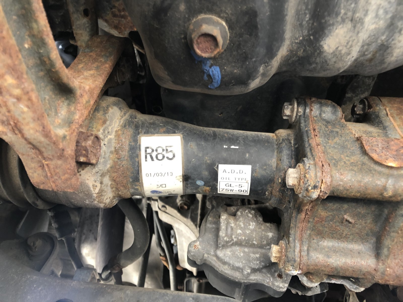

Went to change the front diff fluid, found this R85 sticker

    can anyone tell me what this date represents. it's for next year... is that when fluid needs to be changed (there's no record of this fluid being change). I bought this truck a few weeks ago and just going through everything right now.
    also... when changing the front diff fluid... should i order new fill/drain plugs and gaskets? they look original, but not terrible.
    thanks guys!
    also i'm not sure if that darker metal is a leak... it's definitely smells like oil... but it's not recent. almost like the person who previously changed the fluid made a mess and didn't clean it.

    What’s the build date for your truck?

    My guess is that date is actually August 24th, 2005.

    on the door seal is says 09-05. so september 2005. crazy how good the sticker looks. seems like it was recently put on! would you swap out the drain plugs with new ones?

    R-85 is our in-house part number for the front diff, basically for delivery to the line. Having large, easy to read numbers makes it easier to make sure you dont use the wrong diff (gear ratio), or wrong config. You will notice the firs pic, R85 is the basic part ID. Underneath, in small print, is R85 followed by the serial number.
    Many Toyota plants have several models running down the line at the same time. Texas now has Tundras (all types), 4 door Tacomas, and Sequoias. They run down the line in the sequence of orders received. A blue Taco may be followed by a silver Sequoia, then a Red Tundra. The paint shop runs the same way.
    I spent years at Toyota Mississippi. That plant is strictly a Corolla plant, but we usually had 5 or 6 subtypes. Hybrid, export, sunroof, satellite antenna cutout in roof, etc.
    They all ran in order sequence.

    Thanks for all the info. That makes sense now. I was mainly surprised at how good the sticker looked. I thought maybe it was a service sticker that it was done recently.
