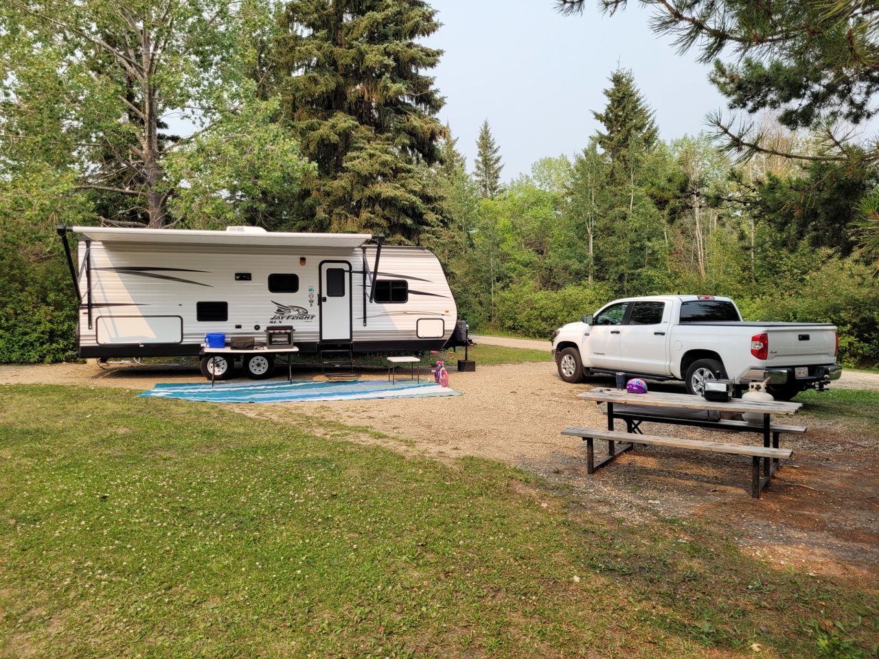

    The family and I loaded up today to go camping for 4 days , stopped by a Catscale on the way out . I've never weighed my setup and was eager to find out where I stand . With all the talk about low payload I was nervous that I was overloaded . I'll attach a screen shot from the weigh my truck app . Also before we left I added another washer to my E2 weight distributing hitch because I felt that the rear end of the truck was squatting a little more than I would like . It was a slight increase in distributing weight onto the front axle of the truck . It's definitely reflected on the weigh #'s . I'll be removing the washer once we get home . I'll look Into air bags for next year to level out the truck to my liking.

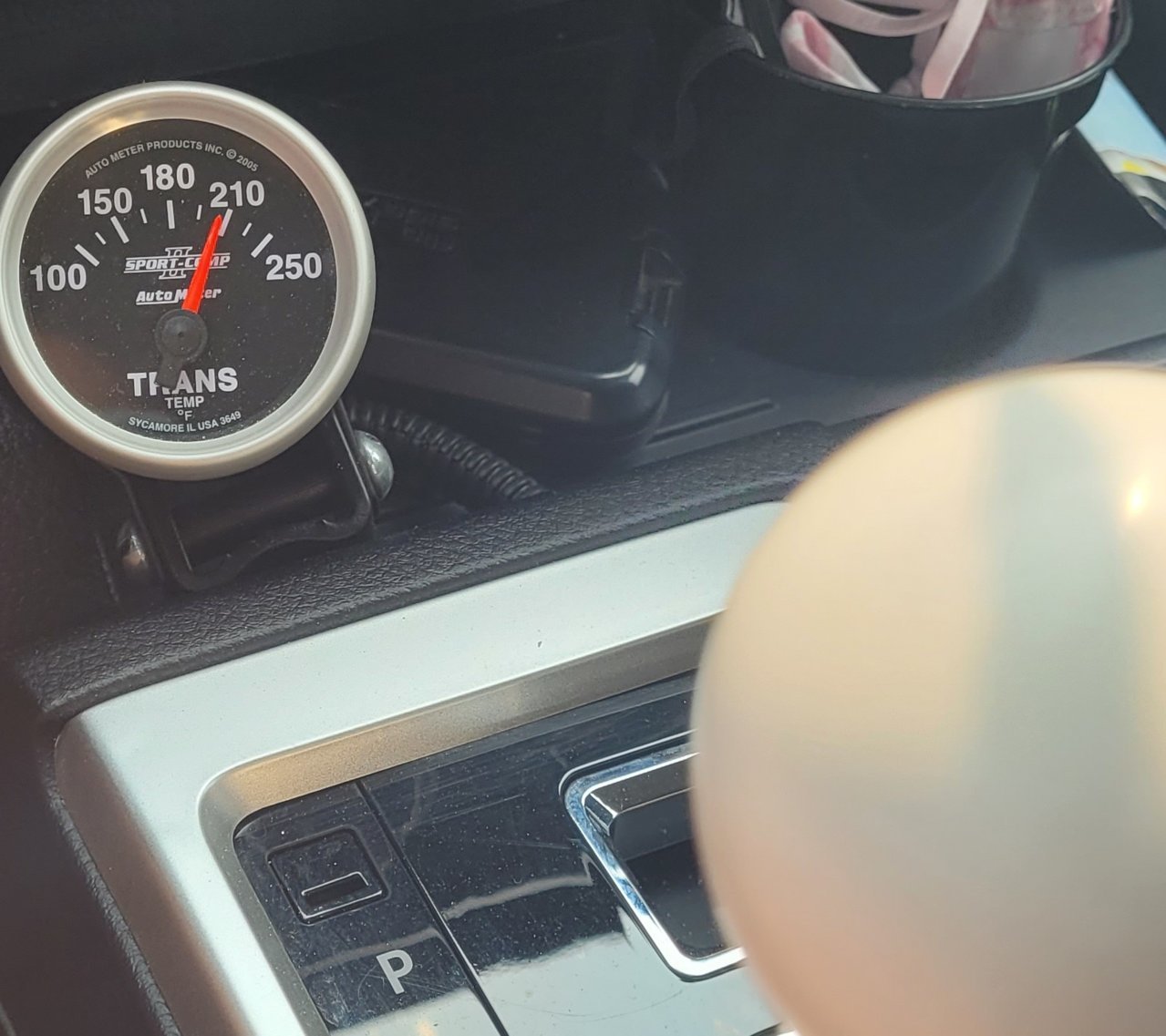

    Through in a pic of my trans temps while towing . Never got any higher than shown in the pic .
    Trailer is loaded with our gear and food but water tanks empty. Truck has firewood and other gear in the box .
    Trailers unloaded weight is 5450lbs with a 7000lb gvwr.
    The trucks gcvwr is 15.540lbs
    Trucks front axle gawr is 4001lbs
    Trucks Rear axle gawr is 4144lbs
    Trucks gvwr is 7198lbs .
    Looks like I'm over payload by 400 ish pounds . But still under the gcvwr.
    Anyone else feel free to chime in and share your thoughts and or questions .
