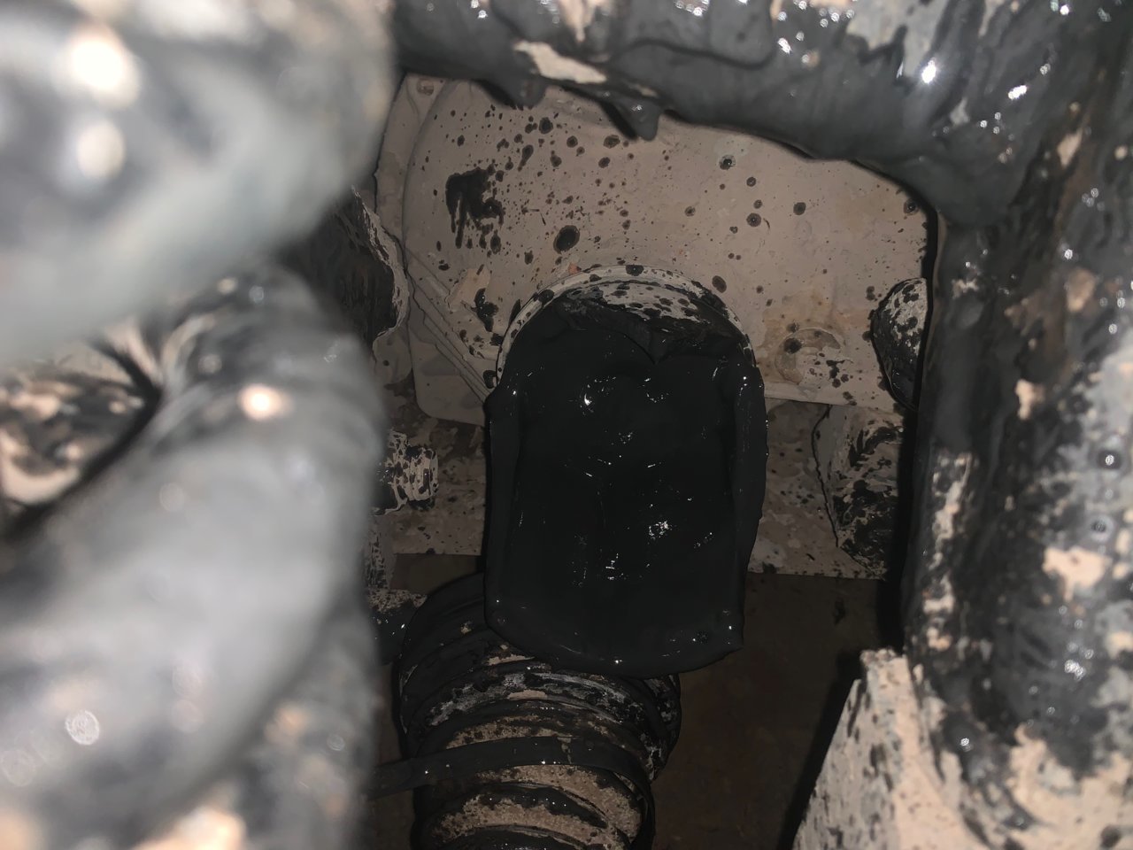

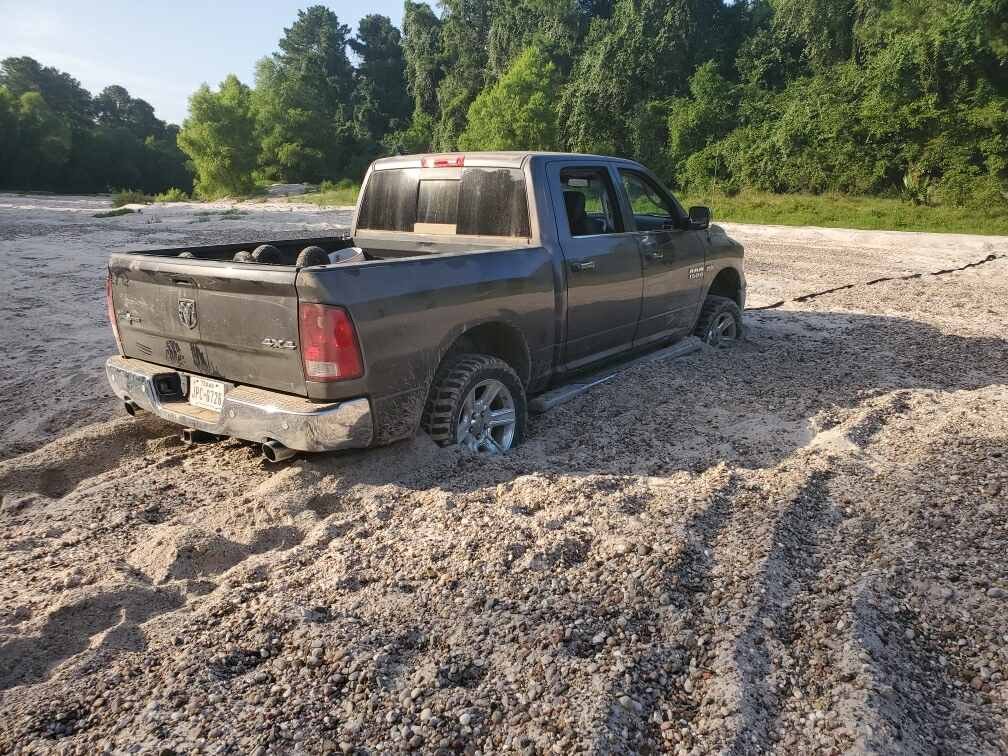

    Had a rough day yesterday, tried to pull a buddy out of the sand and put too much pressure on the ole Yota.

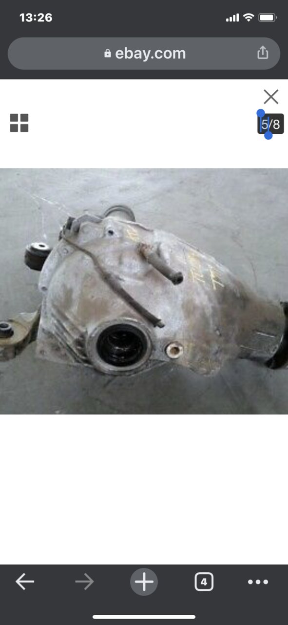

    Pretty sure this is part of the front diff housing that's broken off, but haven't been able to clarify with a good pic yet. Can't believe this thing snapped like this, didn't think it was under this much strain. Are these inherently weak????

    Looks like it's the inner CV on the front axle, but hard to tell from the pic. If it is indeed the CV, it's a fairly easy swap.

    It’s an “owie” for sure, but a simple enough fix, and well under a million dollars to fix. It’s your CV axle (well, inboard CV joint to be specific, but you’ll change the whole CV axle) and it comes out of the diff with a bit of convincing with a good prybar.
    Since it’s the left side, you might want to consider replacing the needle bearing in the diff with the ECGS bushing while you’re in there. To prevent that vibration issue since you appear to be lifted.

    Yup, looks like the CV.

    hey all, i thought i was on high/hard ground. we were at a river, he was in a dodge 1500 4x4 and drove down on the super sandy beach after i told him i wouldn't. so he initially got stuck about 150 ft. from the hard pack to get up the river bed, we went to home depot and got supplies we thought could help. 2x4 to put 2ea on the rear tires to get grip while we tried to get out that were ratchet strapped to wheels and about 5 new tow straps as well as a chain.
    bad part was the angle of incline that was my only option getting up the river bed and also found out it wasn't as hard packed as i thought. when i started to pull, truck started hopping and grabbing pretty hard then dug into more sand about 1 foot. next time it came down and grabbed hard in low 4, with all nannies off and tow haul..........that was all she wrote!!!!

    Shovel would've helped to dig around tires as well as deflating tires down. Probably could have got out unassisted with those techniques.

    for sure the inner cv axle on driver's side, but i think the housing is what the case that cracked

    That hopping you described is what got ya...better to break a CV than to tear the guts out of the front differential. Its never fun when this happens but it does, the price we pay to play :)

    Can you get a better picture or two?

    will try and get some a lil later

    Bummer on the axle carnage. That can really put a damper on a weekend trip. I have seen hundreds of axle snapped in two....CV shafts, D60, 14B, D70, Super 60, exc. I have a buddy that has a stack of chromoly axle shafts in his garage. If he was a blacksmith, a mid evil army could be weaponized.
    So here is the silver lining. As @landphil stated, easy swap and relatively cheap to do. The ECGS bushing was a great recommendation. Toyota did upgrade the needle bearing on the 3rd gen, but in no way stout like the replacement bushing.
    Definitely gave her the onion and full send. Snatch ropes or winches work great in these situations.

    If it was cracked, diff fluid leaking could be an indicator.

    Absolutely, the added cost of an OEM axle is worth it. I busted one on the trail in my 4Runner and it took an hour to swap it out with hand tools and a hi lift jack. So all in all, it's not a horrible fix.
