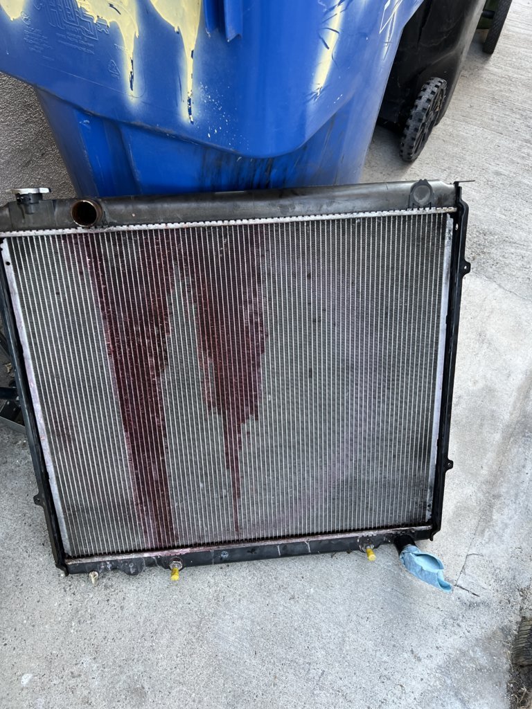

    Some of you may remember I was so worried about my spare tire before a road trip. Instead, the radiator blew up. Four miles outside Bridgeport, tiny town near Yosemite.
    there’s no mechanic in town but a Good Samaritan helped me figure out the source of the leak and water just gushed out of the radiator itself. I was able to order a new radiator and cap and it seems easy enough to fix. Is it going to be safe to get back on the road once I have a new one or is there other things that might have gotten messed up when the coolant explosion happened? The old radiator definitely looks pretty gunked up and rusted so probably been working on a leak for awhile now.
    of course, I’m at least 8 hours from home and stranded in a tiny little town. At least it’s scenic.

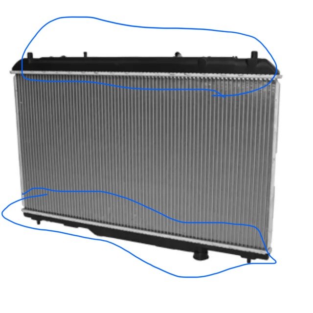

    Crack in the plastic tanks? Or between the tanks and fins?

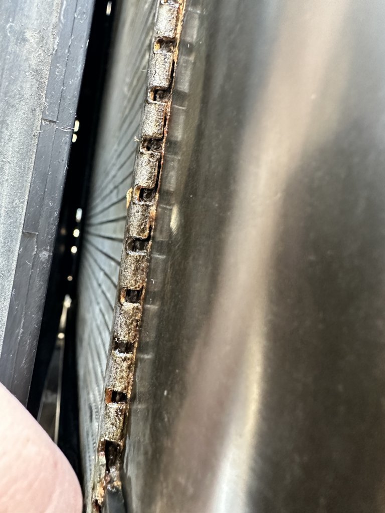

    The plastic tank is fine, it exploded all out the front grill and pouring out the actual radiator

    i meant the top & bottom radiator tanks. And is the plastic on your radiator kinda a brown color or still grey/black?

    Ohhh yes leaking from there! Umm I can’t remember if it’s brown or black but it’s super cruddy and corroded looking in that area. I’ll check tomorrow. I want to say it’s black but I could be mis remembering that.

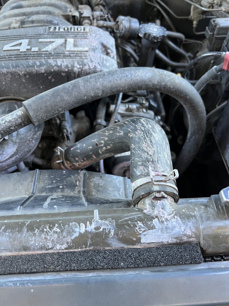

    You will want to have a quart of ATF on hand too, you will lose some replacing the radiator and will probably want to replace it. Shouldn't lose more than half a quart, but just have some to top if off if you can.
    Watch out of cracked hoses. Sometimes a hose is borderline, until you have to take it off, and then it cracks on you right there while you get it off.

    lol yes it looks exactly like this! Ugh shoot should I try and order some hoses now just in case?

    If you can Order an upper and a lower do it. Have them and not need them. You should be alright tho. Even if you end up with a small leak you can always just add more water or coolant. This might require some additional attention once you get back home
    I didnt replace mine because I couldn’t get them to fit over the fitting so I left the old ones on. I carry a oem set in my truck when I go camping tho

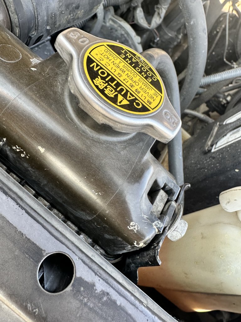

    Ah yea I guess it’s super dark brown. It’s leaking from this cruddy part. IMG_4218.jpg IMG_4222.jpg IMG_4222.jpg IMG_4218.jpg
