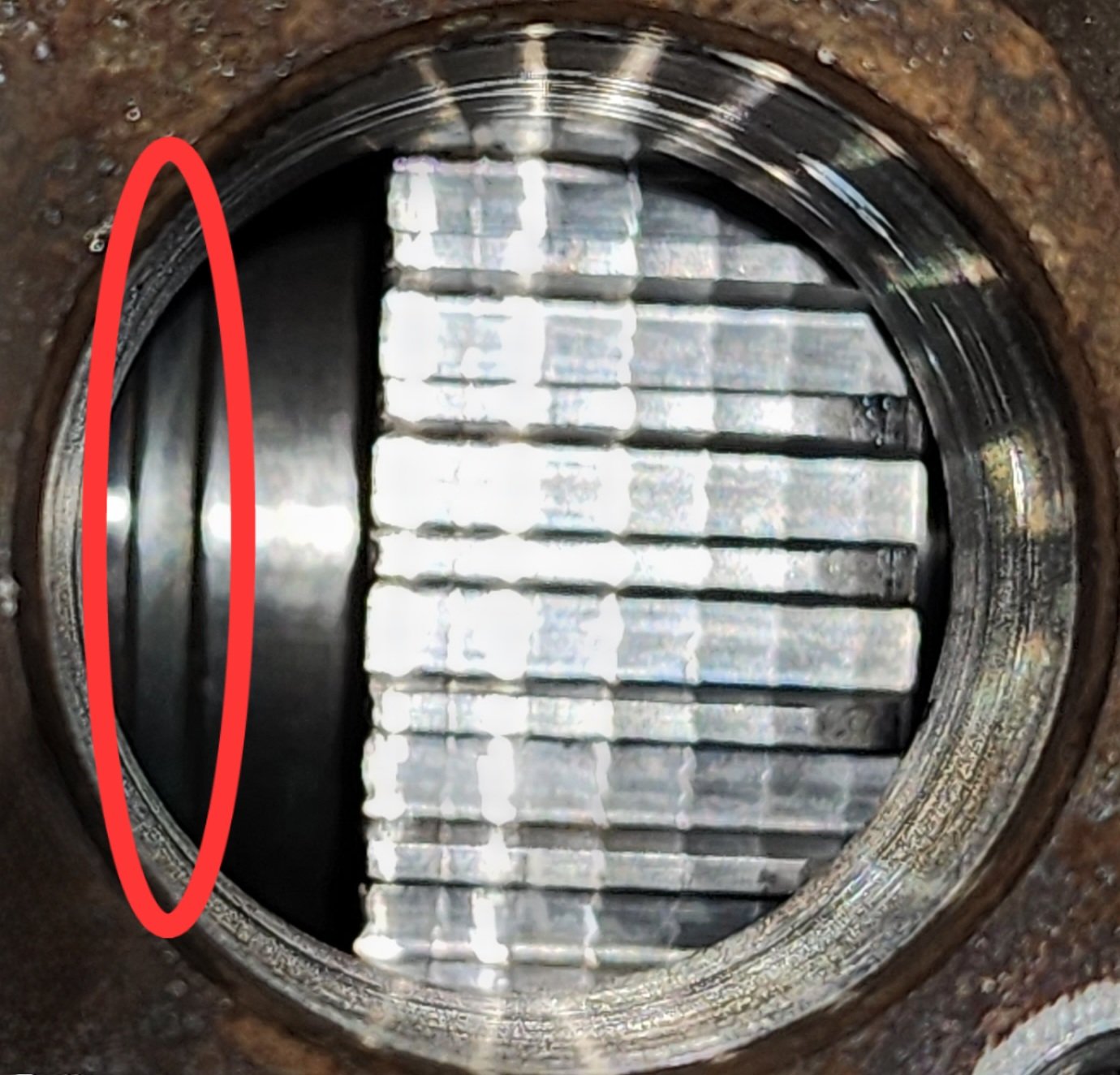

    Bilstein 6112f/5160r w/700lb springs, wheelers AAL w/3° shim JBA UCA, Solo LCA Nokian Outpost AT 275/85R16 Brute Force Front Bumper w/Smittybilt 9500
    Has anyone had the snap ring that sits between the ABS sensor ring and the bearing retainer come loose and destroy their ABS sensor? Happened to me 80mi from home, at first I thought my carrier bearing or ujoint went out. Then I thought it was an issue with my drum breaks and finally after much frustration I pulled the sensor and found it completely destroyed and the jeaslus clip looking bent and sticking out towards the tone ring.
    Just curious if anyone else has experienced it as I couldn't find anything searching.

    Your saying this circlip somehow dislodged and expanded beyond the diameter of the ABS ring to hit the ABS sensor installed in the axle housing ... like snapped in half and flew into it or something?
    It is not still here when viewed through the sensor mounting hole?

    Yes that's exactly what happened. I'm not new to cars or working on them but I've never seen this happen before. I've owned the truck since 2021 and have put just over 30k trouble free miles on it, the previous owner had bought it new and had all the maintenance records since new too. All done at two local Toyota dealers. I can't think of a reason for this to happen except for either a poor quality circlip or improper installation when a wheel bearing was replaced.
    I'll try to get it pulled this weekend when I'm back from work and get a bunch of pictures added.

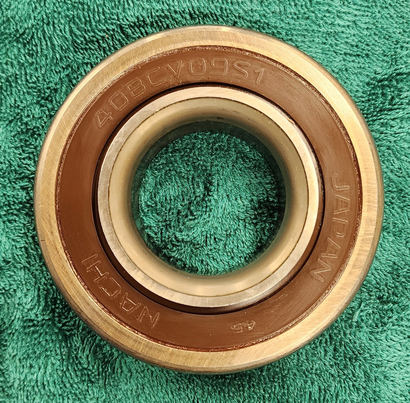

    Even if (and maybe especially if) a shop is doing the swap, consider this and and grease/sharpie testing the seal fit on the inner retainer like photo above before concluding retainer placement is correct.
    Looking forward to the pics of what's in there, factory bearing or if it was swapped with aftermarket. Read once someone used an aftermarket bearing and snap ring wouldn't fit back into groove. If left outside the groove stretched, maybe stressed to breaking?
    Turns out SKF appears to be the same Nachi bearing as OE that should look like this:
    Also found National's bearing and 2 retainer kit at Advance for $86.99 contains a Nachi bearing but with 20% sale and $5 speedperks for net of about $65.
    Research concluded Toyota seals were best option though. IIRC bearing, retainers, snap ring, dust seal, oring, and oil seal, was like $197 retail from Toyota.
    But IIRC bearing and two retainers from Serra Toyota was $83.87 during 25% off online pricing sale with free shipping, so only like $105 total with snapring, dust seal, oring, and oil seal.

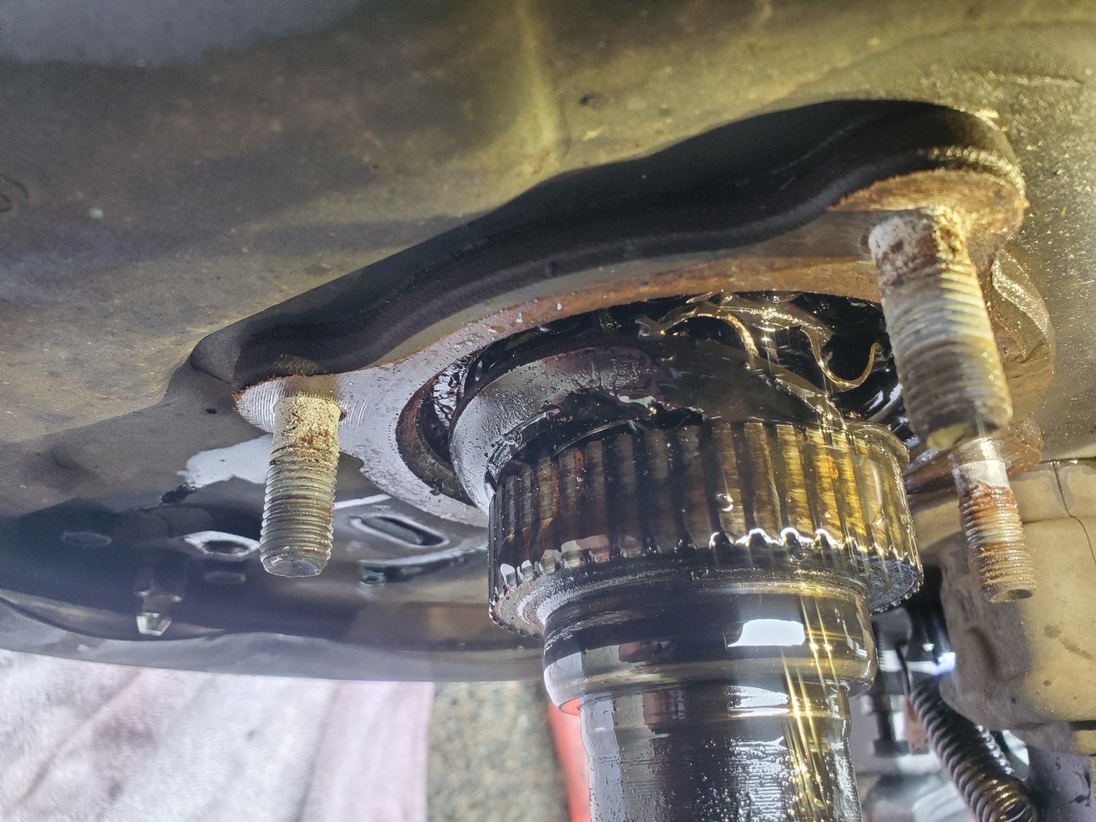

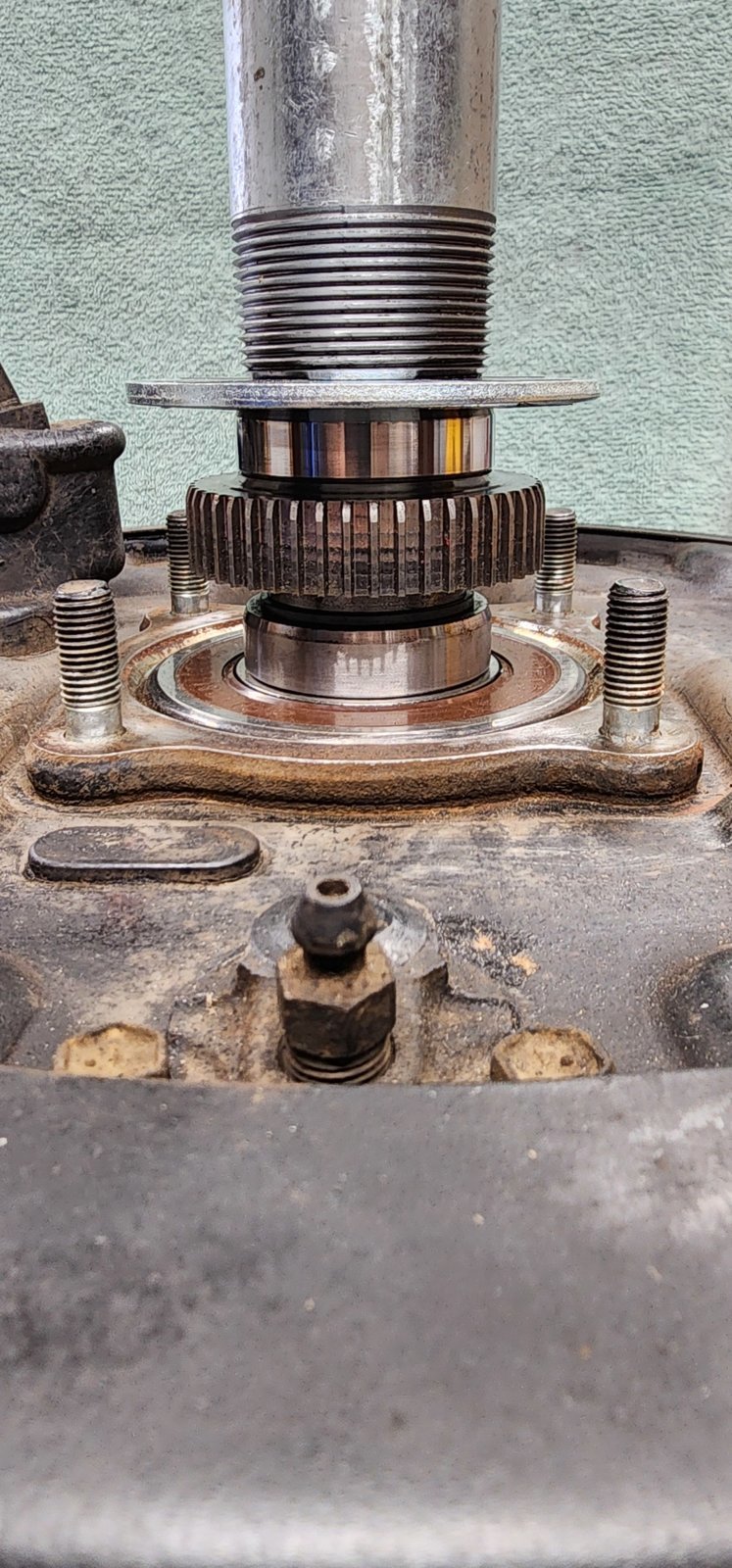

  11. Jul 2, 2024 at 1:05 PM
    MD0811
    MD0811 [OP] New Member
    Mar 29, 2023
    #94619
    30
    2006 Tundra DC V8/4WD

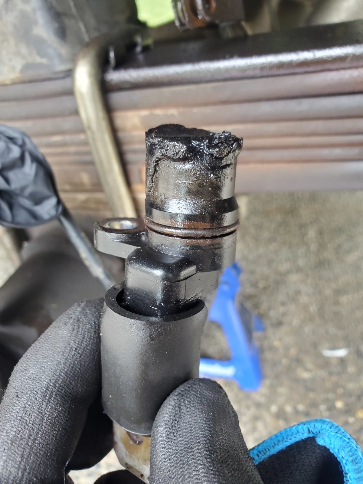

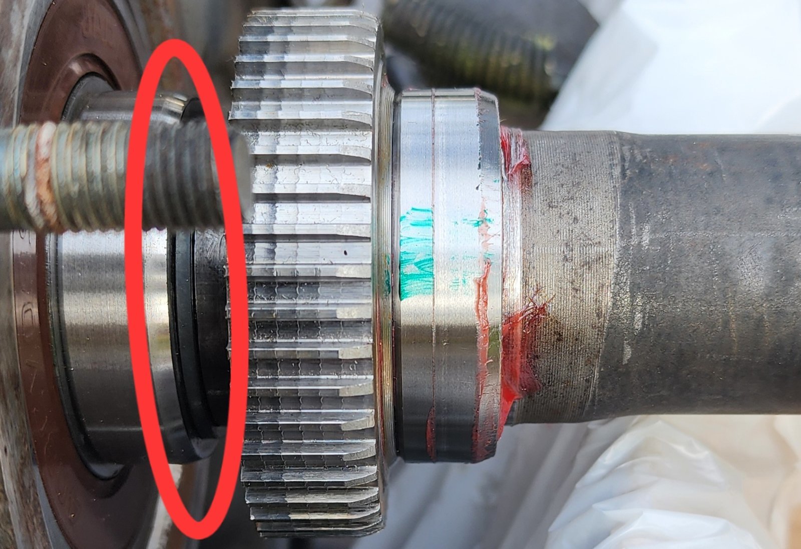

    It looks like my wheel bearing completely grenaded itself. Here's what my poor ABS sensor looks like now.17199506859683279468303475802015.jpg
    Jack McCarthy, tvpierce and bmf4069 like this.

    I have a new bearing set and I'm on my way to the machine shop to have them press everything on for me.

    Tone ring and new retainers too? Do they understand the delth for the inner retainer?

    Yeah made sure they understood that.

    Wow that's crazy. I wonder if the last guy that did the work try to press everything apart with the snap ring still installed and reused it after he figured out what he was doing wrong?
    On a side note ... it was cheaper to buy the press, special tools, and parts and do it yourself than have the dealership do it.

    Well if he did he at least got the tone ring in the right spot. Unfortunately I don't have the room for a press at the moment so I just pulled the axle shaft and took it to a machine shop.

    I'm just gonna reiterate how important that is.
    Hell, the dealership won't even press em if you just bring the axles. They want the whole truck.

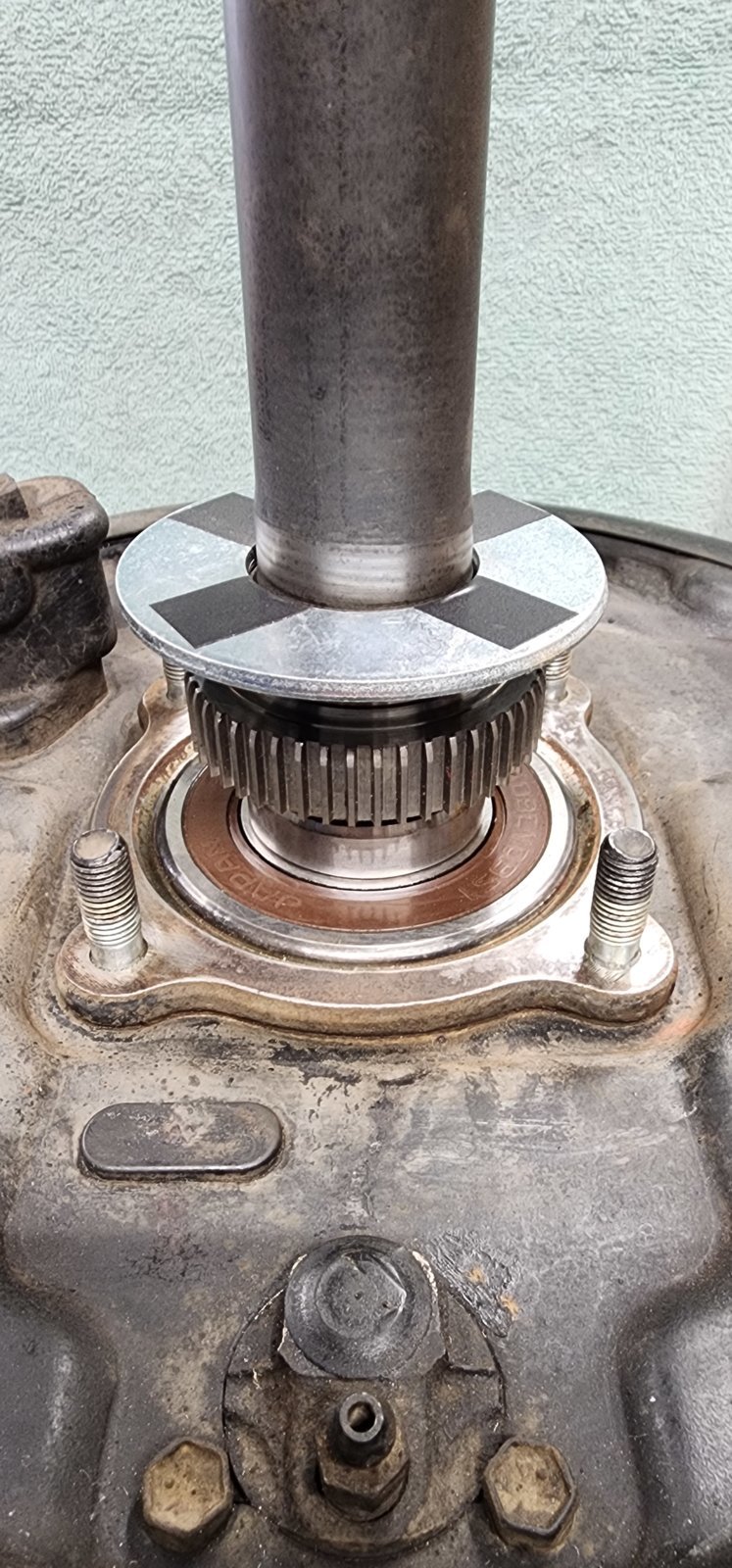

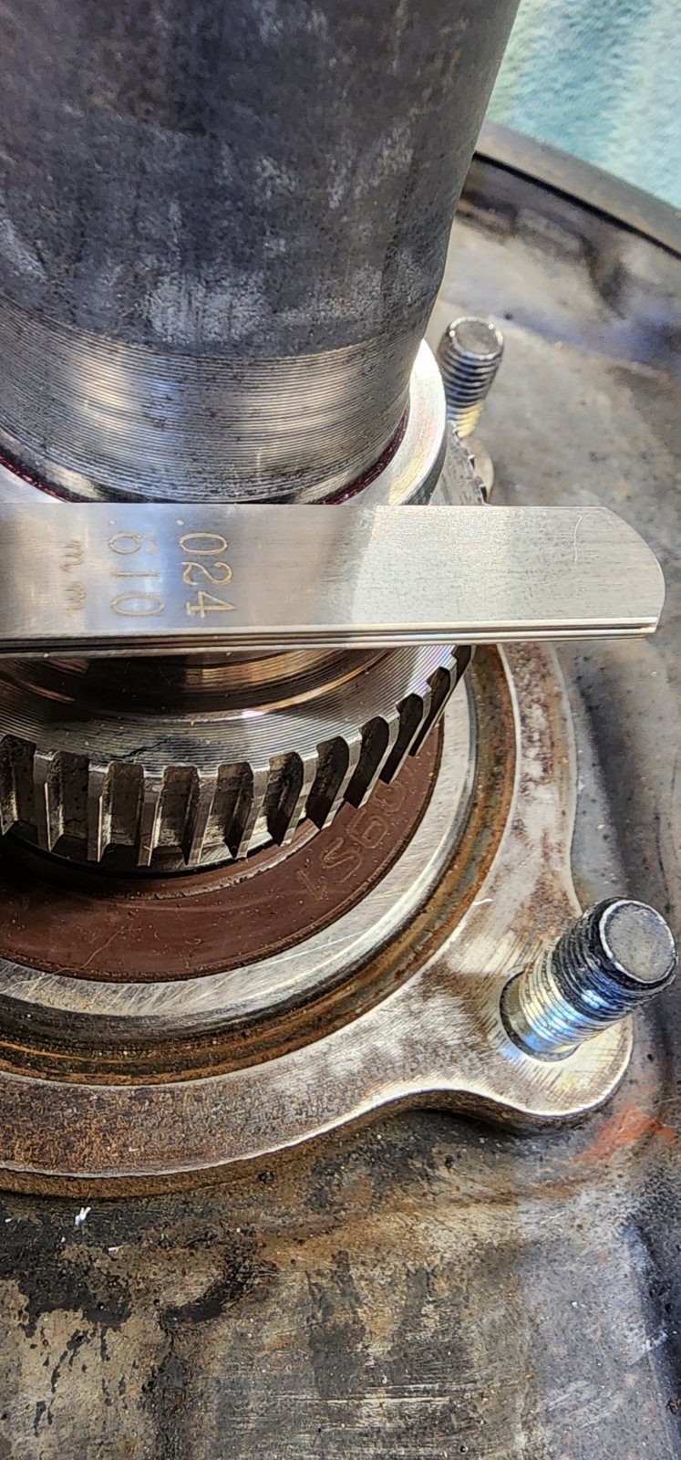

    Well I'm annoyed, finally got the axle back in... ish. I gave the Toyota factory specs to the machine shop and this still happened. So I'll pull it tomorrow and take it back Monday and find out how good their customer service is. On the plus side I'm getting to drive my MR2 more now. 20240719_202845.jpg 20240623_205436.jpg
    FirstGenVol and bmf4069 like this.

    I really don't understand why they messed this up, I told him where the clip bearing and tone ring need to be, he even said they had done Tacoma and Tundra axles before too. Definitely frustrating.

    Sorry to hear.
    Worth a read/study for next time:
    Here's the link referenced:
    https://www.tundras.com/threads/recent-axle-seal-tips-hints-and-prayers.92986/#post-2345610
    If you're insisting they do it over can show them the pics from that post of what it should look like and the measurements. Then when you go get the axle back (or your money back to repurchase the retainers and do the work over elsewhere or yourself) the axle can be inspected upon pickup for rough measurements/placement, and then can be test fit using the sharpie/grease test to check placement of the inner retainer for the new seal.
    If they install at say 3mm or 4mm and that's too shallow based on the test fit, then can plan to push it down more, but if they overshoot at 6mm or 7mm even it may be too deep.

    Most shops just press it till they stop. My assumption is they don't understand anything unless it's a chevy 350 small block.
    I ended up being the Toyota axle press tool and using my buddies 20 ton press to just do it myself.

    I like this guy's approach to getting the right measurement for the tone ring and retainer...by using the steel pipe instead of the press he's able to control precisely where they end up. It looks so easy that I'm fantasizing about doing it myself!

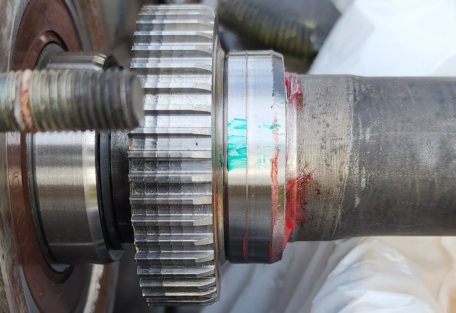

    After pressing on, was able to use a 12" pipe for the final adjustment, but measured way more precisely than a tape measure like in that video, using caliper and then feeler gauges for precise width measuring the distance from the inner axle bearing machined retainer mating surface. Installed short of spec, grease tested, measured desired additonal distance and tapped it to the desired location, grease testing again to verify seal on retainer and also inner retainer clearance from axle housing. Also used a washer with some black tape on the ID to help not groove the machined axle surface from the pipe and protect the retainer face.
    Feeler guage measuring.jpg Washer and black tape.jpg Pipe and washer.jpg Grease-sharpie test.jpg
