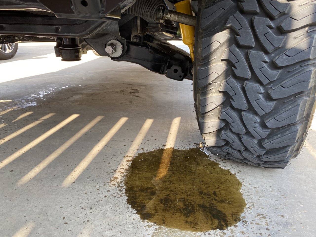

    I checked my PS fluid yesterday and it was good. Drove 25+ miles today and all was good. Pulled into my driveway and the PS was moaning. I check it and it’s reading low. I research the best fluid to use (maybe 5 minutes) go to fill it up and it’s full again. WTF?
    How/why did this happen?

    I just started it and turned the wheel. It’s moaning and now the reservoir has zero fluid in it yet it was full 20 seconds ago?!?
    Nothing leaking.
    Just filled it up twice and it’s just sucking the fluid down without even turning the wheel.

    AND the R&P just shit the bed. 55K miles. WTF?!?!
  4. Oct 4, 2020 at 2:52 PM
    The Patriot 1776
    The Patriot 1776 [OP] Asskick Fabrication: Shit Is Sick!
    Aug 25, 2020
    #51316
    667
    Great State Of TEXAS
    '16 TSS CM 4x4
    Shot fluid out both boots.
    wtf do I do now?

    While it was in my driveway, and I was working the steering wheel back and forth, it made a noticeable pop in each direction prior to it pissing fluid out of the boots. I guess that was it blowing the R&P seals? Sitting still in my driveway?

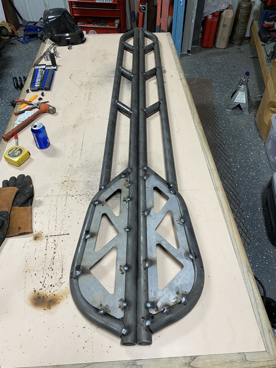

    I had to find a way to slow my roll and relax so I started welding my RRW rock rails. Welding is about the only thing I ever do that slows my brain down and lets me relax. I purposely put the cross pipe gussets backwards for better triangulation.

    So evidently the fluid pouring out of the boots is the common way of knowing the R&P seals shit the bed. It leaks into the boot & when you add more, it builds more pressure until it can shoot it out the boot(s).
    Just ordered 44250-0C131 for $525 delivered. My local dealership wanted $750 & wouldn't price match. Part should be here by this weekend.
