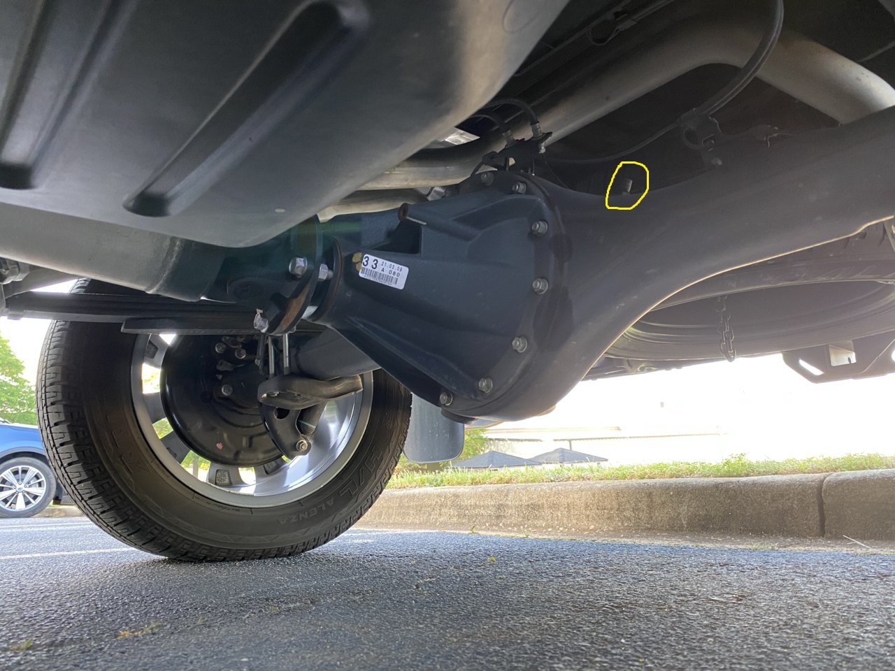

    Hello all,
    Long time lurker. I hope you all can help me here. I noticed some leaking around the differential. It has never dripped or pooled, so it’s not a fast leak.
    Is this normal? I tried searching this forum and Google, but couldn’t find much on the subject.
    I have 15k miles and an appointment scheduled later this week.
    51262CE9-4C0F-4A7C-BCDF-AB33F4769D2C.jpg 45630E00-2675-4B35-8E62-A4CF8B2CC627.jpg

    This was a pretty common problem, even with the Tacomas. Take it back to the dealership and let them sort it out.

    hmmmm I doubt an active leak will come from it. But definitely take it to the dealership while it's in warranty to have this documented. They may re-seal it.

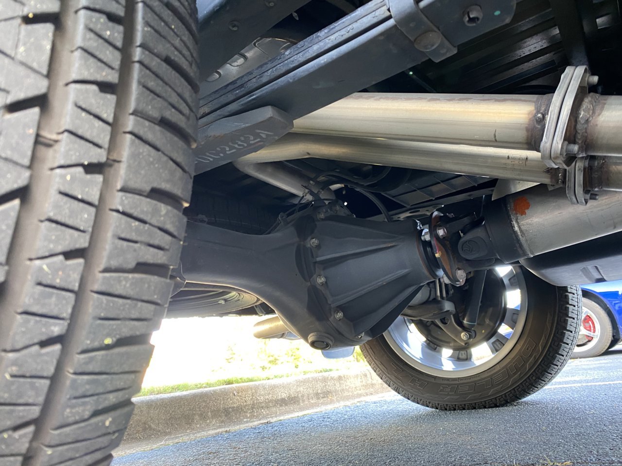

    Check your breather, could be clogged? It's that little nubby thinger-mabob sticking out the top of the driver's side axle tube (your second picture).

    Thank you all for the comments! I will certainly check out my breather and report back on what Toyota finds. I suspect they will clean the area and torque the bolts to start. I previously had a Tacoma that was bone dry so this was a little weird to see. I will also be doing some towing in the coming weeks so this is impeccable timing.
    Well, it is garage kept and I cleaned the undercarriage a few months back to rid it of road salt. I also happened to clean the inside of the rims during a rotation because why not.

    Update: Dealer wants to replace the seal. Considering my truck is still low miles and how intrusive this repair seems I may bypass it for now. I plan to clean the area and see how quickly it weeps from here on out.

    2019 with 18000 miles. Looks the same as yours. no issues. It is an assembly issue not necessarily an incipient leak.

    I would get it done now. The repair is not difficult. You don't want to run that diff low on fluid plus you can evaluate the fix and make sure it is not continuing to leak while still under warranty.

    A sealant is used not a gasket. Its good shit, surprised to see any "weeping". on flip side I doubt all the lube you see is equivalent to 1 drop. I wouldn't touch it.....

    My truck has 67k on it and has always looked like that. Never left a single drip.

    My 21 started doing this at around 12k. Washed it off with SimpleGreen/water and a tire brush. Gave the breather a few twists and it has not came back. Almost to 15k now. Gonna monitor it for a few more thousand miles, but so far so good
