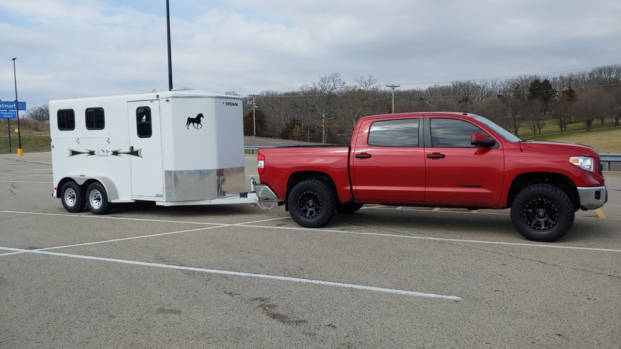

    Looking at the anderson as well. Seen mixed reviews though.
    Just picked up a unit to pull behind the Tun and Sequoia.20190324_110740.jpg

    Is the front of your Tundra now higher than when the trailer is disconnected? This would affect your steering and braking.
    Tuffy

    It is. No it wont. And why a WDH is needed.
