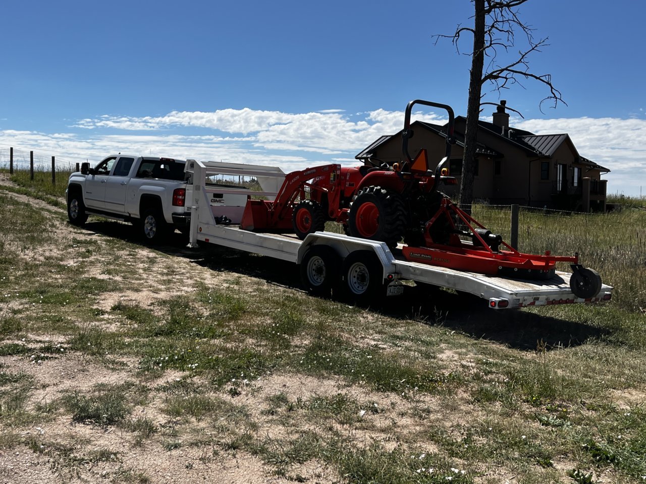

    Technically I am also over my GVWR on my GMC 3500 11500+16000=27500. My truck can legally be at 25300 lbs

    You may never need to worry about it if the towing is local (doesn't sound like it), and if you ever get pulled in I would be very careful what you say.
    If asked what you are doing with the load:
    -I have a hobby winery....
    -I'm towing this for my own personal use....
    -No I am not in commerce.
    I make money on the side with my tractor. Hell this past Friday I made 200.00 in a few hours worth of work. I have been pulled in with this load (we have a few DOT checkpoints in my area). Every time they ask what I am doing with the tractor. Same damn answer "this is for my personal use on my acreage, bringing back from service."
    The DOT officers have mentioned I am over GVWR....but can't do anything about it since I have been deemed not in commerce.

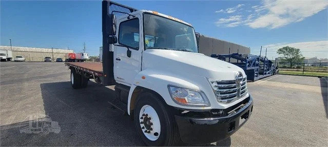

    Just food for thought BUT why not just upgrade too a "write off" vehicle instead of over working your Tundra...
    These can be had for 1/3-1/2 the price of a 3/4 or 1 ton pick-up and will serve your needs forever... No CDL needed as it is under 26,000 GVW and can be written off however you and your "tax player" need it...
    Now I did chose the Hino because it is the Tundra's much BIGGER brother :muscleflexing::muscleflexing: but any flatbed would serve you well and keep $$$$ in your pocket.... Tundra and trailer could be kept for "other duties"..
