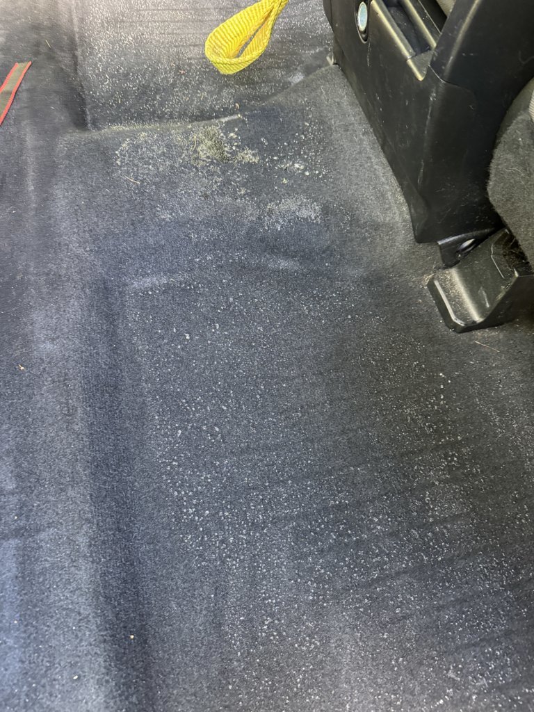

    About two weeks ago I gave my vehicle its first deep clean in a long time and pulled up the mats to find moisture had accumulated under the weather tech mats. There were no puddles but the mats had water on the underside as well as the floor having droplets of water. This was under the rear seats and passenger side mats. After find I removed the water with the carpet/area cleaner I had rented and removed all water. Today I had checked under the mats and found more water. Does anyone know what causes this? I do not have a sunroof nor have I left any windows open during any rain. I use my A/C a fair amount but not excessively so I do not believe that is the issue. I have uploaded photos of the condensation build up.

    What year is your truck? After using the ac then parking, do you notice a wet spot under tranny? Its possible the ac drain is clogged and its accumulating then finding a way out.

    It is a 2014, have not noticed puddles under the vehicle I will check the A/C drain.
