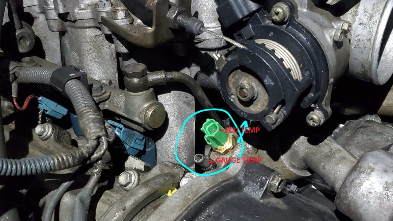

    The gauge sensor is different than the ECU sensor. I'd say keep an eye on the temp on your scan tool and make sure it is at a reasonable level.
    Pic from @Tundra2

    Just adding to an already-great reply for search purposes. Location is here on the earlier (non-VVTi, '00-'04?) models, to the passenger side of the throttle body. Two sensors, one for ECU to gauge temps, one for your dash gauges. Stick with OEM on this part (per rule of thumb: always use OEM on electrical sensors specifically).
