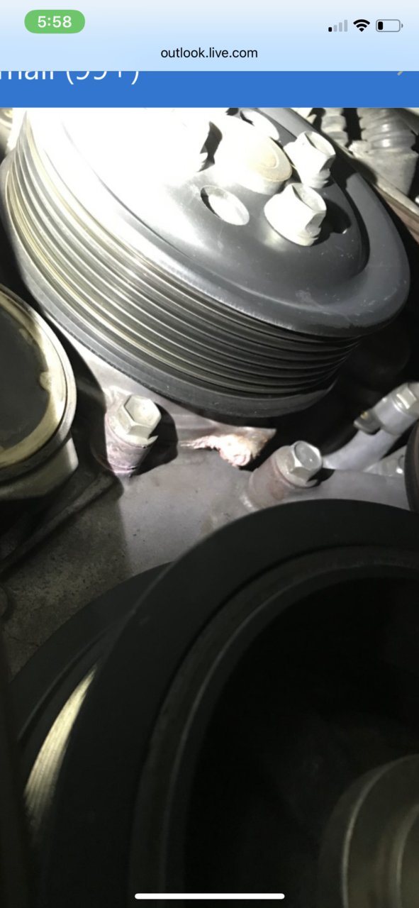

    Dealer just sent me this pic.
    Doesn’t look to be leaking anywhere else.
    Thoughts on replacing now or waiting it out for a few months?

    If you didn't notice it... It cant be leaking much. They say its a difficult job but id try it myself. Use aisin parts.

    Interesting. Dealer told me when they leak you don't notice the water dripping unless blown to hell and this helps me understand. Looks like you need to get out your tools and start gathering up parts. It's weeping and probably has some time left and not an emergency at this point. I ain't spending $1700 on that. I can get a month or 2 worth of hookers and blow for that price

    My 07 water pump was still "weeping" when I traded it in July 4th. Was weeping for almost 5 years. I'd add maybe an ounce of coolant every six months....

    Exactly.
    I’ve done the 3.4 V6’s before. I’m sure the 5.7 is easier. Just have to find that precious time.

    Actually it was already weeping when I bought the 07 in April of 2014. I still have a near full jug of Toyota red!

    It’s only $650ish.
    $1700 was oil change, front and rear brakes/rotors turned, along with water pump and a belt.

    The water pump leaks on previous Lexus/Toyota’s were very noticeable. This one, not so much.

    That's weak point of the tundras is water pump I did my first at 30k under warranty and another at about 110k but that's all I've ever had to replace till this day

    I had a similar leak at 90k miles took a weekend to remove and replace.
