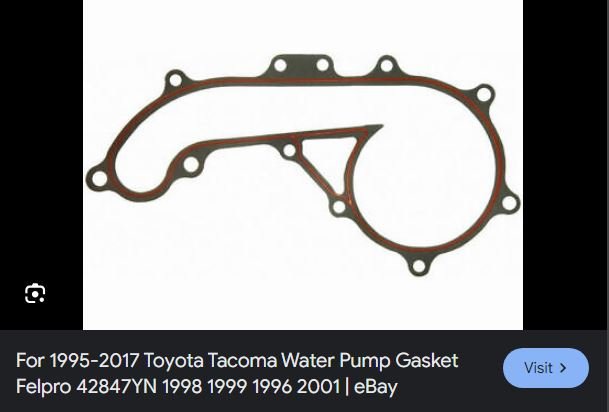

    upload_2023-10-23_11-25-22.pngWhat about this gasket. It's on rock auto for my year Tundra?

    I've only taken my engine apart enough to change the timing belt, but I never saw one like that. The water pump to thermostat housing doesn't use a gasket, only Toyota's gasket sealer, known as FIPG. (Formed In Place Gasket)

    That looks like a coolant crossover pipe gasket like the one behind the intake

    Come on now, you know that gasket isn't a rectangle

    For shits and giggles, call your local parts place and tell them the other guys gave you the wrong gasket for a tacoma water pump. Ask them to describe it to you before you make the drive to pick it up. :rofl:
