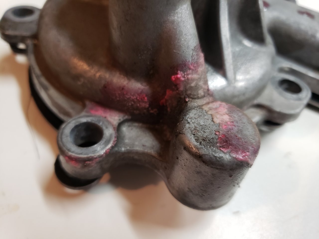

    After doing a trans drain and fill the other day, I noticed a few red drops on the ground today. Thinking it had to be related to the drain and fill I looked all over...checked the drain plug and level plug and the thermostat for the aux cooler that I pinned... all dry. Fluid on the ground was also up towards the front so I realized it was coolant. I'm shocked to say the least that it's already time for a water pump. I removed the skid plate and there was quite a bit of fluid on there, and I could trace it up to the pump area...although difficult to see exactly where it might be coming from. Checked with the dealership to see if possibly it would be covered by powertrain warranty. I'm under mileage but a few months over 60 months...of course. Dealer quoted about 850 bucks to change it if that in fact is what it is. the service tech wasn't sure it would be covered either way.

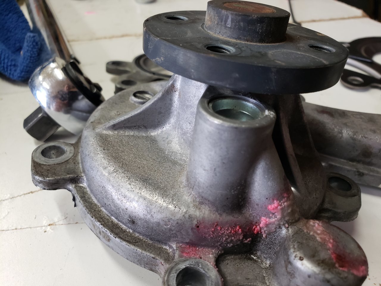

    Ok guys...I took the dive and replaced the water pump myself. Got a new pump, belt, and 2 gallons of pink toyota coolant. Took me about 4 hours. Wasn't too bad of a job other than that one bolt for the thermostat housing behind those hoses...and getting a few hoses disconnected. "Old" coolant looks great. A few questions though... how do you guys release the tension on the belt? Didnt seem like there was a good way to do it. Also, should there be any play in the fan bearing? It spins fine, no grinding or anything, but if I wiggle it up and down, there's a tiny bit of play I can hear...cant see it. I'll try and upload a video. One final thing that is a first for me... I dont think the seal or the pump bearings/orings failed. It looks to me like my pump housing is cracked. Never seen that before!

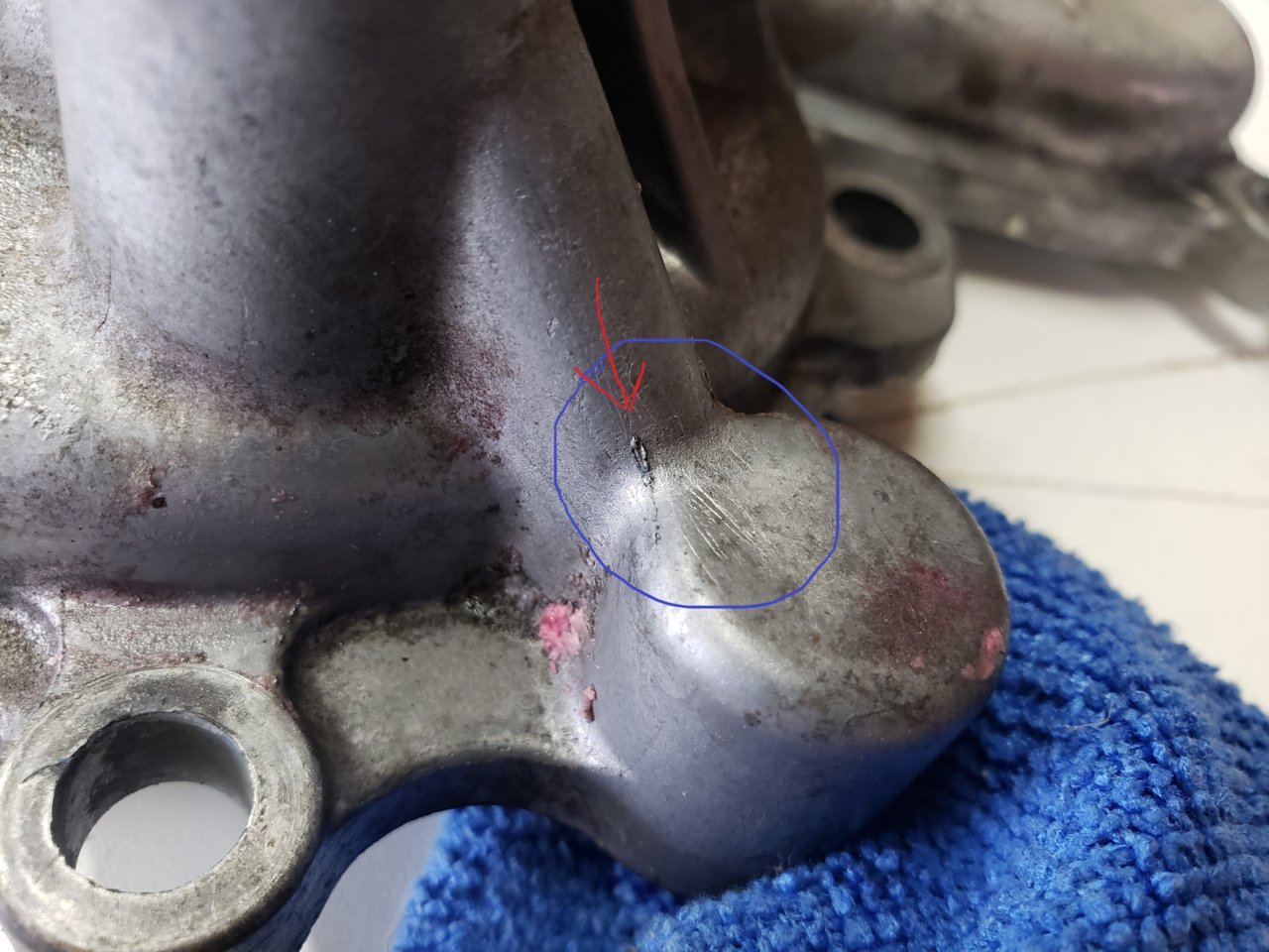

    the strange part about this is that it doesnt appear to be leaking from that plug notated in the PDF. that part is clean. it appears to be coming from a tiny pinhole in the picture here.
