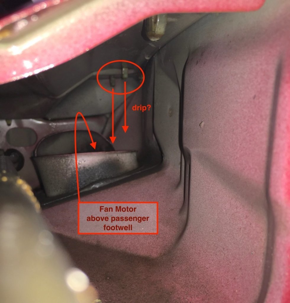

    Folks,
    We had some pretty heavy rain last night and I found water dripping onto the floor, passenger side front. I felt up under the glove box and it was wet. What should I look for?
    Thanks,

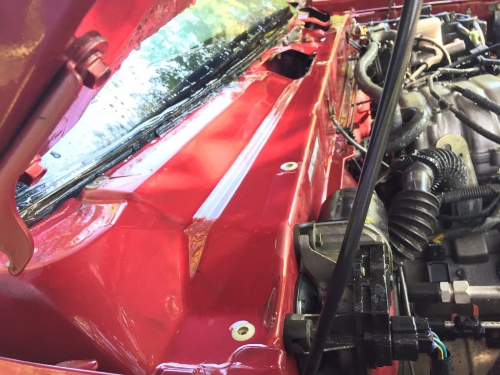

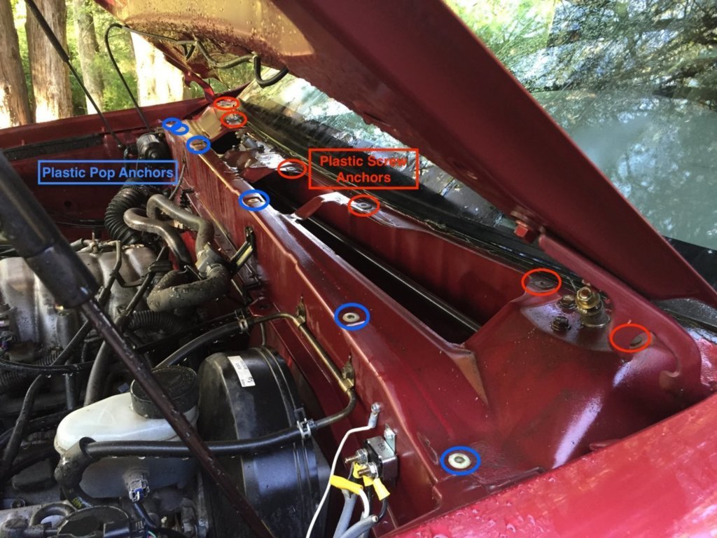

    Sir,
    Thanks much.
    I knew I needed to check here before searching myself. I had a similar issue with my 1990 Miata. The Miata forum gods told me the exact location to look for a broken spot weld. Sure enough, that was it. A small piece of silver tape fixed the issue.
    I believe I need to investigate your second picture.
    Thanks again,
