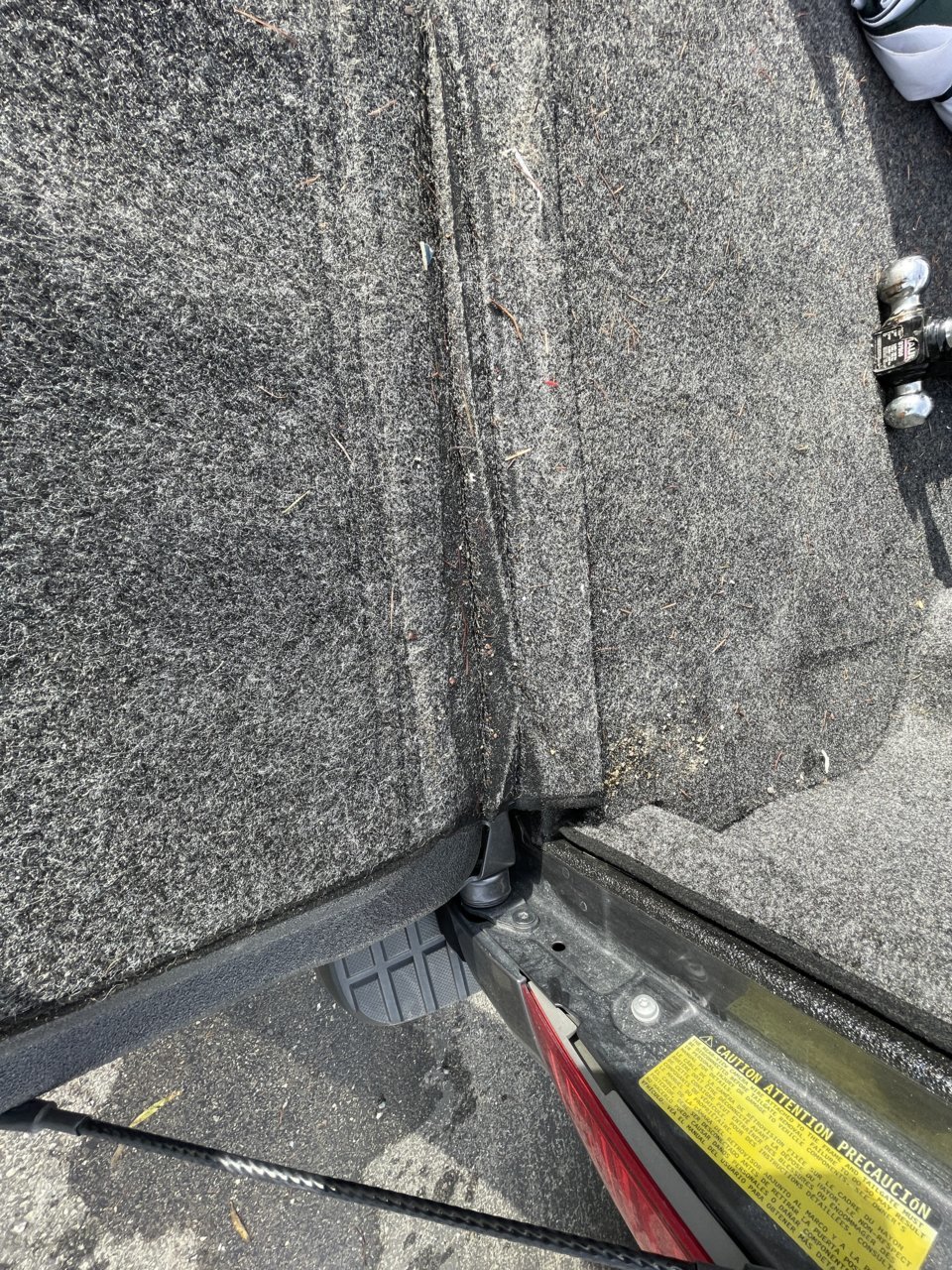

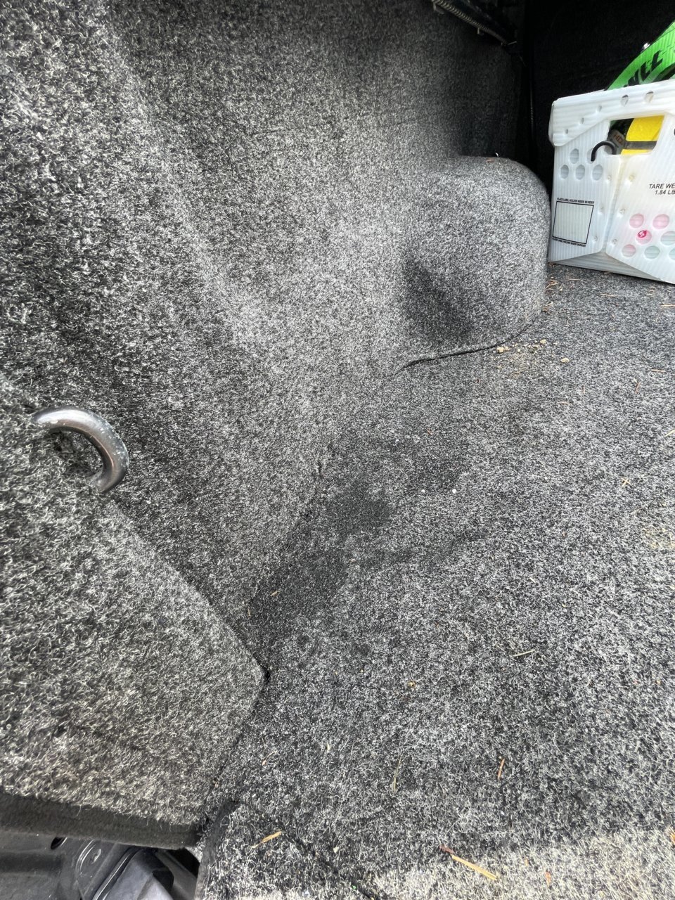

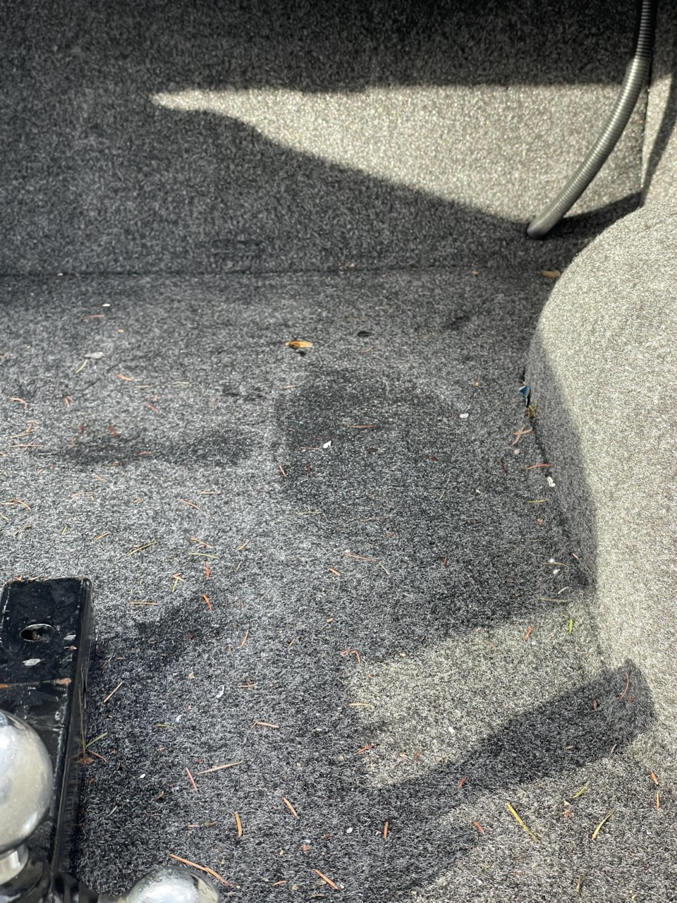

    Hmmm. Here's some photos of recent wetness. You can see the dark coloring in several spots along the sides and pretty well in from the wall. Maybe it’s just me and this is not considered much water…?
