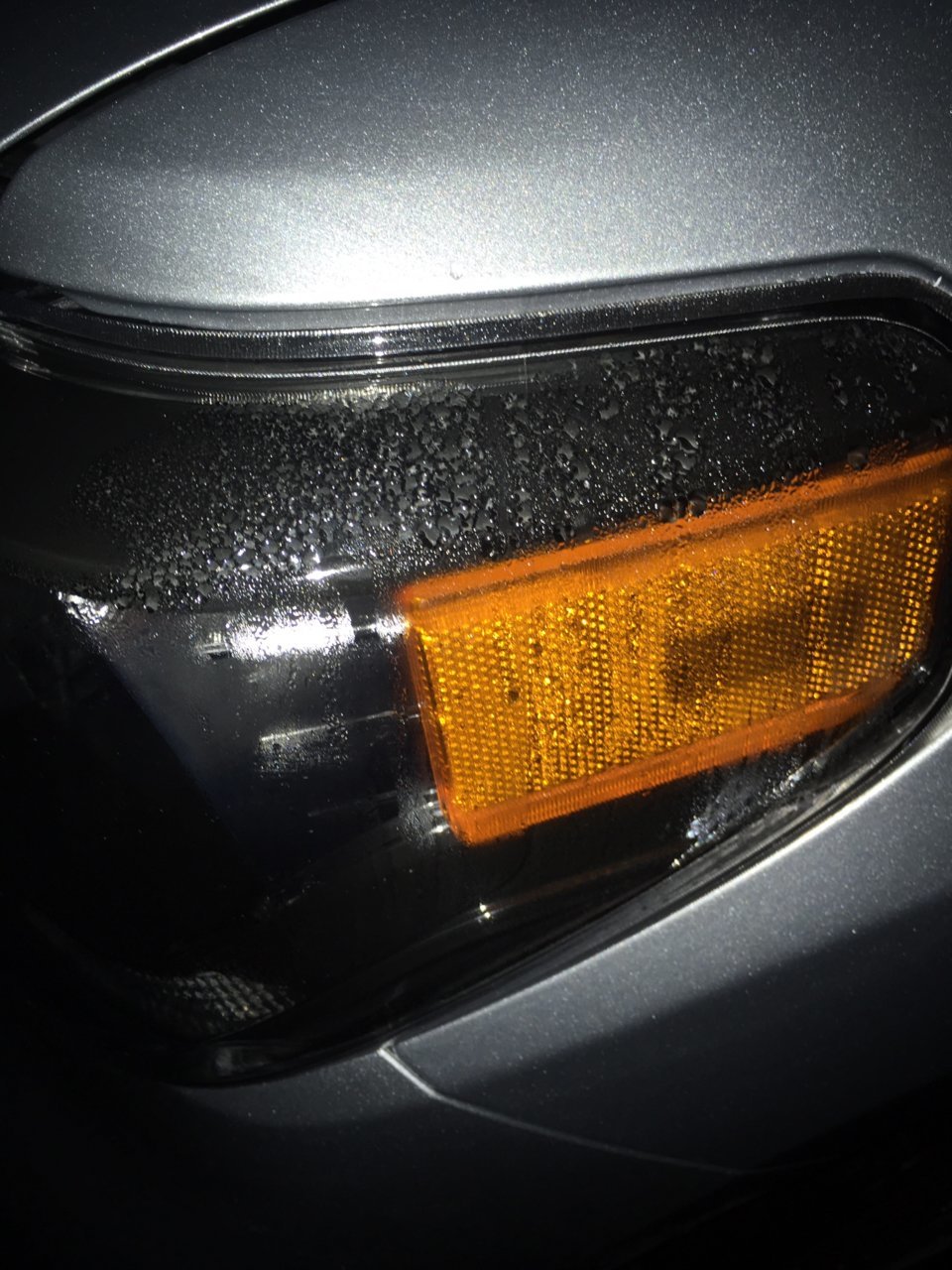

    New 2020 truck bought last month. Noticed that the drivers side headlight has water in it, not a pool but enough that there is condensation on the inside.

    Have the dealer warranty it, its covered, sometimes things dont get sealed right.

    Yes maybe has a bad seal around the headlight. Or maybe one of the bulbs is loose or was not put in all the way causing some moisture to get in.

    Stinks, but should be an easy warranty-fix. As said before only takes a small break in the seal to cause condensation in our area with the temp changes. JC, have you gone thru any automated car washes, had one headlamp that used to do so only after using car washes. Changed it out and never had the issue again.

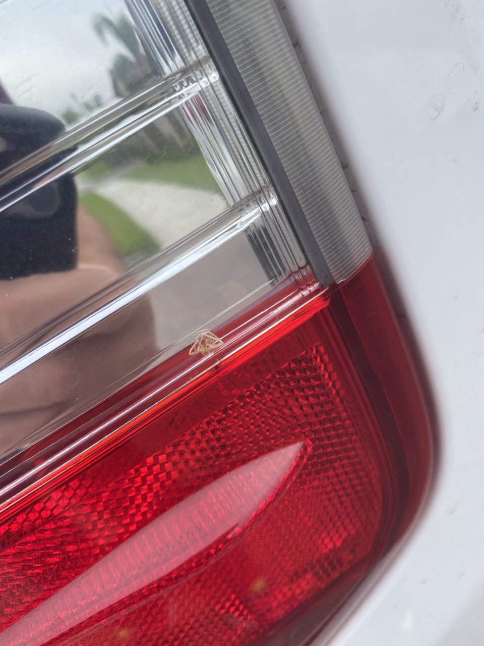

    I got a dead spider stuck in the brake light. B1396893-7CAA-436A-9916-9C03714FA3A2.jpg

    I’d rather have my spider
