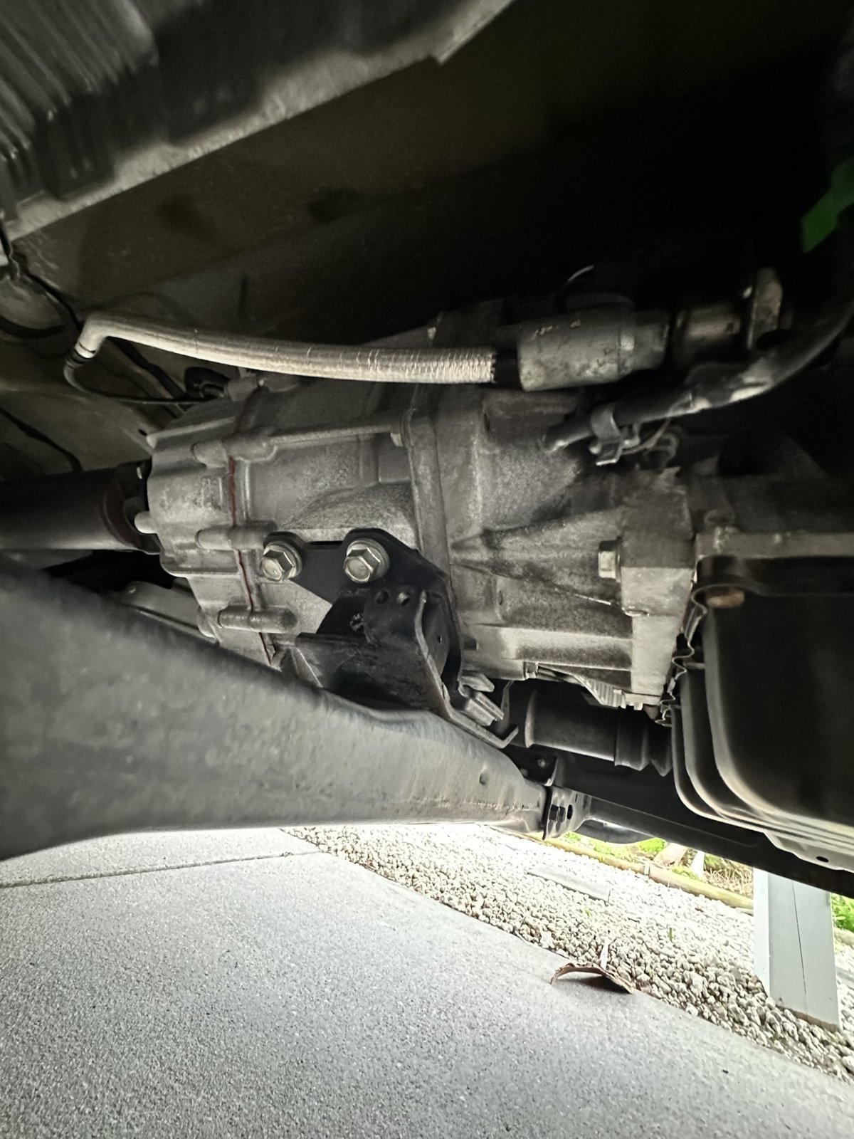

    2017 Tundra XSPX

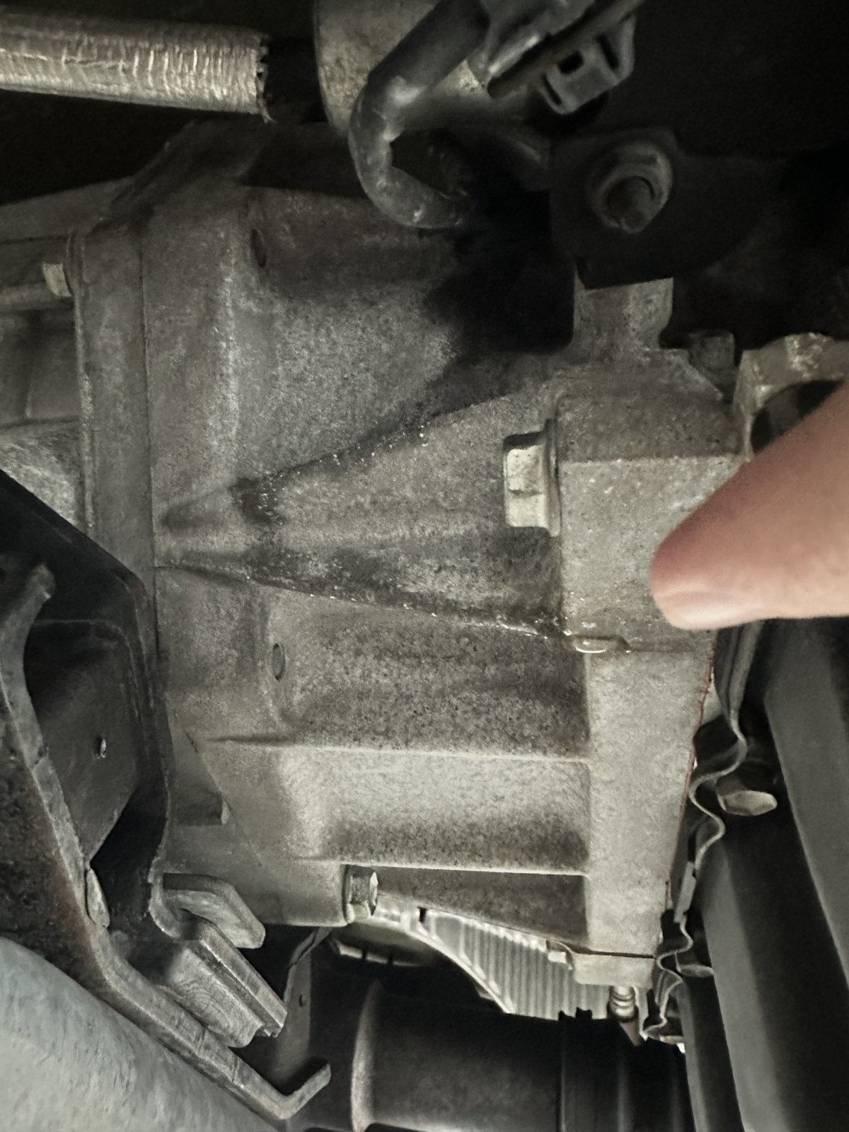

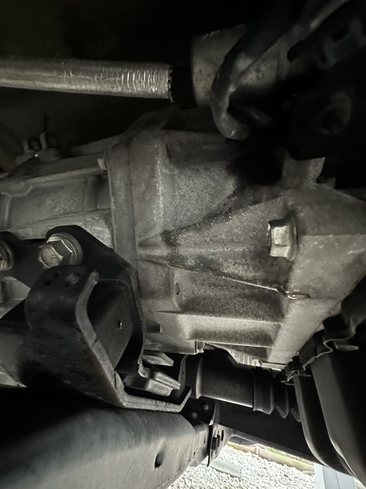

    Hi! I have a 2017 Tundra XSPX and I noticed a spot under my truck on the driveway. After further investigation I noticed what looks like water dripping from the rear part of the transmission. The liquid seems to be clear and has no smell. I’ve just never noticed this before and I haven’t driven my truck in two days. We are also having some very wet weather and humidity is in the 90% range right now. Is this normal?

    The AC drain is right above the trans.

    I would doubt it, but I also can't think of any other source of clear water from the truck. You said it's been humid and wet, maybe just dew? Just check that nothing is wet on the interior suggesting a leak maybe.

    What are your outdoor temps like during the day? If it's cold enough and humid enough to get dew, then it could just be condensation from sitting.

    If it was previously colder and your transmission was ambient temperature, that you are seeing is normal. Look at your dewpoint and my guess your transmission case temperature is at dewpoint or cooler.

    Yeah, with that being the case I'd guess it's some condensation and dew. If you can put it in a garage that blocks some of that, then you might be able to diagnose otherwise.

    It’s condensation from either the normal atmospheric conditions, or it’s the condensate from the ac system. No fluids in this truck are clear, clean water.

    If it’s not normally humid, you wouldn’t get a lot of condensate. Condensate occurs when the humidity is very high and the air is at maximum saturation. So rather than the moisture atomizing into air, it falls out into liquid form because the air can no longer absorb it. As a person who lives in a place that’s humid year round, you’de see this occurring pretty much daily if you’re using the air conditioner.

    Yes I live in Florida so it’s humid a lot… but still never really noticed this.. and this picture was taken this morning and had not used my truck for two days so didn’t think it would be a/c related

    I’m in south Louisiana, so you’re probably seeing the same humidity and mild temps we’ve had all week. Cool/moderate nights, mild rainy days. Metal holds temperature longer than the surrounding air. The metal of the motor, transmission, etc is cooling off over night, then the sun comes up and warms the air faster than the metal can warm up too, and that’s when you’ll get condensate from just normal sweating
