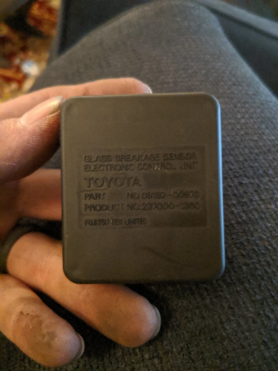

    So it's not the battery it's holding at around 12.65v. Was digging around under driver's area and found this. Is this common or is this an add on that would prevent it from starting. Today I pulled the intake off and tried grounding the starter and had no luck with that. I can't jump it because there is hardly any room to get a wire on the connection so I'm not sure what to do. This is kick me in the nuts real hard. I'm about to let it roll down the driveway and just never see it again.

    Voltage is only one part of the equation. You need to load test it also. A battery can still hold 12.5 volts and be defective. You also need to make sure the battery posts and cable terminals are cleaned with a battery cleaner and tightened with a wrench.
