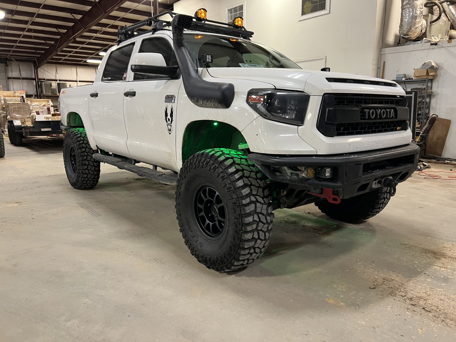

    Long time viewer, first time poster. I guess the first thing we should do here is post our build, so I'mma go ahead and do that first then.
    Truck itself is a 2018 1794 Edition, so it's packed with all the features.
    Suspension:
    7" BDS bracket lift and spindles
    40x13.50r17 Cooper STT Pros
    17x8.50 0mm Method 702 beadgrips
    Icon billet UCAs with Delta Joints
    Dirt King performance LCAs
    Custom Kings rebuilt/valved at Accutune
    700lb 18" King coil springs
    Coachbuilder TREs
    Timbren bump stops
    333 Fab cam eliminators
    Dirt King UCA double shears
    DRT fab cab mount relocates
    CVJ inner axle boots
    Ironman4x4 HD leaf packs
    Ironman4x4 greasable shackles
    Custom Kings to match the fronts
    Procomp 3" offset center lift blocks
    Archive Garage U-bolt flip kits
    Total Chaos bump can mounts
    King 2"x2" hydro bumps
    Protection:
    Ironman4x4 front bumper
    Trail Toys rear bumper
    CaliRaised trail sliders
    Valhalla's Shield trans/t-case skids
    RCI 3rd member skid
    Dobinson snorkel
    Ark splash guards
    Lights:
    Alpharex G2 headlights
    Morimoto HIDs
    HiRevSport taillights
    Diode Dynamics fogs
    Diodes/Bajas for more lighting
    Interior:
    Kenwood DMX957XR
    AJT/Meso trim pieces
    ICS dash mount
    OG Fab molle panel
    Miscellaneous:
    Wilco tiregate
    15-17 Pro Grille
    AJT sensor relocate bracket
    OTT Tuned
    SDHQ Stainless brake lines
    Badlands Apex 12K winch
    Victory4x4 bed stiffeners
    All steel driveshaft from local shop
    I'm sure I'm missing something
    Been slowly building my Tundra over the past few years, it's been through many changes and iterations since I got it stock in 2020.
    Future mods include:
    5.29 gears
    ARB lockers
    Custom leaf packs
    Custom spindles
    And of course the coveted supercharger!

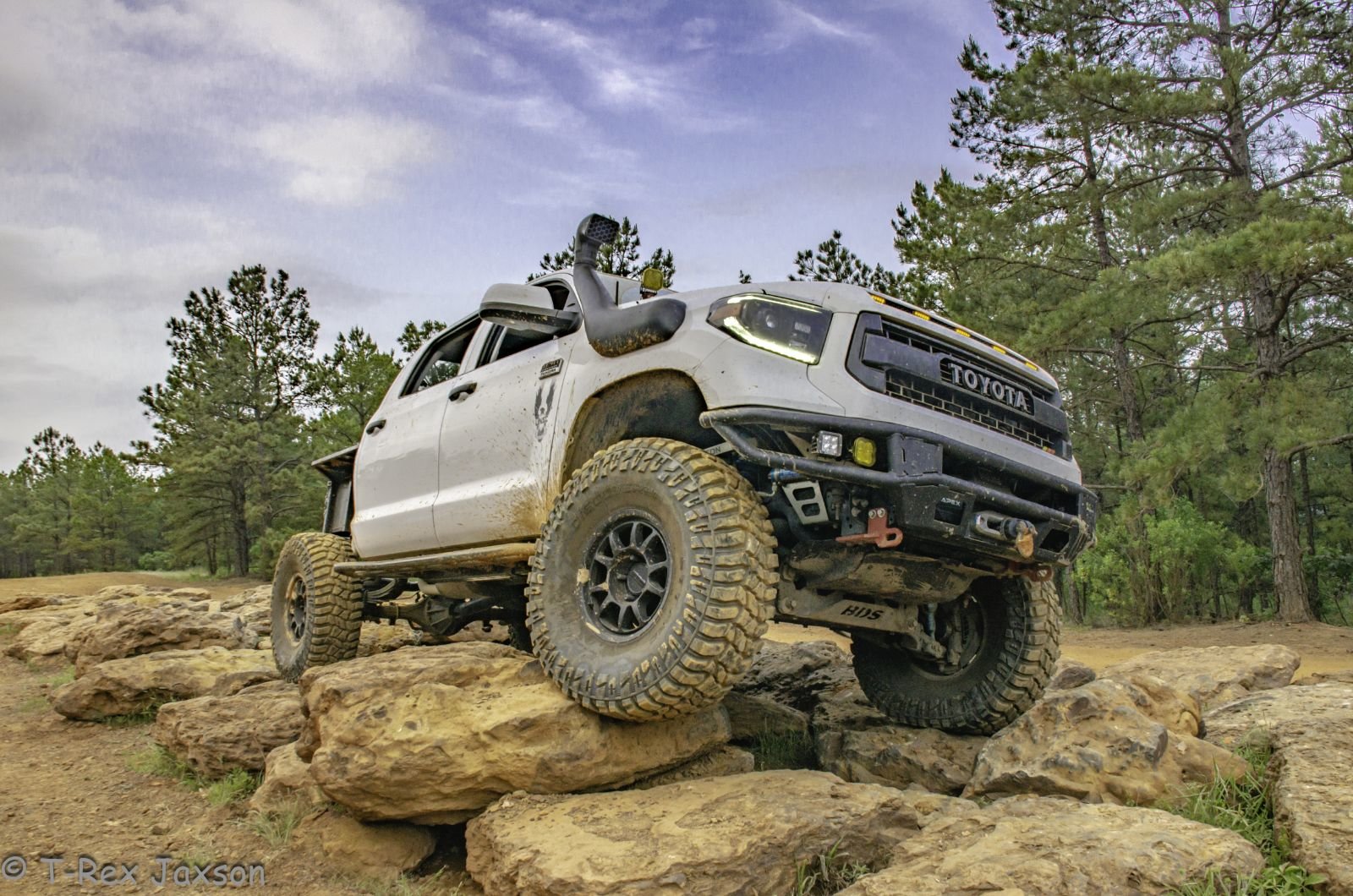

    Those new pics reminded me that I've stumbled across you on Instagram a time or two. Major props for wheelin your truck hard!

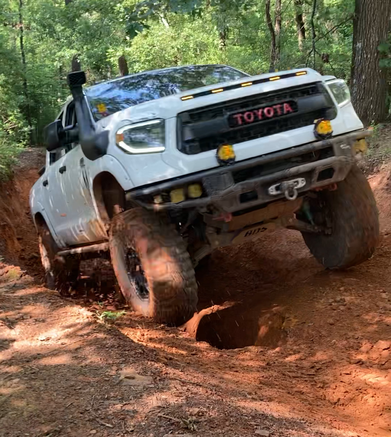

    Thanks, that last pic I was doing my best to keep up with a LT, locked, SC'd 4Runner!

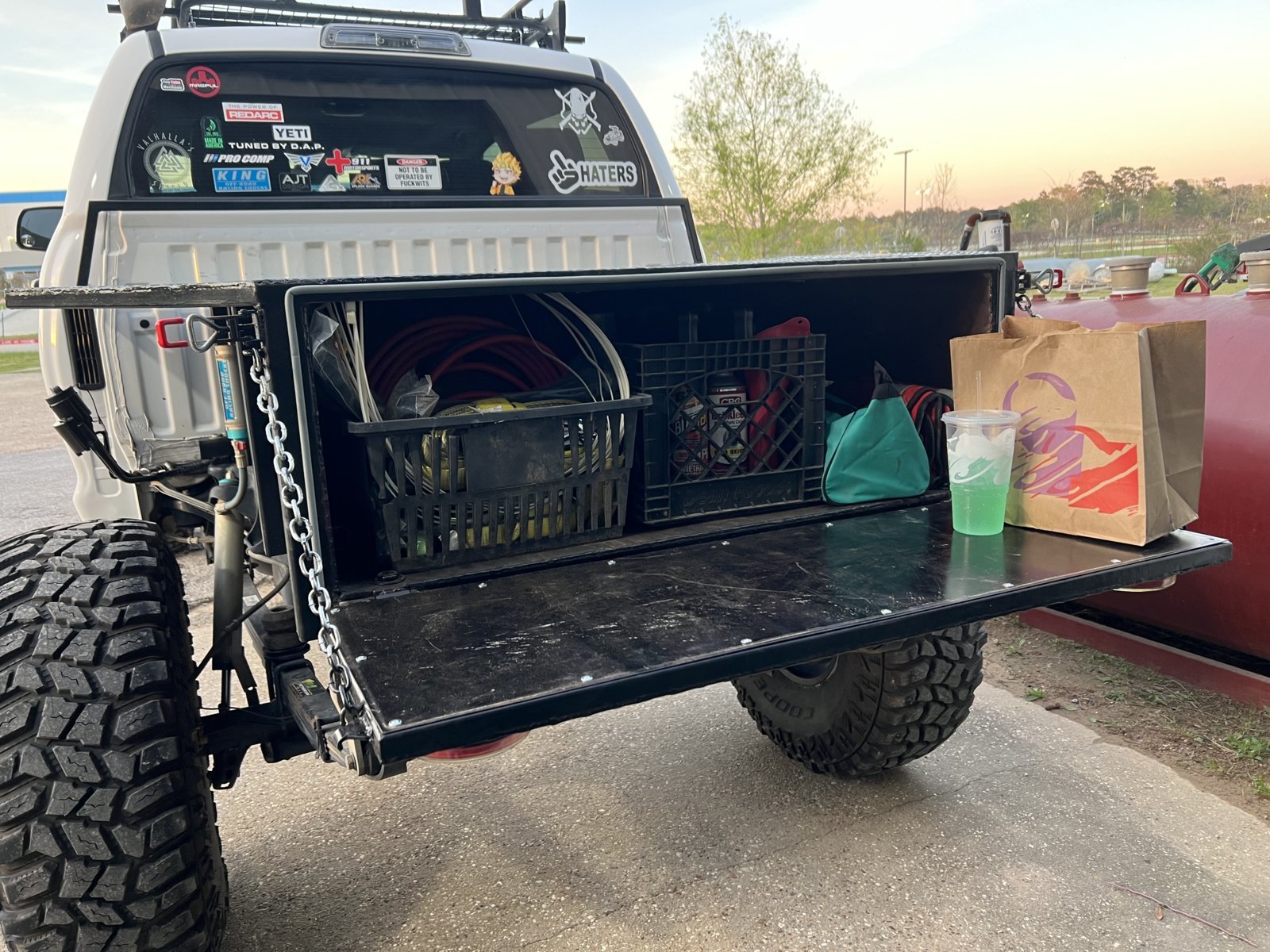

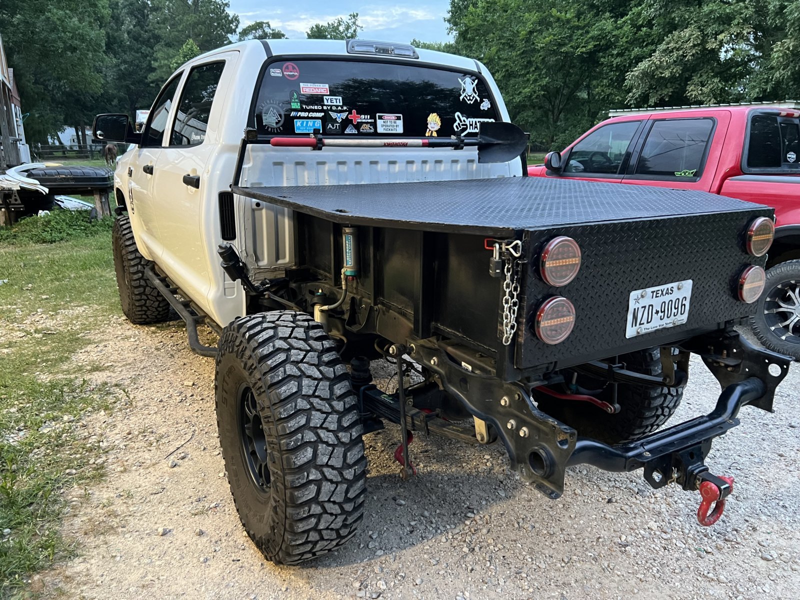

    Would love to see what’s going on here. Did you perform a bed delete mod, then put it back on?

    It was my take at a custom flatbed with dry storage built in, ended up loathing it due to the weight.
    If I were to build it again I'd do aluminum to shave a couple hundred pounds, and flesh it out so it didn't look to empty and goofy

    Now that you're not impeded by the wheel wells, you could toss on some 14" or 16" shocks and get some serious flex out of the rear end!

    With my current Kings already being custom spec for the additional lift in the rear I pull almost 18" of wheel travel. But I did think about relocating them up and doing a custom mount on the axle.

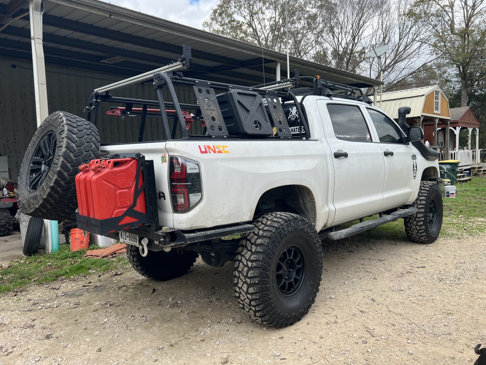

    Custom bed?

    It had one I homemade, but it wasn't my style so I went back to factory.

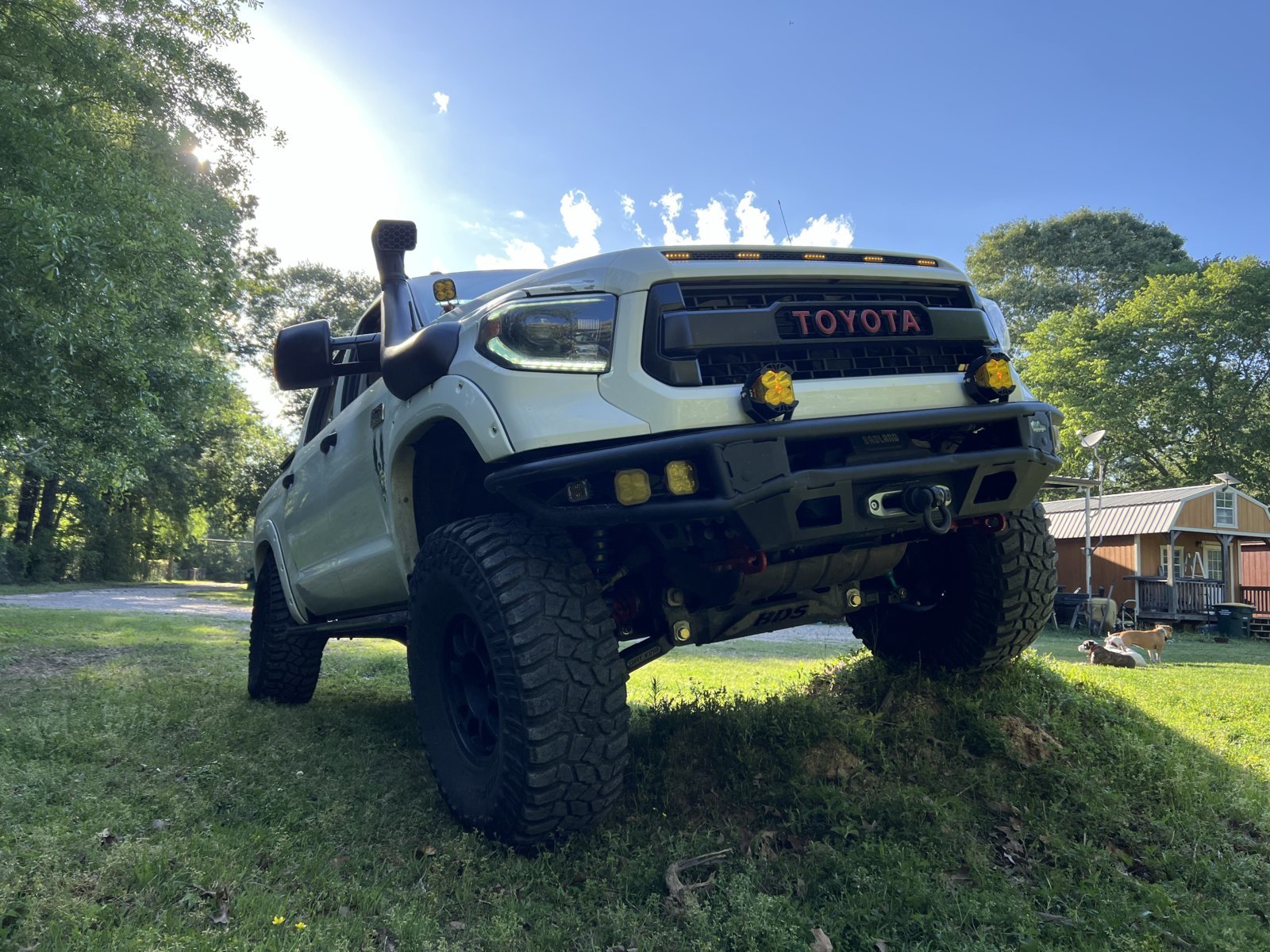

    I just ordered this bumper yesterday and this picture got me way too damn excited now haha badass truck man!
