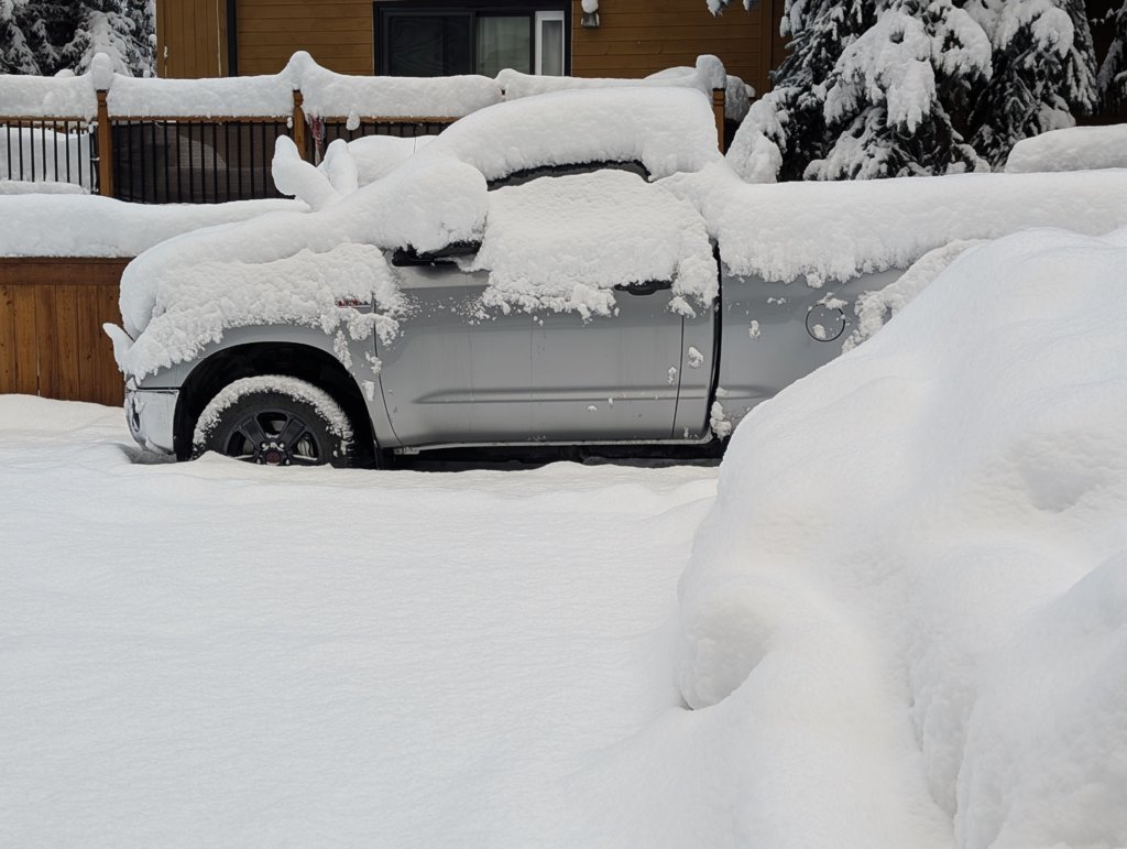

    Windshield Blanket (of snow!):rofl:

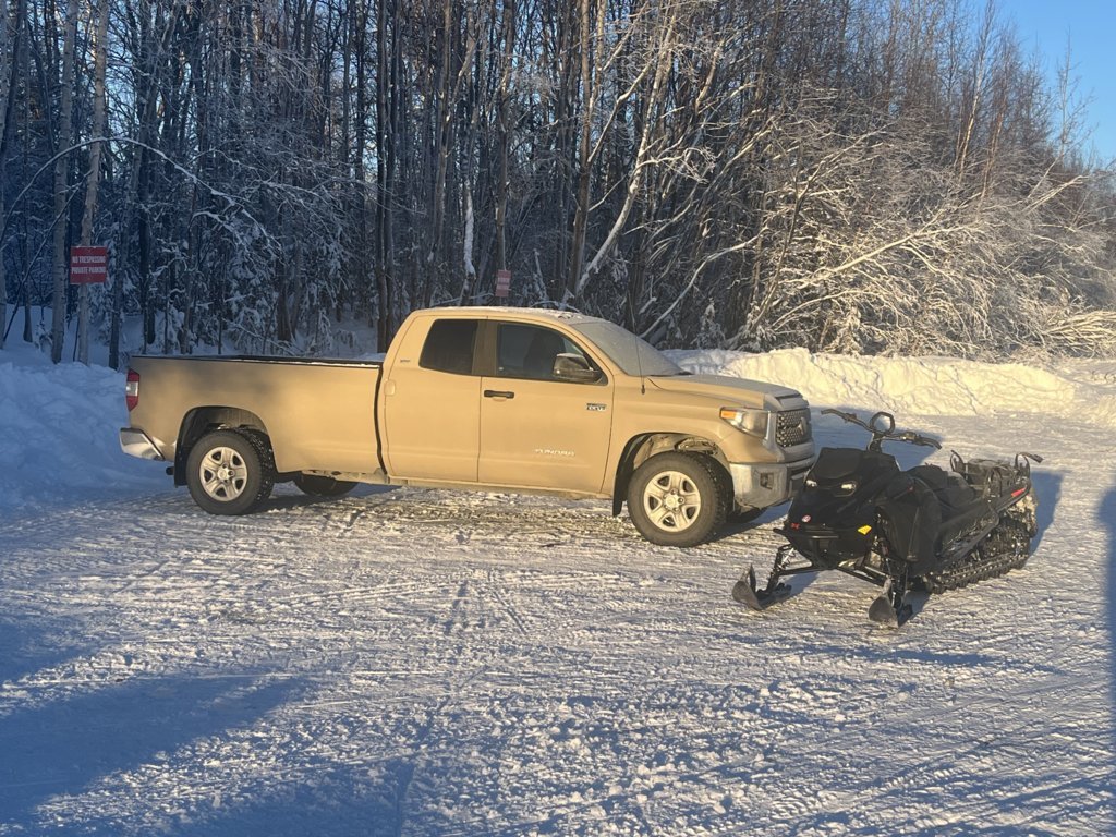

  16. Jan 4, 2025 at 9:47 AM
    akpowrider
    akpowrider New Member
    Oct 16, 2024
    #124323
    13
    2019 DCLB
    I have to park at the trailhead (at cabin). It’s been around -20F for the last week. The 5.7 warms up much faster than my Silverado. IMG_8680.jpg
