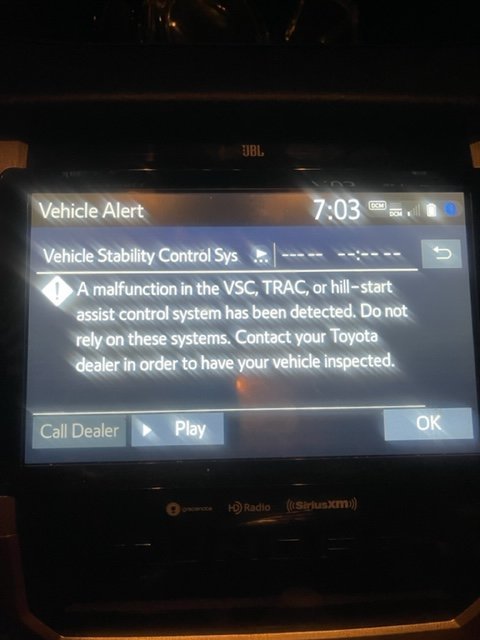

    Diamondback bed cover. Running boards. Kenwood amp with 4 memphis audio speakers in the doors!
    Anyone ever get this alert on their radio?

    S/C'd 2020 White 1794 Tundra
    uh...yes.
    When I squished the wheel sensor wire when I installed the rear sway bar.
    yes, I did that. no worries, I spliced it back & it works fine now.

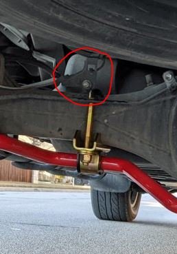

    899
    2019 Tundra TRD Pro
    Hard to see on your right tire, but the left side is installed wrong. It should be to the left of the circled bracket.

    899
    2019 Tundra TRD Pro
    Right side is on the inside of the bracket, left should be outside. It appears the right one is correct.

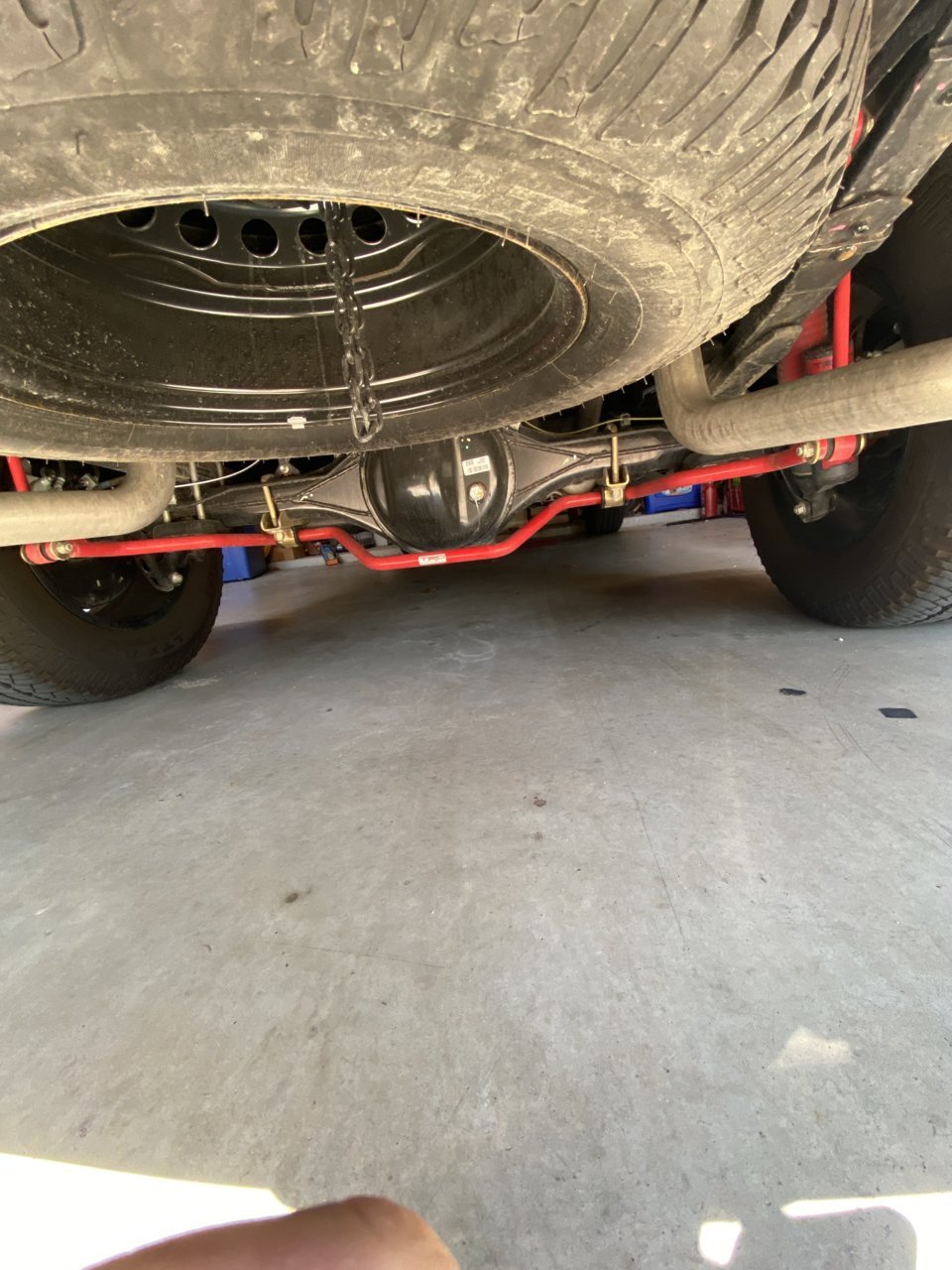

    #49702
    139
    Here is my rear sway bar. Is this installed correctly?

    899
    2019 Tundra TRD Pro
    Appears to be.
