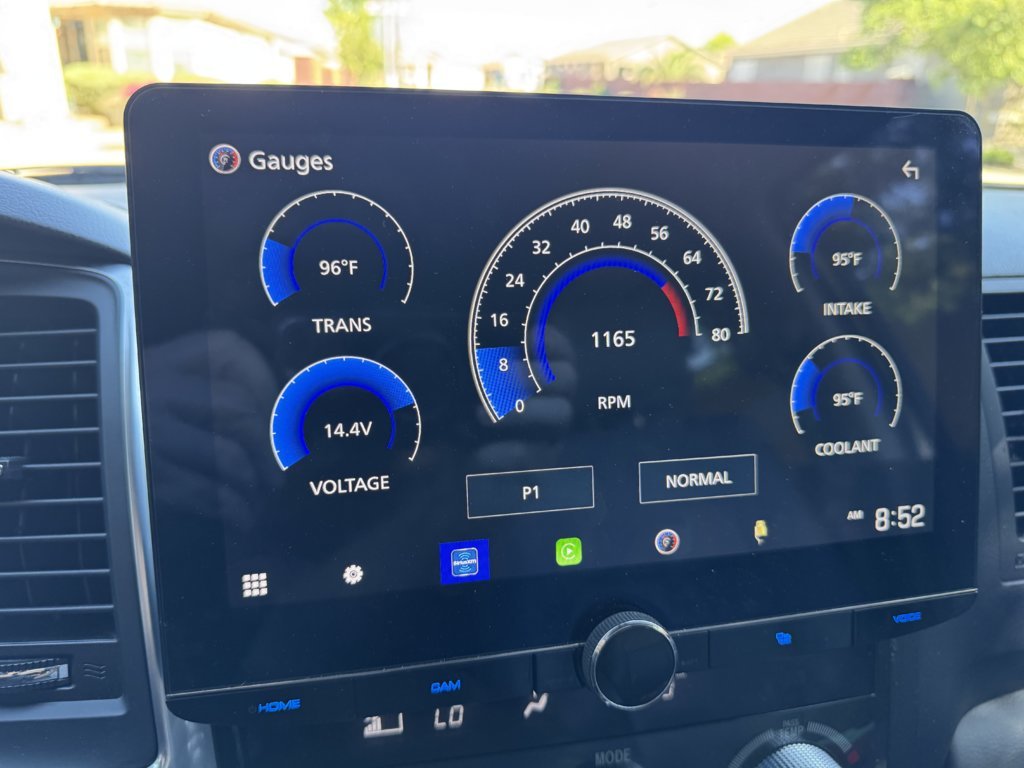

    I got the truck back with a battery light & running at 13.2-6 volts, although my Voltage Booster Pro had been running at 14.2+ From December when I got it to May when the motor died.
    I checked the grounds, verified it was in properly & then put the cheap GM Diode it replaced back. 14.+ volts.

    That’s great, the cheap GM diode from Amazon is giving 14.2-14.6, how about you keep it and return the money?
