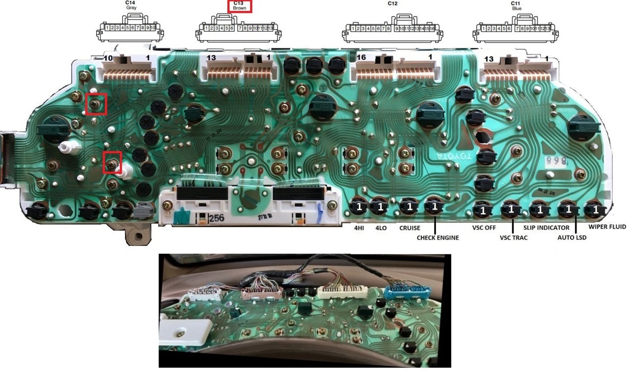

    My first suggestion would be to carefully remove the combination meter and make sure the brown connector(C13) is indeed plugged in good.

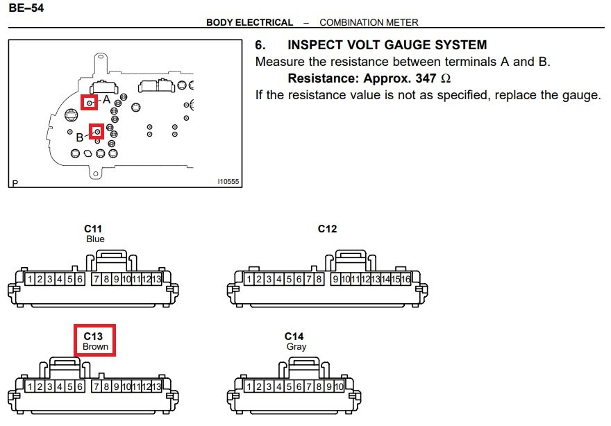

    If indeed no other gauges/indicators are malfunctioning, you might need to follow the 2002 FSM in how to check VOLT gauge resistance IF you have a VOM(volt ohm meter).

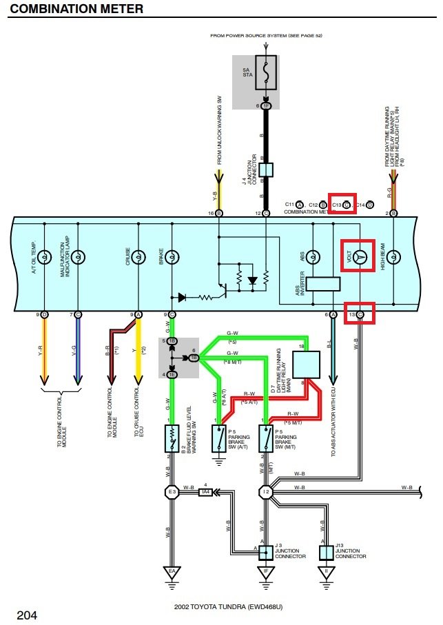

    The below pics came from the 2002 FSM and EWD....

    Also, the 2002 EWD(electrical wiring diagram) can be downloaded from Tundras.Com compliments of @RainMan_PNW if you needed it.

    I took the gauges out and tested the resistance. On my POS meter, I get 490 ohms, so I’m guessing my gauge is bad. Just for grins I cleaned the contacts with a q-tip and rubbing alcohol. Still no voltage at the gauge so I guess I need to look for another cluster.

    Yes, you would need all 4 cables undone so as not to induce ground or voltage. I have never needed to check mine to see if "Approx. 347" ohms that the FSM mentions is accurate but 490 ohms tells me meter is not totally open. I can measure mine sometime tomorrow AM if that will help.

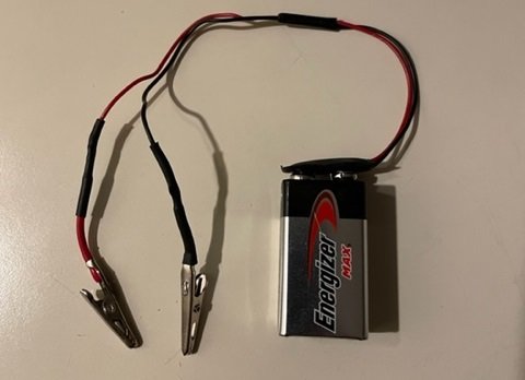

    I'll also offer another way to test and that's by applying voltage to the same 2 screws you tested for an ohm reading. I have the below in my arsenal just for matters such as this....9 volt transistor battery. Of course this is best done preferably on work bench or at least with all 4 cables unplugged.

    Thanks Bubba. I think I’ll rig up a battery tester like you have to see if the needle moves
