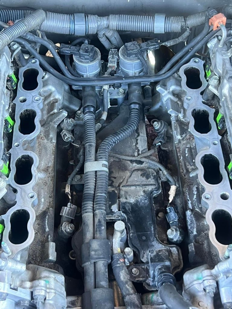

    I’ve been trying to voice my concerns these last few weeks with my truck. Ever since the dealer has did my timing cover reseal, I’ve been having a few issues. One, they didn’t put some things back on correctly. There were missing bolts and the dipstick thing was loose. Most of that weird tick noise is gone now. I had 2 different mechanics resolve most of that. They checked my timing and put new tensioners, guides, and apparently the chains were still fine. I was willing to pay someone else to do it right and would rather not go to the dealership for anything else. They cause unnecessary issues and create new problems that weren’t there before. The dealer faulty work caused it to have a vacuum leak (running a bit lean based on fuel trims). Air cleaner hose and breather hoses were loose. Also I needed to have intake manifold gaskets (which they supposedly replaced but seemed like they didn’t). I’m always left with a feeling of uncertainty. I’m keeping a close eye on my fuel trims. It has came down some but still looks a bit high to me.

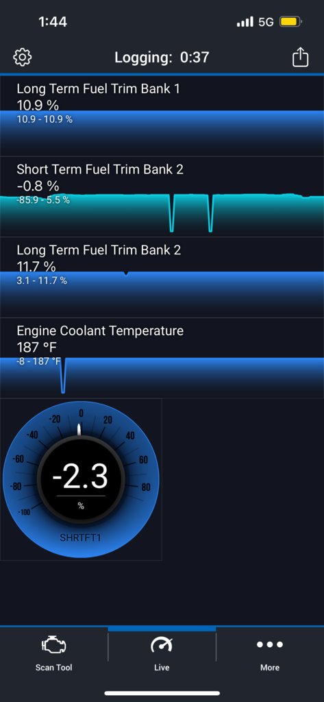

    Wow. You are running pretty rich. 12:1 if at full load and 14.7:1 is optimal for cruising.
    Take it back. Make them do the work you paid good money for. This lack of craftsmanship is what gets technicians fired.

    I feel like I was better off not even taking my truck there for the timing cover reseal. It’s not like I was loosing any noticeable amount of oil. Had to be a very small leak if that. I got suckered into believing I need to get it done right away all while paying for poor quality work.

    10 is right at the end of the acceptable range. Need way more data to know if you have an issue. FYI, the term for long term is seconds/minuites, not days, so you need to collect a lot more data to determine if you have an issue or what that issue may be. You can see the LTFT bounce around as you drive.

    What other data should I look at? Earlier, I did the rev test, looking at rpm’s and seeing what the fuel trims are doing. The LTFT, which is slightly higher than +10%, goes down some when I rev it and returns to a little above +10 when it’s just idling. I did have a vacuum leak and the guy that fixed it was telling me it should take a couple of drive cycles for it to relearn and optimize the fuel trims. Seemed like he resetted everything, my gas mileage needs to go back to up. Before he even did that the LTFT was above +25% and the cel was on for that. I’m slowly noticing improvements since then.

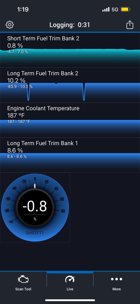

    This is where my fuel trims were at after a driving around for a bit. I appreciate your knowledge, it seems that the people that worked on my truck aren’t competent enough to pinpoint a problem nor understand how things work. Disregard that high negative value -85.9 that is has on the range for LTFT bank2 (there’s no way it was that value)

    8 and 10 for ltft is considered acceptable. These change constantly, so best to observr them while driving. You should not drive THEN observe. You want to be looking at STFT in all sortsd of different driving conditions and see what it does. You want to know when it diverges from 0 and by how much. If it is always bouncing around between -5 and 10, then you have no major issues. As long as it stays below 10, must mechanics wont bother diagnosing further.

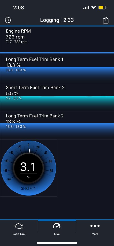

    Ok, so I drove and had the live data run while driving. While driving my LTFT are normal but at idle it’s a bit higher than normal. At idle I saw 11.7% for bank 1 and 13.3% for bank 2. Would that be problematic? Otherwise the truck is driving fine.

    I wouldn't call it problematic, but it does suggest a small vacuum leak or leakage in intake pipping downstream of the MAF. Vacuum is strongest at idle, so ruuning lean only at idle is indicative of a leak.

    Sorry, I was too quick with my response last time. Total FT= LTFT + STFT at any given moment.. So, your total trim at idle is 19. That indicates a lean condition. If this lean condition gets better (i.e. lower total FT) off idle, it is probably a vac leak. If the same or worse off idle, it is probably a different cause. there are many things that can cause a lean condition. sorry, but this is not something easilly diagnosed over the internet.
    best way to find a vac leak is spraying carb cleaner anywhere near a potential leak source. given that the trims have enough control to get a good AFR, this leak is not likely your source of poor running, but that is a generalization.
