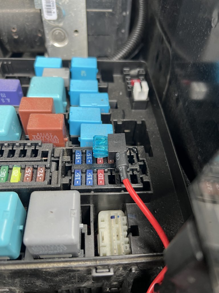

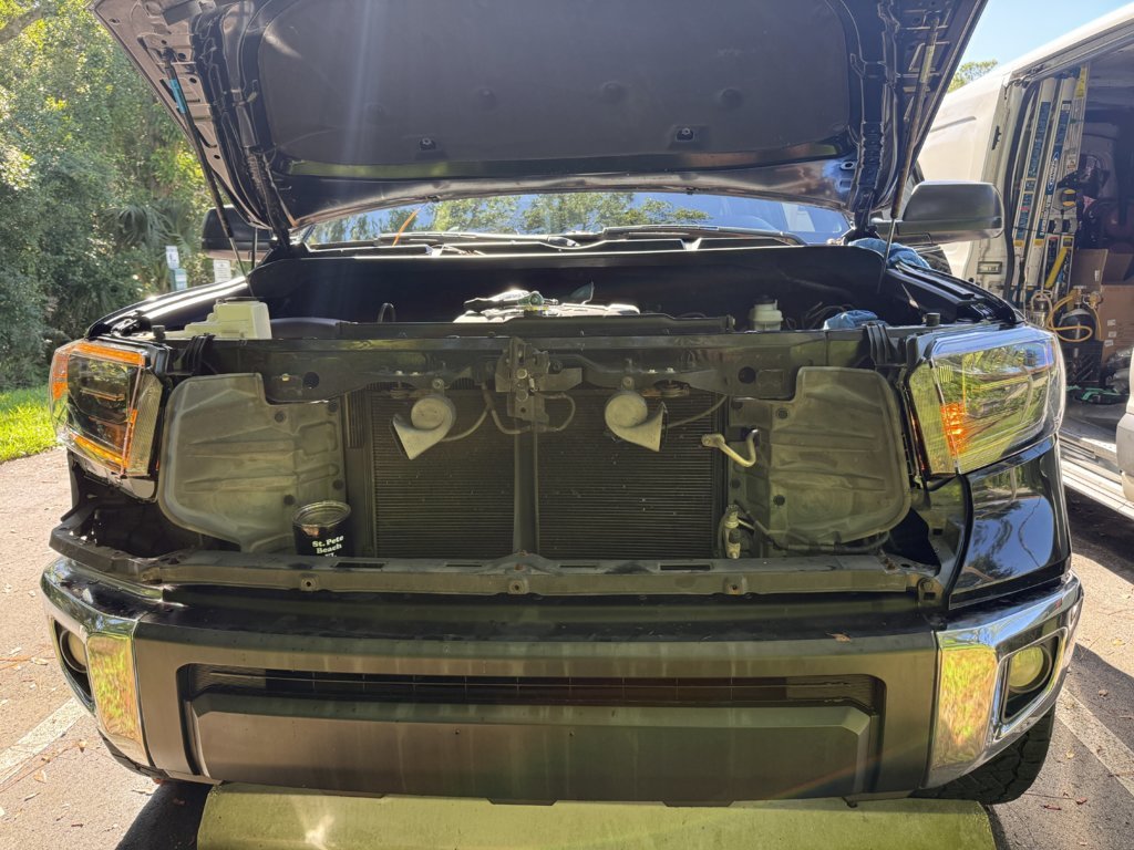

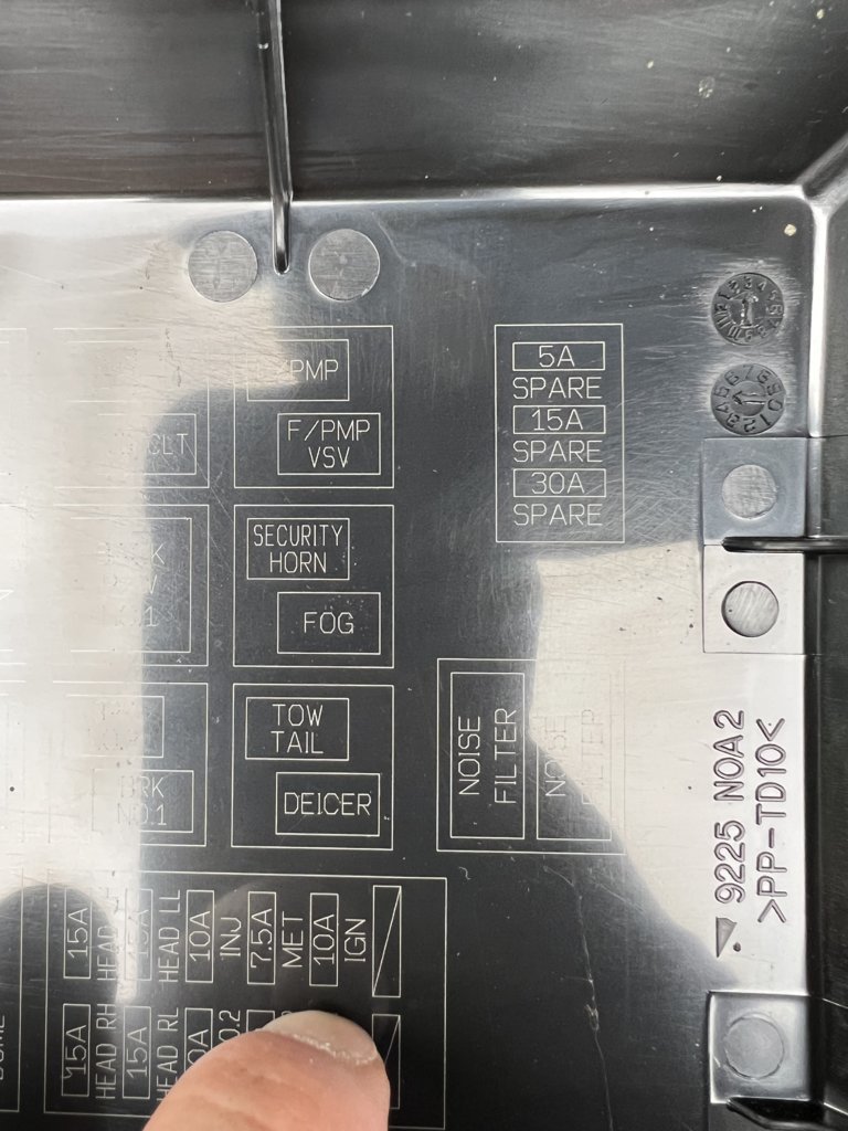

    Thanks for all the info here. It helped quite a bit to sort things out. I just installed the vlands on my 2018 SR5. I used the wire harness witth the additional wire going into the fuse box for the DRL ( 2014 spec ). I didnt change my fog lamps and just popped Sealight LED's in. Lets see how much this improves visibility compared to the mediocre OEM headlight output at night.
