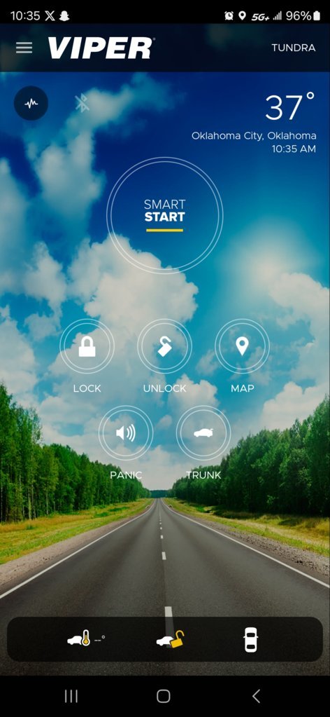

    Red... You maybe right... this whole ordeal seems like it started after I mistakingly pushed the panic button in my app for my remote start - this happened the day i dropped it at the body shop....
    I dont have the viper fob - i just have an app on my phone and originally my factory fob worked with the remote start ( click lock 3 times would trigger the remote start ) I wounder if somehow when I hit panic - if I put the truck in some kinda lockdown mode..... I remember the shop calling and saying the truck wouldn't start and when I opened the app the ( panic icon was flashing )
    Thanks for letting me know about the issue you have - it seems like that is also the same issue I'm having.... it's hard to tell since the truck is not with me. Appreciate you bud.
