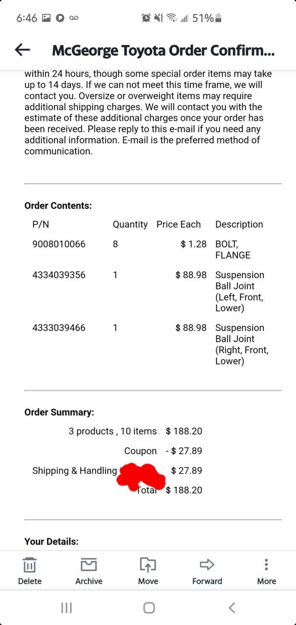

    So taking another drive, the shuddering does seem to actually be coming from the rear, so I'll probably just get the drums turned.
    Now that that's out of the way for now, any ideas on the clunk?
    Also, anyone know a good LBJ? I need to replace my passenger side and don't want to get crap that I'll have to replace in another 6 months.

    I wouldn’t bother turning the drums based on what I’ve read here. Go OEM and be done with it. OEM for the LBJ as well. Aftermarket parts are almost all cheap chineesium these days.

    As other members have stated go with OEM on the LBJ. Stevinson Toyota out here in Golden Colo is having a 10% off parts plus free shipping on orders over $75. https://parts.stevinsontoyotawest.com

    Here are the LBJ part numbers for my 01 4x4 AC I believe yours are the same. Bolt part numbers in there as well. Usually good to replace bolts too. OEM parts for LBJ only.
    You'll need an allignment afterwords so good time to knock out any other front end stuff while you're there.
