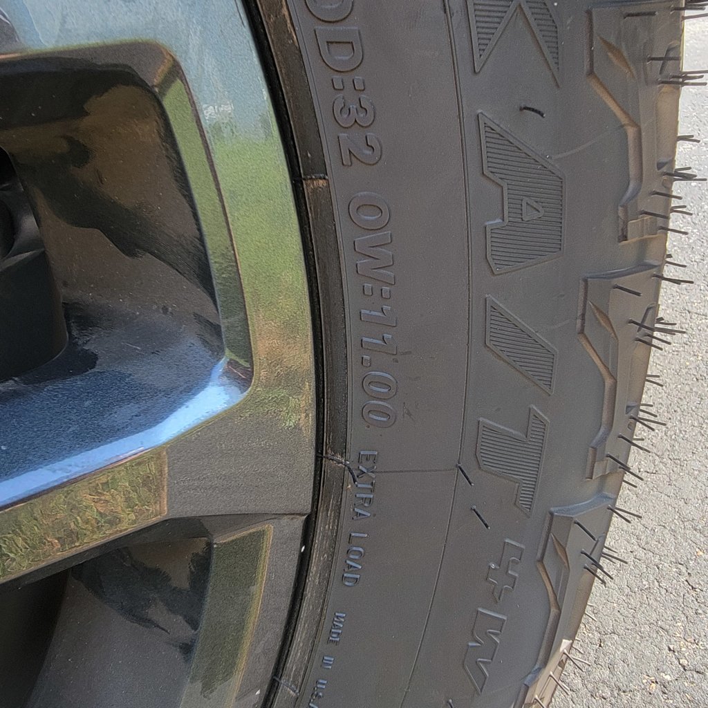

    XL no way I would run a E load tire.... too ruff for this old guy. Less than 100 miles.
