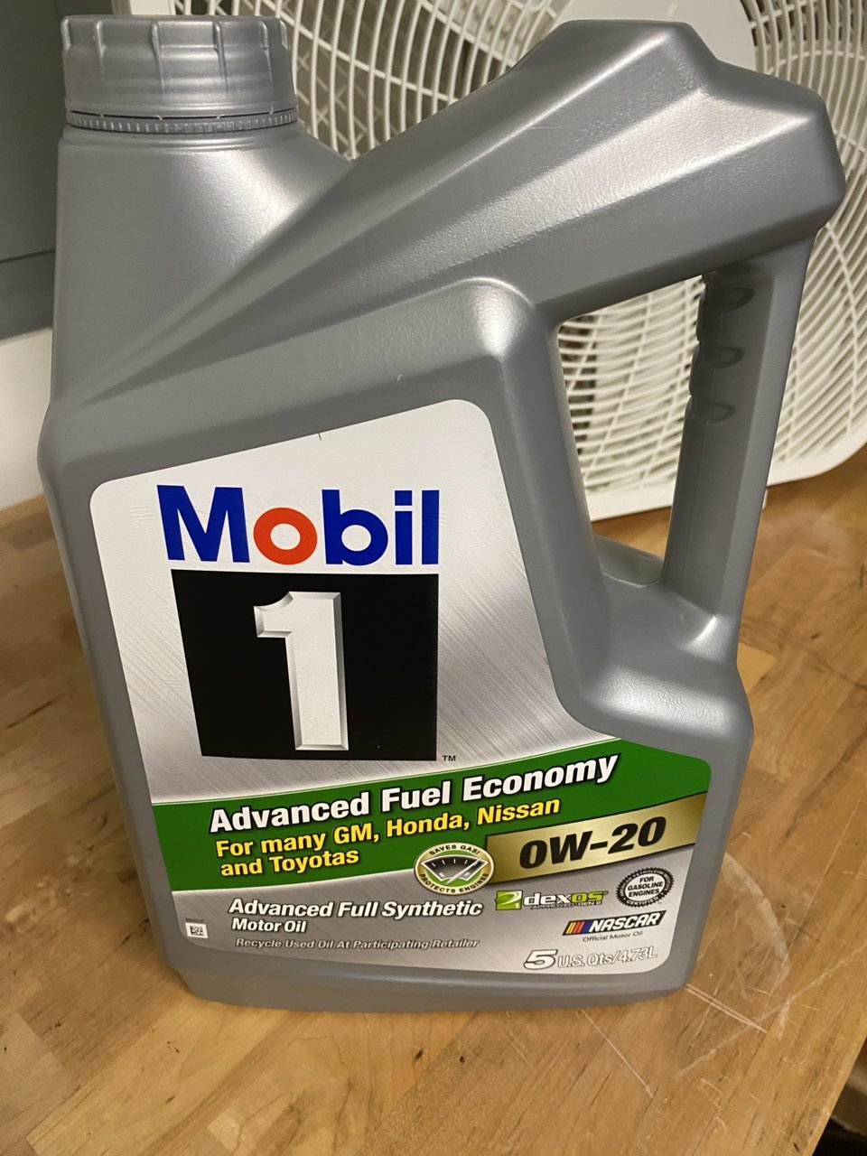

    yes, 0W20. i use mobile 1 full synthetic, specially formulated for toyota.
    there are more than plenty of threads around here regarding oil for your reading pleasure. i choose not to overthink it and stick w/ mobile 1

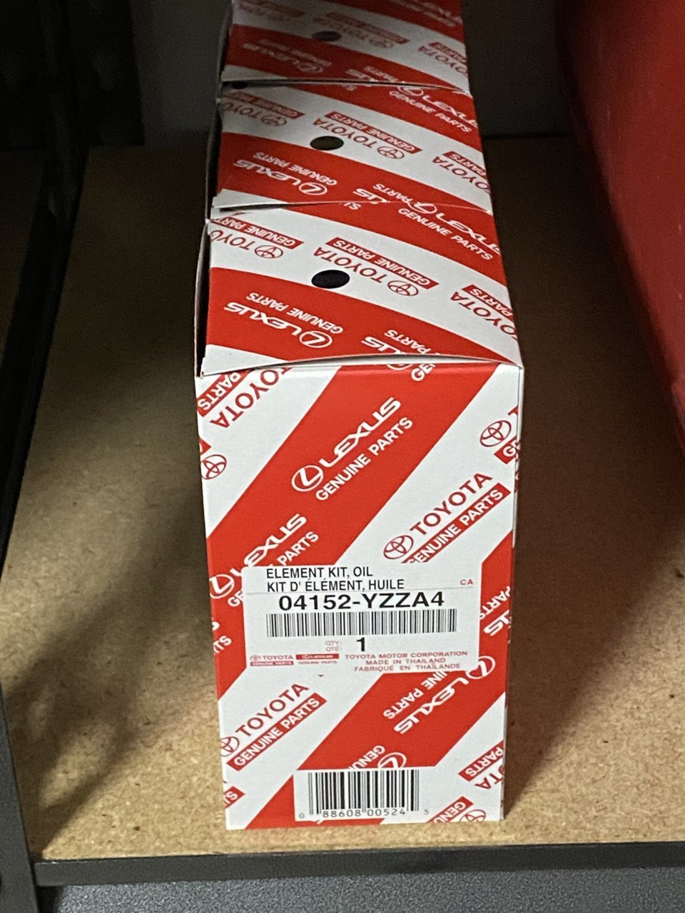

    filter is cartridge style and you'll only replace the element. filter is behind splash guard / skid. element part # for a 2019 5.7 liter is 04152-YZZA4. i get them from the dealer and usually buy 5 or 6 at a time; they're under $5 ea
