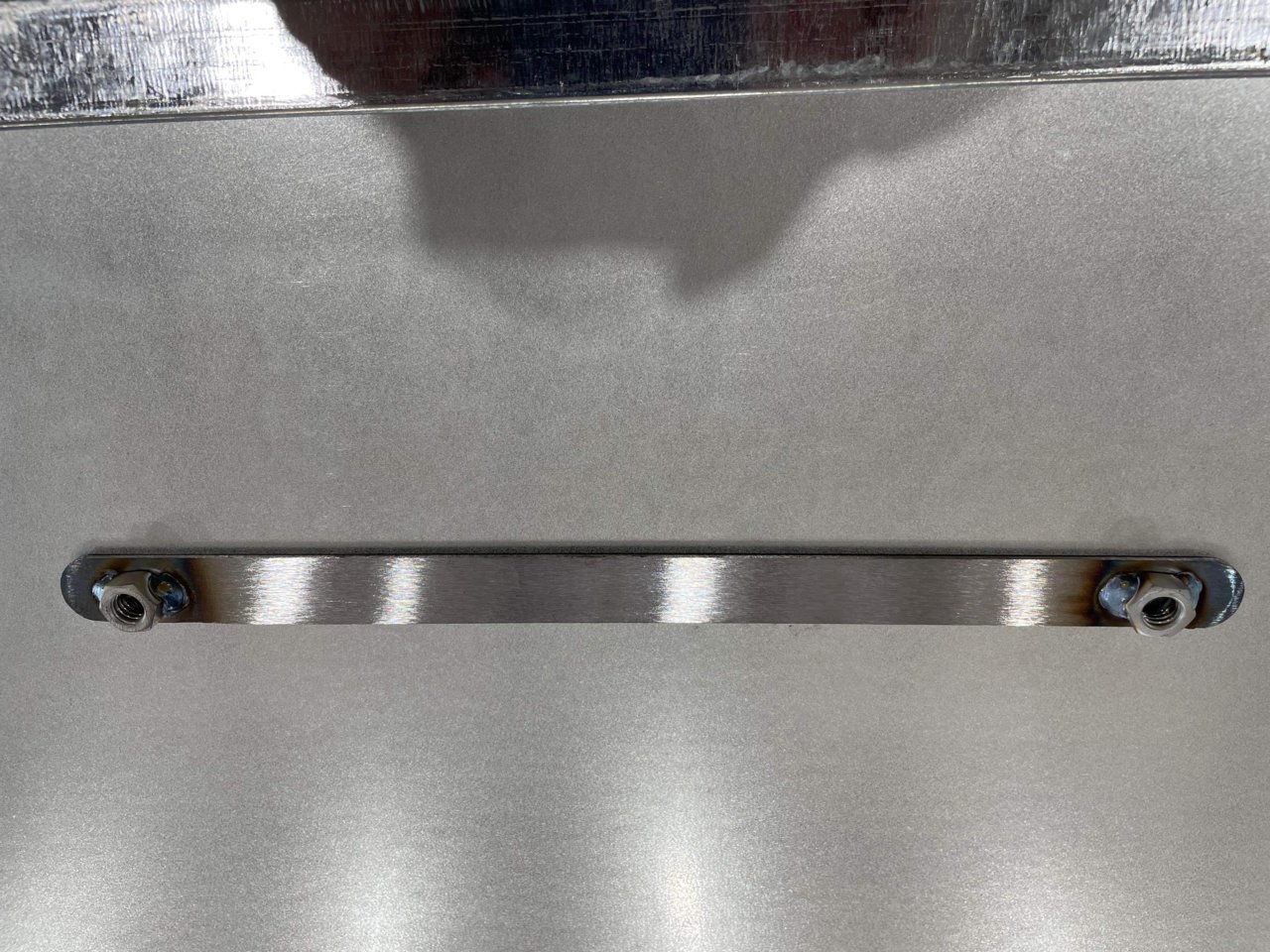

    Good news, the new nut plates are made, they are shipping tomorrow and I will have them Friday. These are much more professional and we won’t have the same issues again. The thing about the nut plates is they were never a planned item, so it wasn’t something I thought to have produced like this. It is just one more thing I won’t have to take care of so I can spend more time shipping.

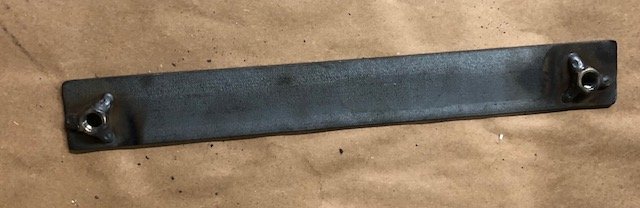

    The nut plates are hit or miss, check them against the front cat plate, if it fits in the slots, you are good, if it is wide, lemme know and I will send you a new one

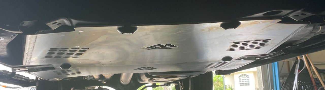

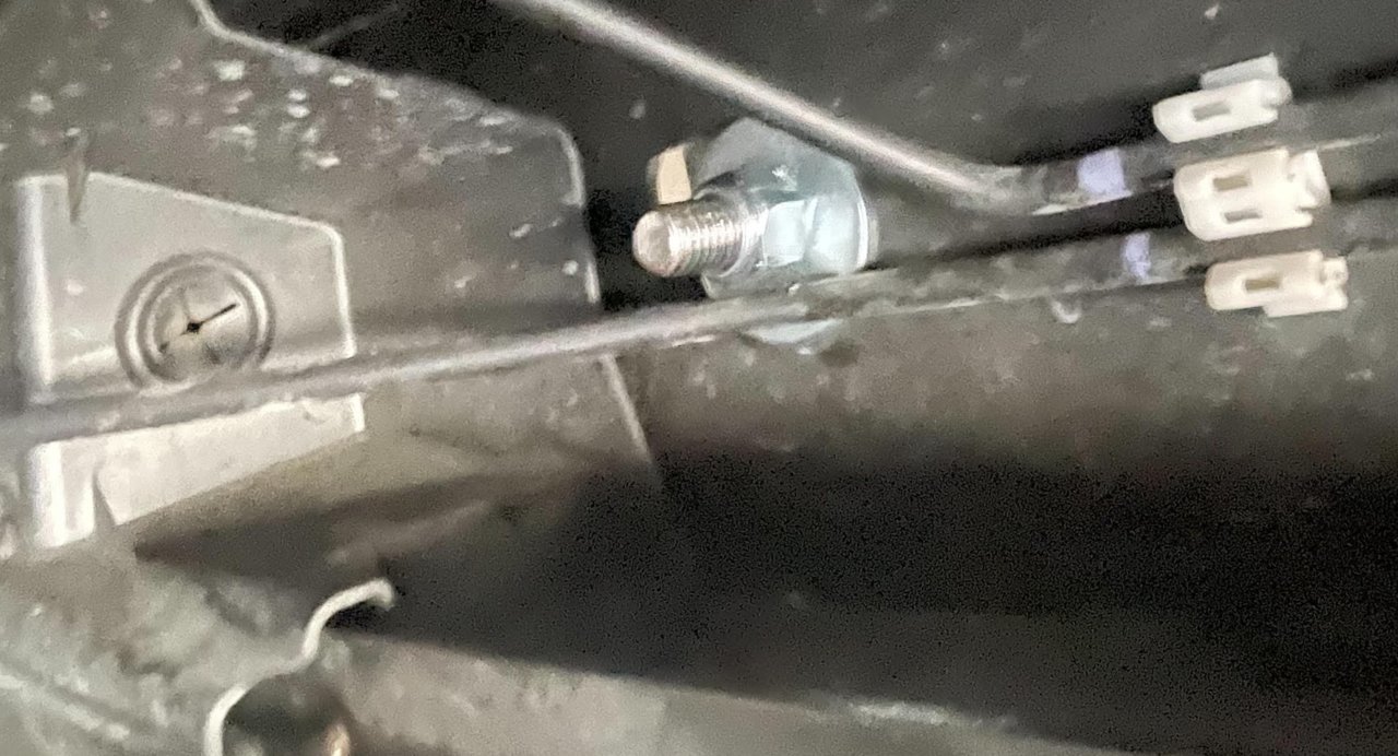

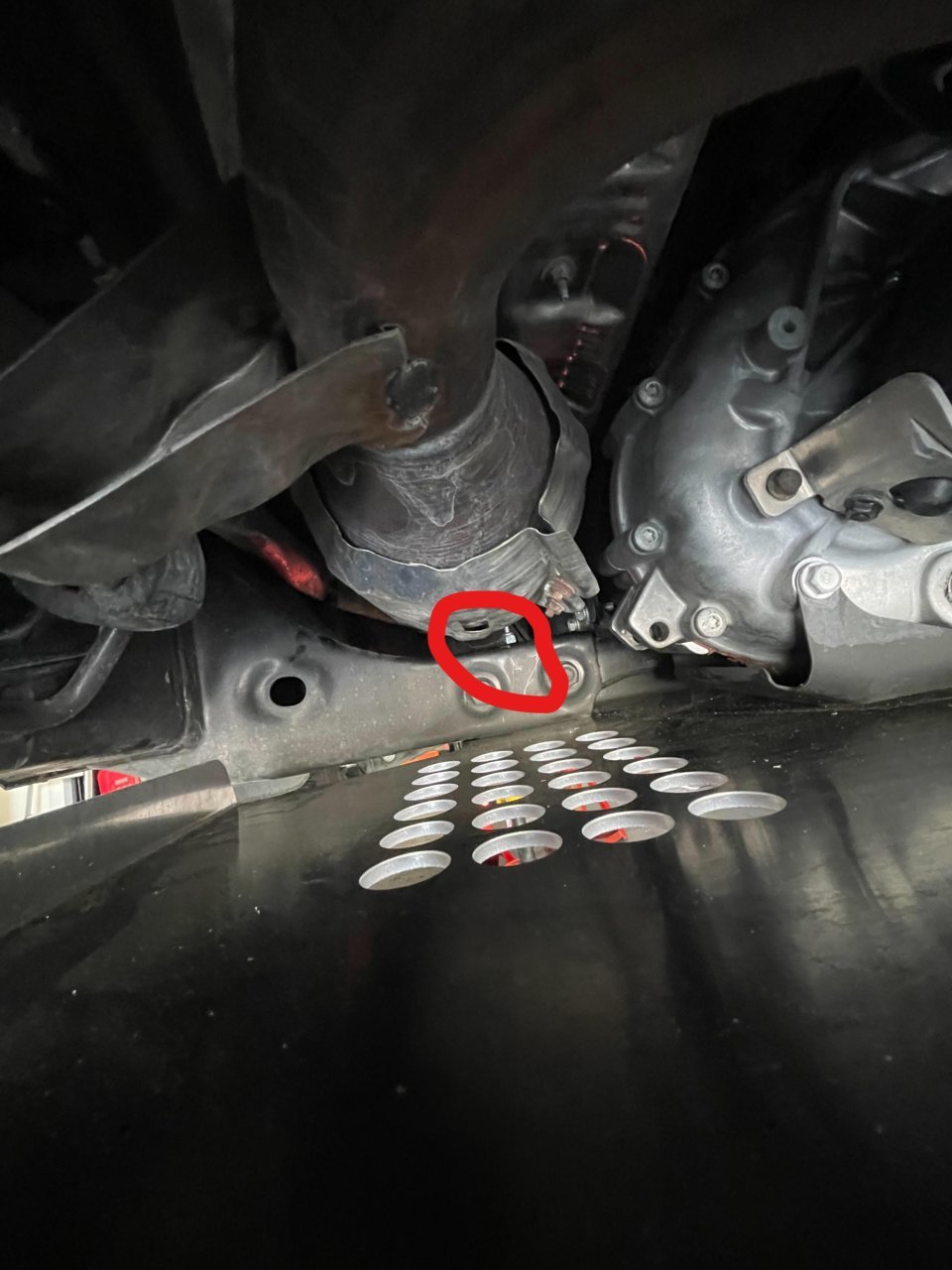

    Installed mine today. For those that ask; Ordered 2/15, and received 5/25 Bare Aluminum.
    I ordered the Penta Bolts and the skid buttons for the bolt heads.
    A few changes from the installation instructions on Tyler's web page:
    1) With the Penta Bolts, you only need two box wrenches; 3/4 and 9/16. One 1/2 inch ratchet for the Penta socket and 3 /4 long socket for the passenger side Z Bracket top nut.
    2) The 9/16 nuts by the rear cats are the worst of the whole job. Getting a long 9/16 box wrench on them is a challenge, but doable.
    3) Follow the mockup procedures in order and the plates will hang in place while you work on them. All 6 rear bolts are accessible from the rear of the truck over the plates.
    4) The nut on the rear passenger side top plate for the Z Bracket does need some patience and a 3/4 long socket will be your friend to avoid damage to the brake lines near your nut.
    Took my time and gave myself some room with jack stands, and took just under an hour for front and rear plates. Could install next time in half the time.
    Here are some pics.
    Randy
    Rear small nut.jpg Rear Small Nut on cross member Pass side top nut Z Bracket.jpg Passenger Top Side nut near brake lines Shield 10.jpg Completed front and rear

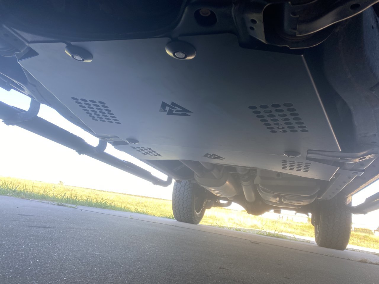

    I picked mine up from Tyler today. Drove home and installed it all.
    Reviewed the installation instructions, drove my truck up onto some Rhino ramps, grabbed my tools and my creeper, and I went at it. Start to finish, it took me about 1.75 hours doing it alone. Put the Z brackets on first, loosely. Then I did the front bolts for the front plate. I put the front plate on my chest and rolled under the truck with it. Slipped it place, then put in the rear bolts for the front plate leaving enough room to slide the rear plate in. I put the rear plate on my chest and rolled under the truck with it. Slid the rear plate up under the front plate, then put in the blots to fasten it to the Z brackets. Starting at the front and working my way back, I tightened everything up while making sure everything stayed in position while I did it. Then I took the truck for a spin. No rattles, no vibrations. It turned out very well.
    Tyler’s work is fantastic. These are well finished pieces with no sharp or rough edges. The powder coating was great and very consistent. Everything lined up flawlessly. Very well made, and well worth the wait (though I wished that I had ordered much earlier and saved myself a lot of anxiety parking just about anywhere in the city).
    I used the RockHard domes, and there was a bit of a learning curve when it came to keeping the Pentabolt socket on the bolt head once I started tightening things up. While not a difficult install, getting the wrenches on the nuts and working the bolts was tedious enough to seriously deter a would-be thief from trying to remove them to get to my cats.

    Looks like you left the small skid plate on the transfer case. Not an issue if you don't get any vibration. Not sure if there has been a design change that allows the transfer plate skid to be left on.

    I tested yesterday and this morning already, zero vibration. Perhaps the Aluminum doesn't carry the vibration issues as much as steel would? There is clearance between the two though. At least 1/4 inch.
