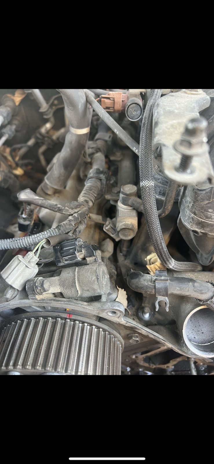

    IMG_6734.jpg I just finished replacing the starter on my tundra. Went well and truck starts right up. I notice this vacuum line I missed after buttoning everything up. It looks like it might run under the manifold? Any insight onto where this goes would be appreciated.

    Looks like the one that loops to the power steering pump?

    Hmmm… truck starts and drive without issue, not sure if a power steering line disconnected would cause issue?

    When you're parked and turn the wheel and the engine rpm's go down, completing that "circuit" is supposed to help with that.
    If it really is the hose I'm thinking of, anyway.

    It appears one end is hooked up properly to vacuum valve at the intake, correct ?
    If you take the inlet air tube off that goes to throttle body, you should be able to see if the lines to pwr steering pump are indeed hooked up. The chinese finger do hicky is to help with collapsing or for heat dissipation ??

    Yessir, that's the one I'm thinking of!

    Under the plenum

    Does anyone have a more specific answer where this goes. Just bought an 05 4.7 and I noticed this wasn't attached.

    He’s it does go underneath the intake manifold.

    Hope the pictures help. Mine is an 05 sequoia
