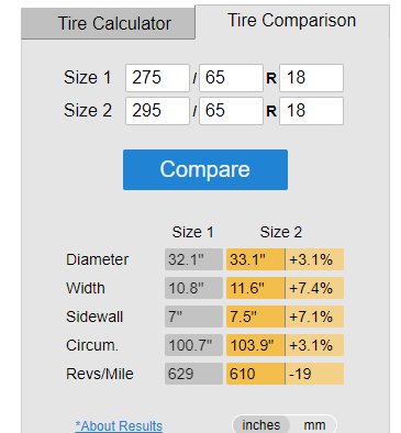

    so first off....the 275 to 295 means you're going wider. that first number is your width.
    secondly, if keeping the same aspect ratio of 65, then you're going to a 33, not 34 as stated above. if you want a 34, your aspect ratio would have to change to 70.
    so what's your final size you're running? are you wanting the same diameter but wider tire? if so, then 295/60R18 will be your closest bet to get more surface area, but same diameter (or close enough to it).
    check out to help you see the differences between tire sizes.
    i personally like the look more of a wider tire, but that does create more resistance on the road. it also allows more traction/surface area during off roading.
    so ultimately, i think knowing what your actual end goal for the truck/tire is will help determine what to go for.
  5. Jan 27, 2023 at 5:40 AM
    Fotnot
    Fotnot SSEM #69; LRCS#1
    Feb 28, 2019
    #26821
    6,279
    Andy
    SW Louisiana
    Swimmers gonna swim
  6. Jan 27, 2023 at 5:42 AM
    Tundra234
    Tundra234 New Member
    Nov 30, 2018
    #22402
    18,050
    George
    Florida
    2020 Tundra DC SR5 Barcelona
    Alot of them
    Good call....I was thinking the 295/70 that most go with.
