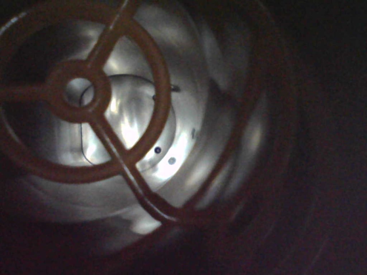

    Hi all,
    In Maine, we just went through some serious floods and power outages. I had to use a plastic gas can to put some gas in my 2018 Tundra SR 4.6L. When I finally got a chance to go to a gas station with power, the fuel nozzle clicked and did not allow me to fuel up normally.
    I never top-off my gas when fueling as I know it would damage the evap canister. Any thoughts on what happened? I looked at the filler neck and did not see any obvious problems. Here's a picture of my canister that I fear I may need to replace now.

    The rollover valve may have rolled over. Valve prevents gas from coming out but can also prevent gas from going in.
    Follow the filler neck down to the top of the fuel tank. Loosen the hose clamp and pop off the hose. There is a plastic siphon guard near the top of the tank and about 6” below that is the valve. Take something long and skinny (skinny enough to fit through the siphon guard) and roll the valve back over. You’ll know you’re successful when you can get past the valve. This can be done without lifting the truck or removing anything else.

    This is the rollover flapper valve in the tank. It’s probably stuck.
  19. Dec 31, 2023 at 5:57 PM
    42,477
    That's definitely the first thing to check. Great pic! This is why this site is #1

    Great pic of the anti siphon grid above the flapper valve as well.
    Now you know why it's difficult to siphon gas from a Toyota...you also know why gas theves just drill a hole in the tank as well.

    Does the valve get pushed straight down or does it hinge on one side?
  22. Jan 1, 2024 at 7:53 AM
    reywcms
    reywcms New Member
    Dec 20, 2021
    #72040
    7,060
    Rey
    North Plains,Oregon
    2017 Tundra Platnium
    Too many mods to come
    Hinges on one side

    I did! Sorry for the delay.
    Someone stuffed a paper towel down my filler neck! I did everything as suggested, and the problem still existed. I brought it to a local shop, and they removed the filler neck and yanked out a damn paper towel! I am researching a locking gas door now, as it costs me $116 to fix this problem. I don't think I have an enemies. I don't know...
