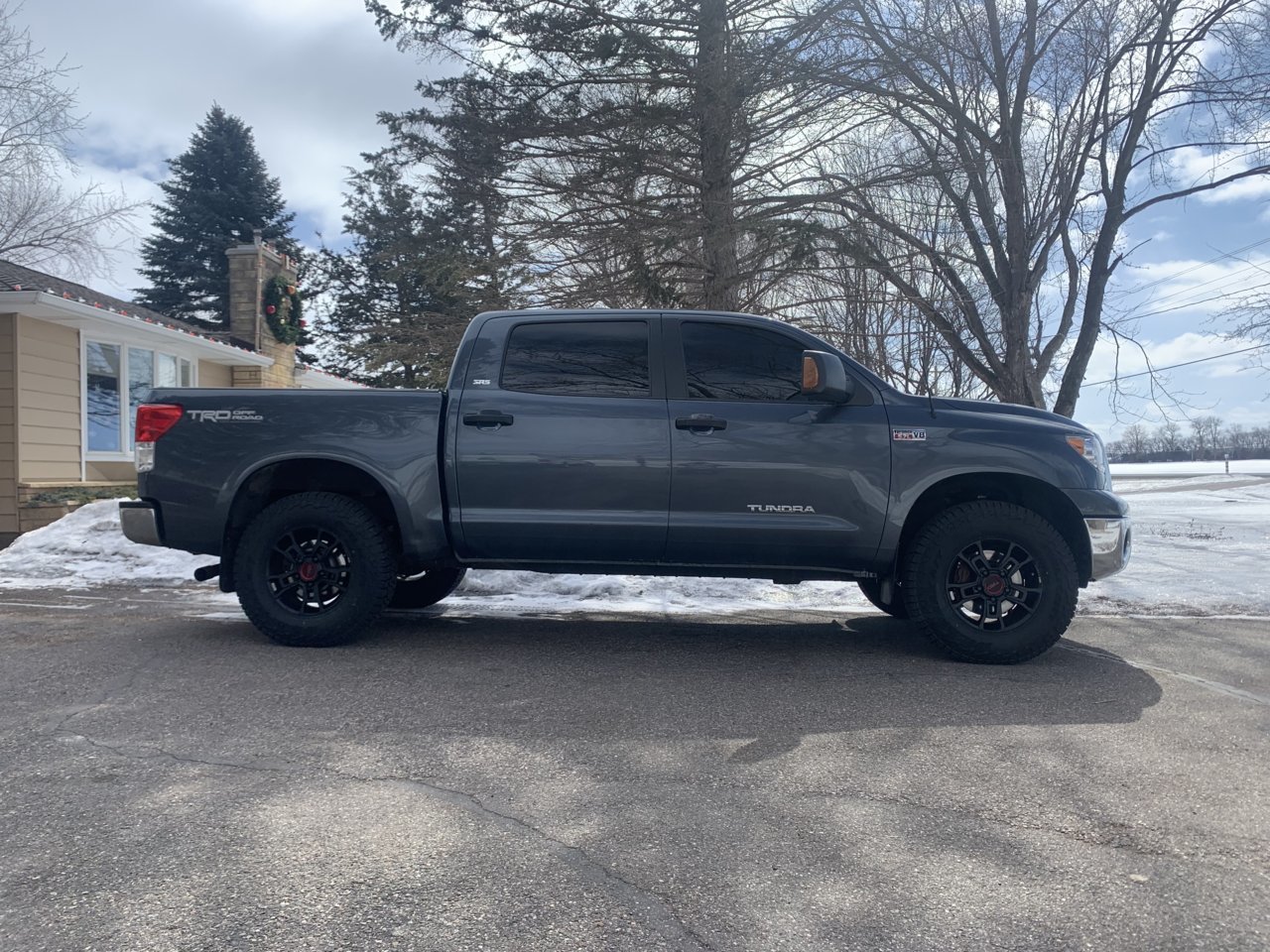

    I am wondering if a set of SPC upper control arms would be a worth while upgrade to my front end.
    I got the news that an alignment couldn’t be done because of siezed bushings, so that means I’m taking the front end back apart to replace the lower control arms. I figure while I am in there I am going to do the outter tier rod end - and potentially inners due to corrosion on threads, as well as upper control arms.
    I have an Eibach pro truck coilover installed and just from the naked eye it looks to be riding on the outer edges (positive camber) edge of the tires. Running 285/75r18. Will these UCA help with the alignment or just be expensive parts that make the alignment tech confused. Thanks
