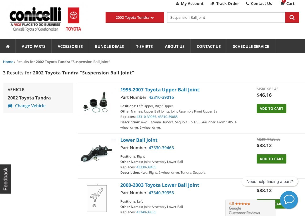

    Best bet is to internet search any Toyota Parts Programme. One of my close by local Stealers is a participant and actually allows free pick up which saves $. Some members have differing results with their Stealer only allowing delivery.
    In any case, you’ll figure it out. Usually shipping only adds a little when I search outside of my local with others. My local has great prices and you’ll find one. Start with Conicelli Toyota as they seem best if I was needing shipped.

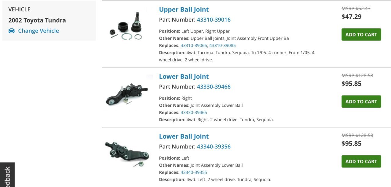

    My local dealer only SHIPS at program prices - no pickup allowed. After researching here, I got an OEM set for $85/ea shipped. At that price, it makes no sense to buy aftermarket - especially if you review some of the pics of the trucks that had catastrophic failures.

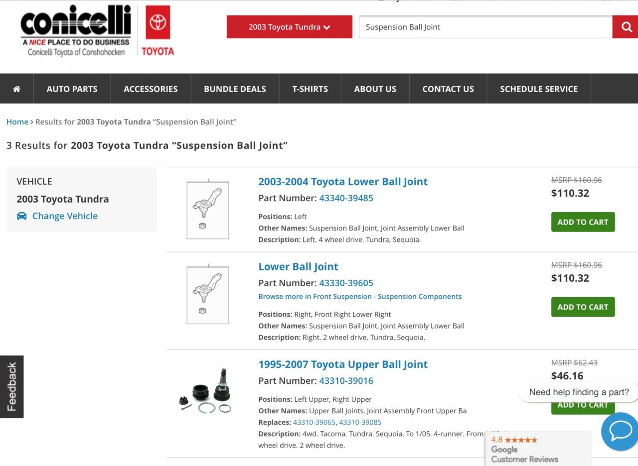

    PHM, you're doing a 2000-2003 seach and coming up at $88. I'm doing a 2003 search and coming in at $110 with a different PN....

    Still better than $200 each.
