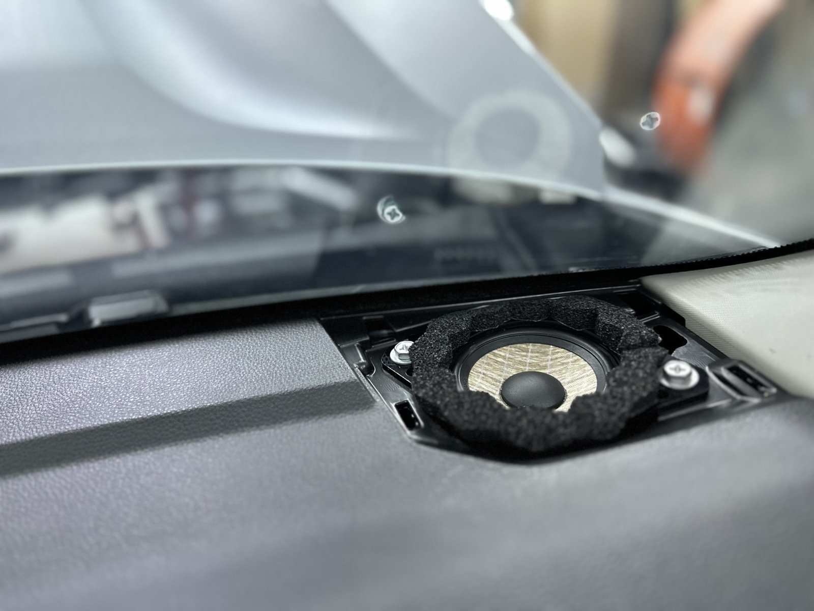

    2024 SR5 4x4 Tundra
    Just small trim removal tool and then pop up from the front. I believe was 10mm bolt there on each side.
    Attached is what they look like underneath with replacements.
    Tundrastruck91 and ryanwgregg like this.
