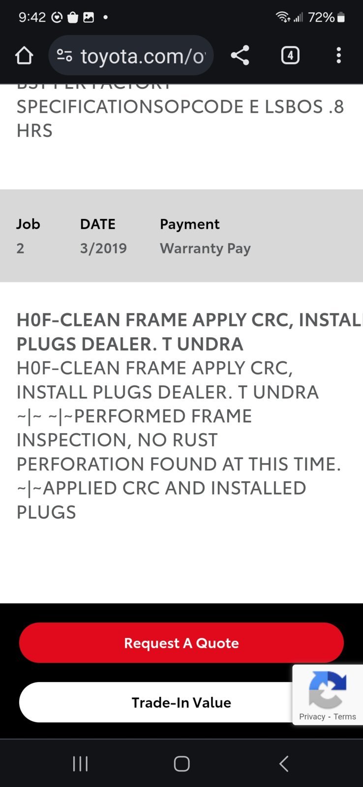

    I researched the truck I'm looking at and found this service record related to the frame. The frame was never replaced. However, can anyone tell me what CRC stands for?

    CRC (corrosion resistant coating?). They only applied that stuff to the trucks that had frames in decent shape- so, good news I guess.

    CHECK FRAME FOR RUST
    Many dealers used CRC to cover up rust to avoid replacing frames
