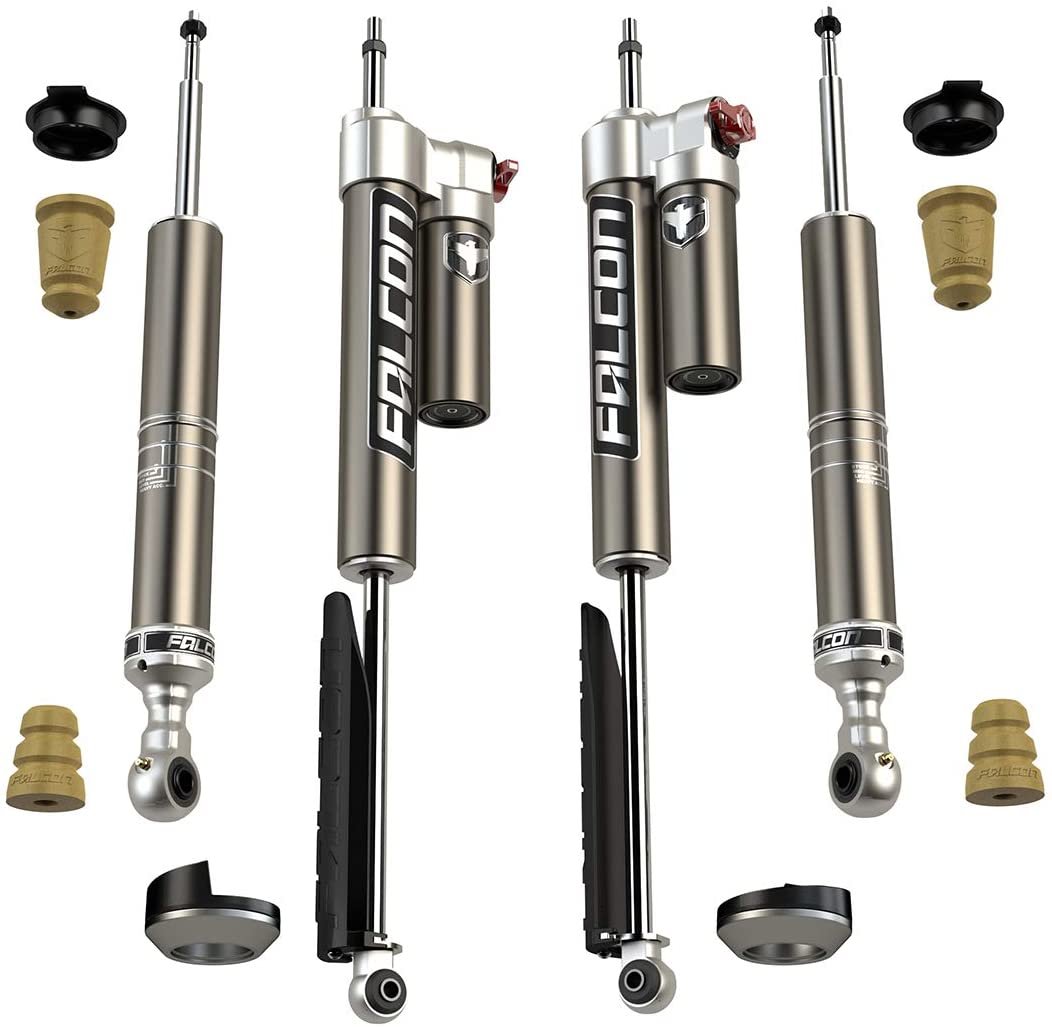

    If you want the pro ride quality with better reliability I'd go with a Teraflex Falcon kit. I've driven many TRD pros for work and I have yet to find anything that feels closer to the stock Pro suspension.
